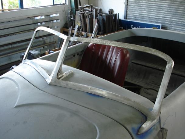

    Pretty much what I did on this handmade frame:
    Been in the car for two years now and driven all over South Africa, with no issues.

    This is the current state of the frame.

    The groove in my Hallock was milled by Mike Parti, he used a 3/8" keyway bit on a mill-
    He said he had to come at it from each end and meet in the middle, since one end is flat on the inside and the other end is flat on the outside. Sounded tricky-
    I've had mine since '93 and have always had 1/4" plex in it with butyl holding it in... Now that the car's getting redone I'm gonna get gl*** finally, and get it filed and polished and all that!

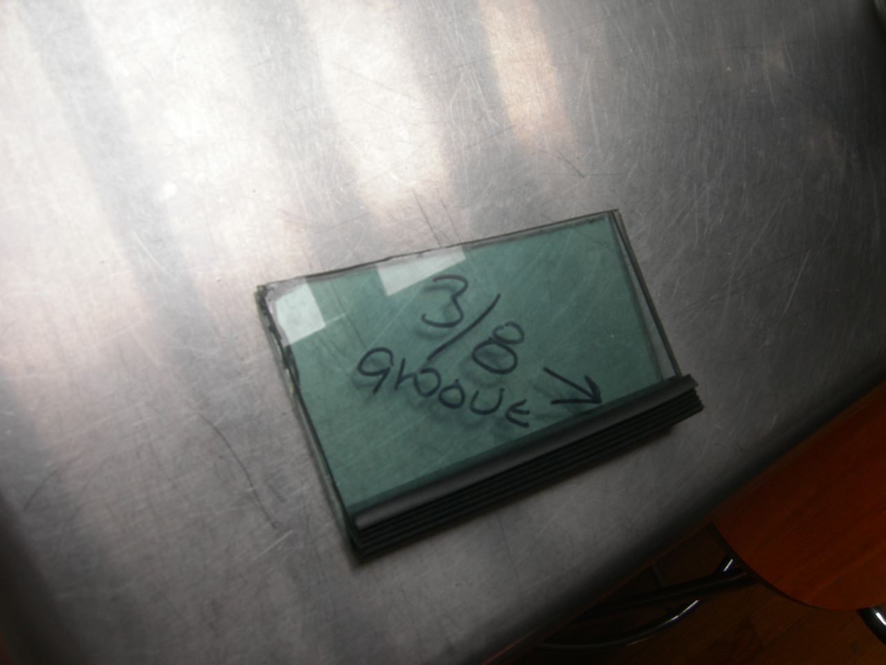

    If you use a liquid sealant the gl*** needs to be indexed in the slot or you risk cracking it either in service or installation and if it does break its a ***** getting out.
    Gl*** shops have rubber channel they use. My advise is to have a sample of gl*** and the rubber in hand before any milling is begun so you can do a sample and dry fit. My rubber has serration's that will keep it in the groove and shoulders that make a sano job. Camera refused to take a close up.
