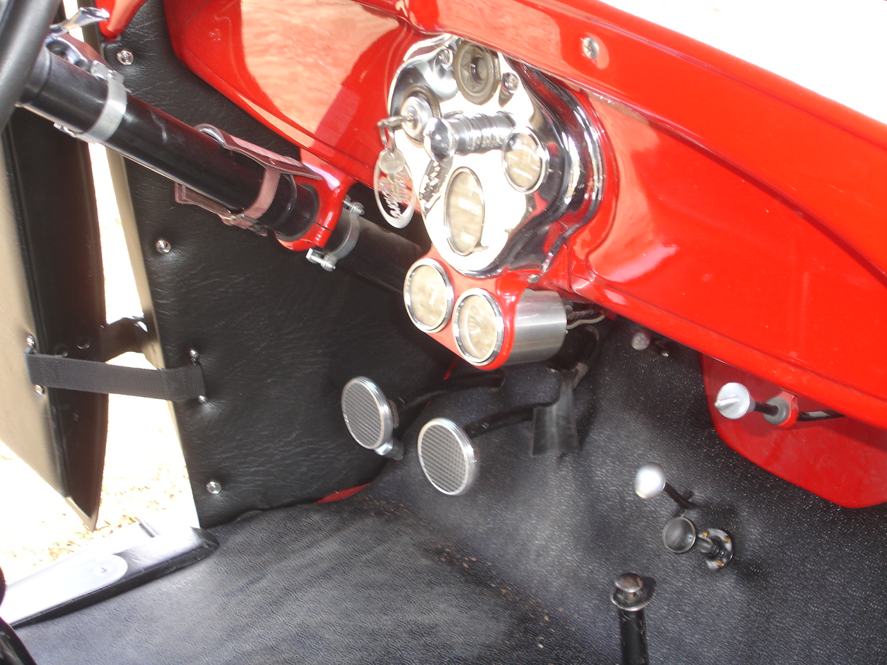

    I use a fairly stock looking "A" dash in my 28A hotrod..
    To get the room I needed,for a number of things,I gutted the inside of gas tank.
    Also gutted out the back behind center "A"dash.

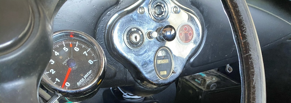

  12. I'm going with a keyed on/off switch with a start button either on the dash or on the dash/vent panel.
    Here's my friends '30:
