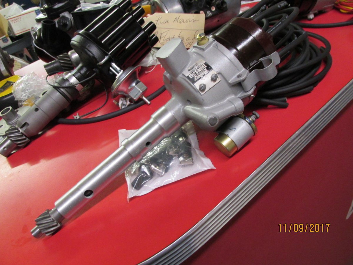

    It will ship ups tomorrow ( too late today). Even at five months aint it pretty ??I threw in a wire set of solid core and some rajah wire ends for your trouble....Need anything else ???? IMG_2300.JPG IMG_2301.JPG

    Yes, looks great, I’m glad to see it. Thank you for your hard work and expertise! I guess it has the points set, ready to drop-in? I don’t know much about this stuff.

    Just install it , wire up the correct firing order and run it like it is. Everything is set and adjusted ready to go. You will need a coil and install a couple set screws in your front cover......let me know if ya need some help there as well...

    Okay, I’m ready to install the Chevy Mallory in my 8ba flathead Ford. I think I realize now what you meant by set screws. Suppose I should go buy two, self- tapping, #10 machine screws and a drill bit. Any tips on this? I guess it’s self explanatory. Just put a paper towel in the hole for shavings. Not sure if there’s anything special about where I place the holes.

    Typically we use two 8/32 allen head bolts with a lock nut. Stick a rag in cover ( ***uming its on the engine) and **** shavings out with shop vac. The cover has a thick spot on it and drill the holes there. (One would more than likely work very well. The distributor has no torque on it as it drives nothing like a oil pump etc).
