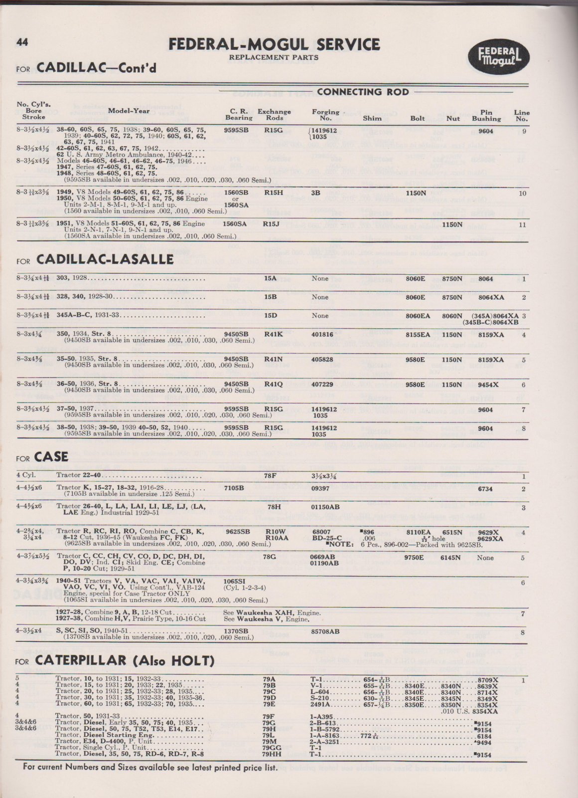

    I found a guy that has thousands of NOS federal-mogul rod and main bearings and no book. I need the part numbers for 1950 331 Cadillac rods and main bearings to see if he has them. Thanks
  2. Rods are 1560 SA
    Algoma56 and Deuces like this.

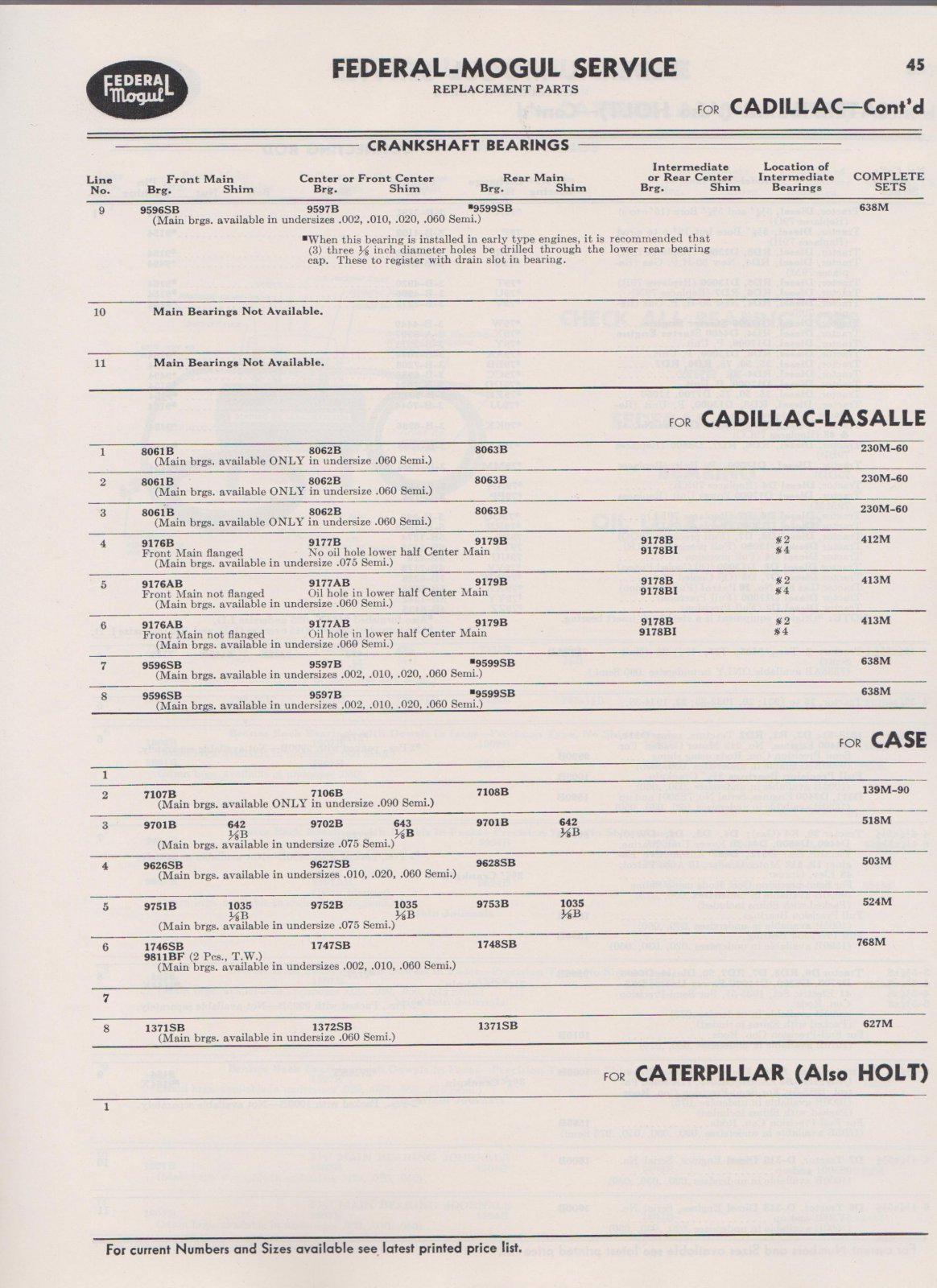

    Thanks, anyone know the main bearing set number?

    Could not find any reference for cam bearings.
  7. Mike Paul
    Joined: Oct 10, 2003
    Posts: 1,033
    Mike Paul
    Thank you, not sure how to read the crank bearing portion as it lists no cubic inches by the part number. Is it the 638m set or is it not available?

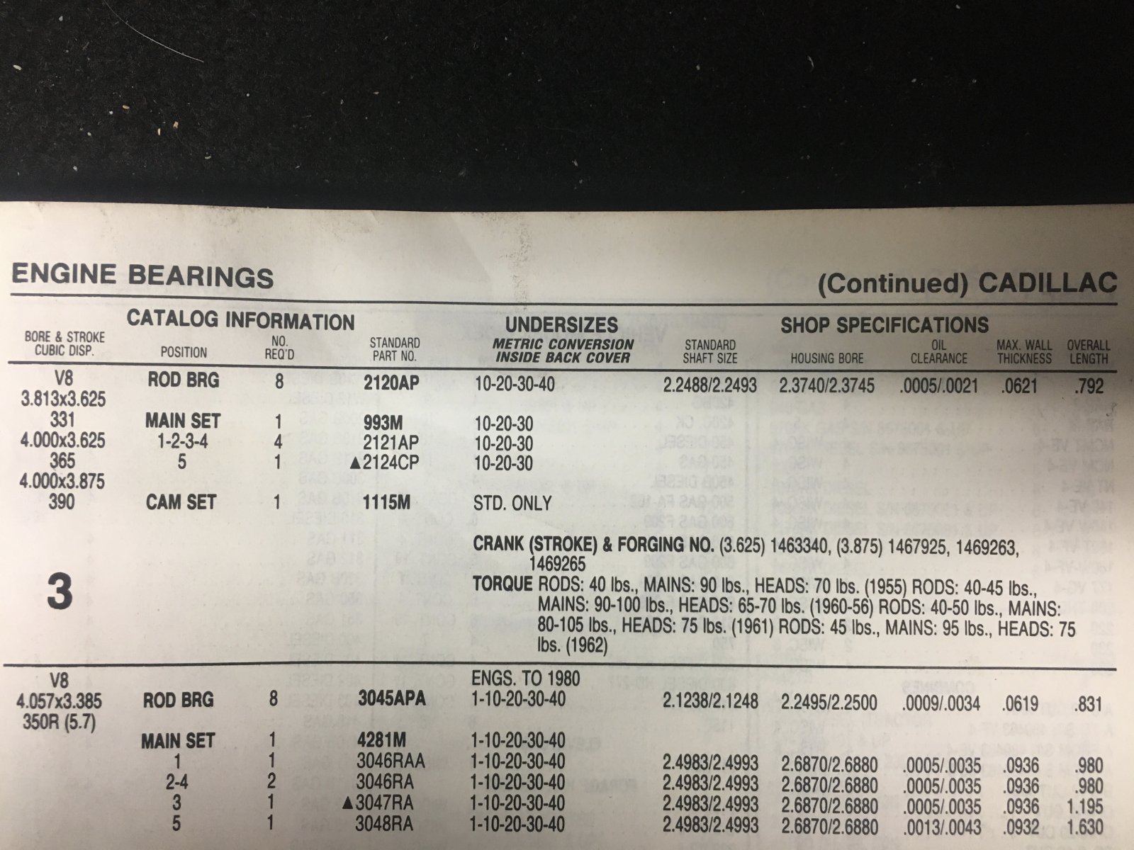

  8. SEAAIRE354
    Joined: Sep 7, 2015
    Posts: 552
    SEAAIRE354
    This is from my book. It listed the 331 from 1955. Not sure if it’s the same family as the 1950. I’m not a Caddy expert. Hope this helps.
    Algoma56 likes this.

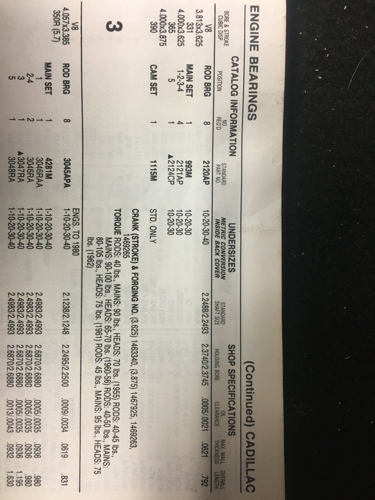

  9. SEAAIRE354
    Joined: Sep 7, 2015
    Posts: 552
    SEAAIRE354
    Sorry I thought the pick was turned correctly.
  10. Mike Paul
    Posts: 1,033
    Mike Paul
    Thanks, I know 49-54 is the same but I think it is just because of the block. Not sure on the 55
