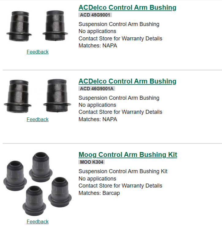

    Thank you for the links, I only need the 2 rear arm bushings that go to the differential.

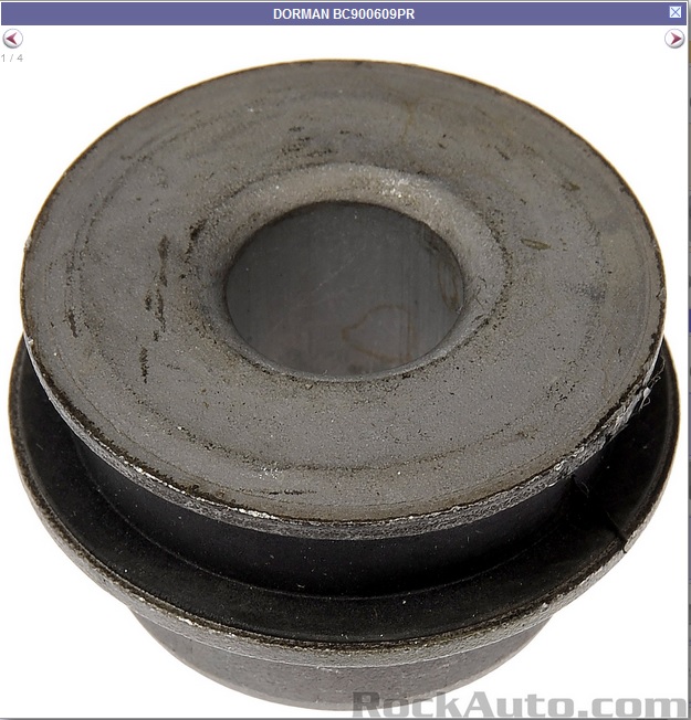

    also you could look for the bushing for a Corvette, at cheap places where they sell new repops for five bucks a piece

    Wasn’t 58 a one year only on that bushing that goes to the rear?

    yeah, that was the only year that had the Y shaped upper arm.
    Also if you drive it for a while with a shot bushing, it will eat up the hole in the rear end housing, and then you get to fix/replace that also. btdt
