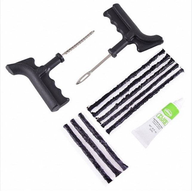

    I have never used those threaded plugs, I ***ume there is an actual metal screw in there?
    I have used the kits that come with a rubberized string (?) and glue. these are not temporary. I keep a set in my glove box but have never had to use one on the road. did the repair at home
    plug it, air it up and drive it.

    If you get the T handle style best to
    get/ use the Commercial Round metal T handle ,The None Commercial plastic one's most time snap off in your hand.
