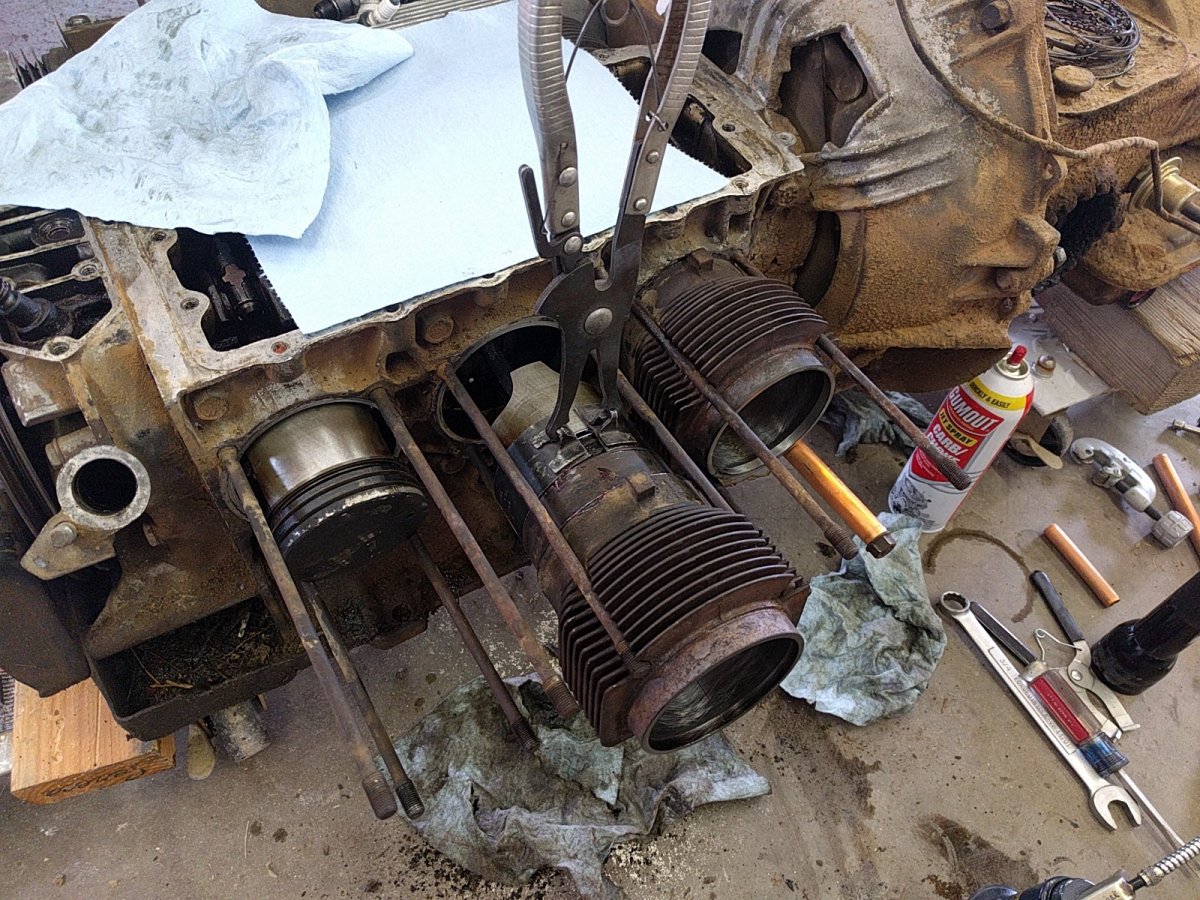

    I decided to pull the powertrain out and work on the engine that way...didn't take long to drop it out. I pulled off one head, and ended up taking all the cylinders off that side, honing them, installing NORS rings that I got cheap on ebay. I'm reusing the gaskets, because I'm cheap and lazy, and it's not likely to leak any antifreeze. There was a broken ring on the hole that had kind of low compression, and some pitting in the hole that liked to oil foul the plug, and stuck oil rings, and some wear on the rings, etc. We'll see how it does with my quickie $20 ring job. I'm half way done now, ready to tackle the other side.

    What's so top secret in the crank case that you don't want us to see ? Or is it just to toy with us ?
  26. squirrel
    Joined: Sep 23, 2004
    Posts: 59,929
    squirrel
    or to keep stuff from falling in
    saltflats likes this.
  27. Johnny Gee
    Joined: Dec 3, 2009
    Posts: 14,353
    Johnny Gee
    from Downey, Ca
    I'm more **** about that. There wouldn't be any openings. Now you know how the question came about.
  28. squirrel
    Posts: 59,929
    squirrel
    hey, it's just an old corvair engine.
    And I found an even worse cylinder on the other side....lotsa rusty pits, probably gonna pump a bunch of oil still, unless I find another one.
