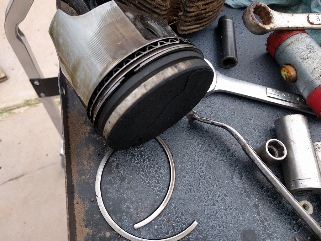

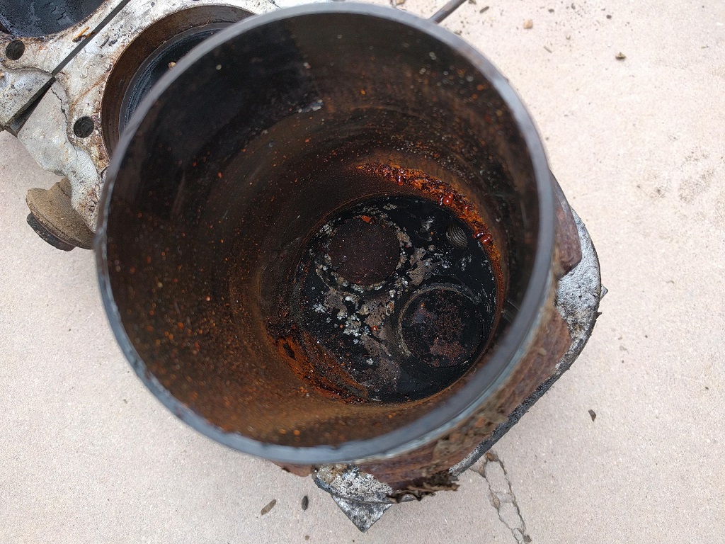

    back to the old Corvair...at the end of the LeMons Rally last year, my brother bought the car from me. He got the seats redone, and did a good brake job, fixed the fuel gauge, and a bunch of other stuff, and has been driving it. Then, when we were working on his LaSalle hearse earlier this year, the Corvair started making a funny noise, and it was getting louder, so he decided to leave it at my place. I pulled a valve cover on the noisy side, and found a loose valve stem. uh oh.
    Fast forward to a month ago, he told me he got a free 1964 engine. And that he'd try to get around to taking it apart to see how it looked. Fast forward again to yesterday, I had some free time, so I visited him and we played with the LaSalle a bit, and then loaded up the engine for me to take home and work on.
    Today I took it apart, and found it was not too bad, but after doing a little research and measuring, it turns out it's mostly a 1963 engine, so the parts will mostly interchange with the one in the car. One of the heads is from 1963, the other from 1964, neither of them matches the V code on the block, which is for a Corvan. The crank looks decent, and I think we can build one good engine from the two, without spending more than about 500 bucks. We'll see how it goes.
    I never took one of these apart all the way, it's pretty interesting. There was some rust in one hole, not too bad. Someone had done some buchery on one side of the engine though, used oil ring rails for the second compression ring, and busted the bottoms of two of the jugs.
