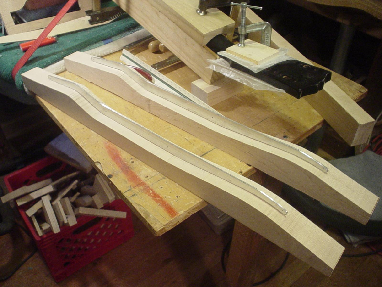

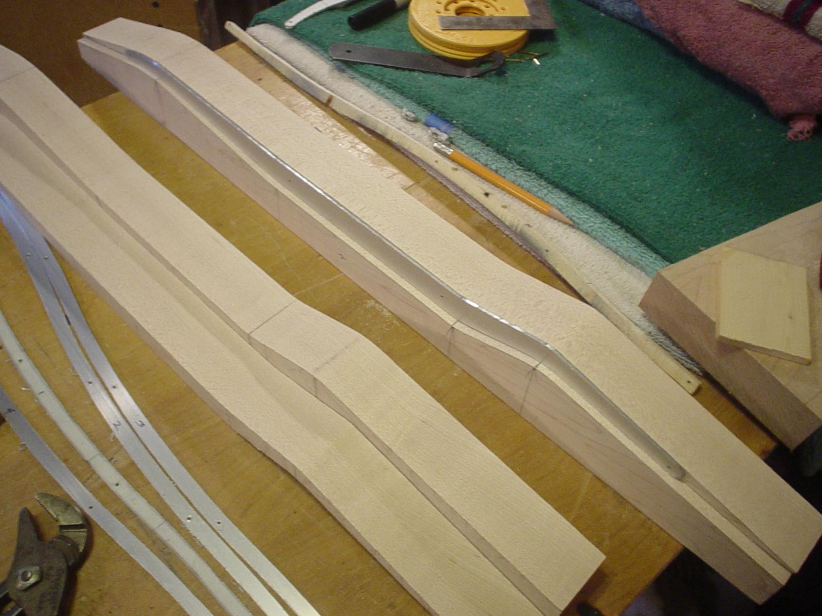

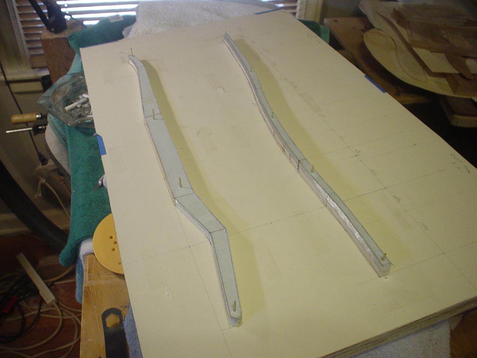

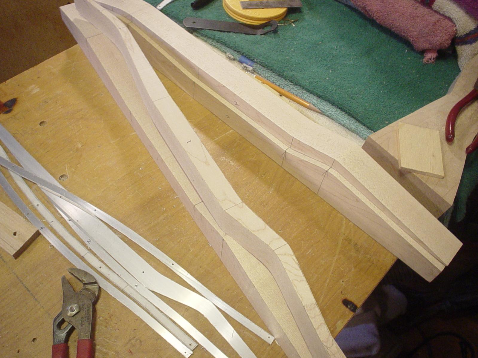

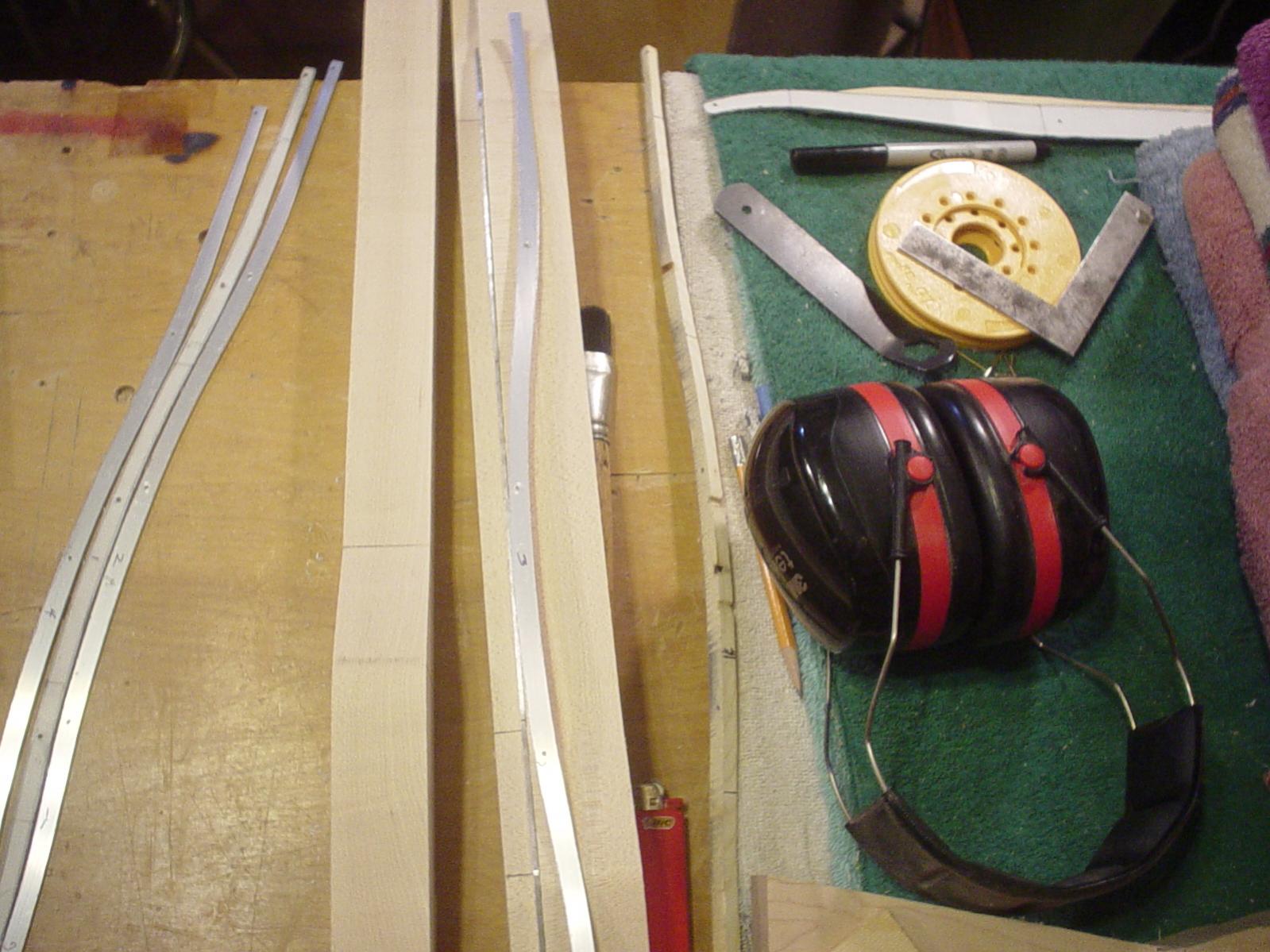

    I final shaped the parts to the layout lines on the spindle sander, using 50 grit sanding tubes.
    Since the footprint bases are small, I used a strip of wood to help ***ure that the stacks were being held vertical during the shaping.
    The original layout lines for axle centerlined & frame kick up points are still in place on the overlay.
    I transferred them down the sides of the stack for reference when fitting to the frame ***embly jigs.

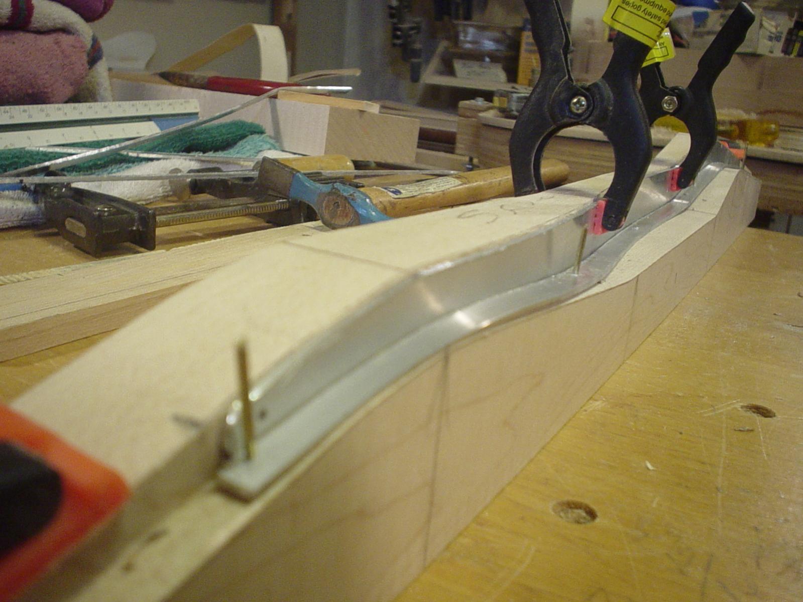

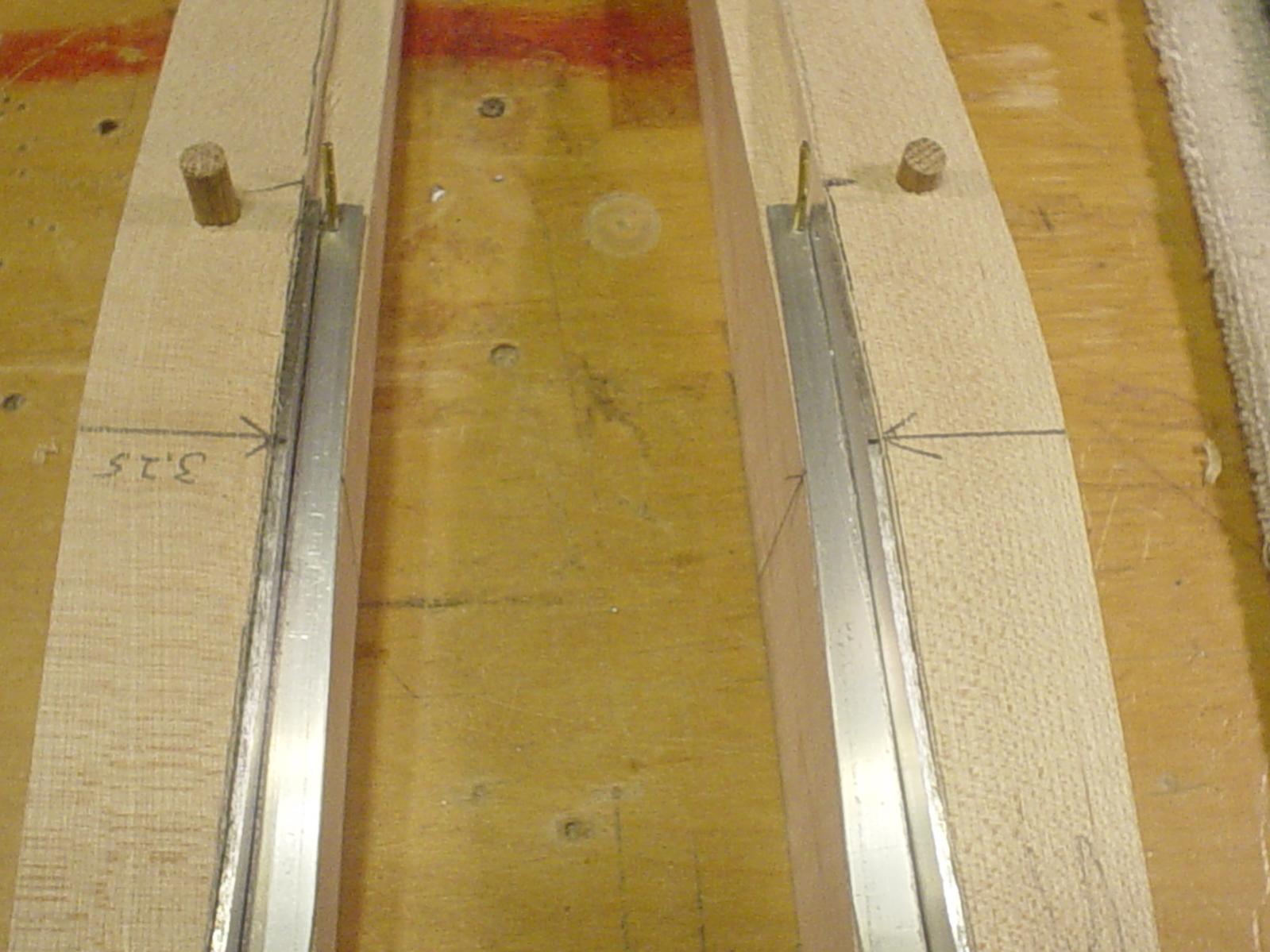

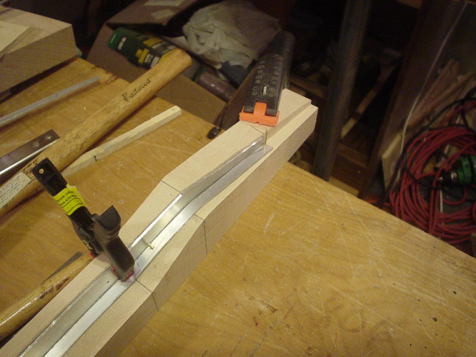

    The begining of the ***embly jig.
    Working in hard maple...I've got a bit of it laying around.
    Top portion of the jig will s**** on to the top of the base & will define & establish the curvature of the rails when viewed from above.
    In it's final configuration the fixture will have a centerline, with outside widths across the frame established to specs.
    This will allow me to square the frame & hold it while crossmenbers are fitted & built.

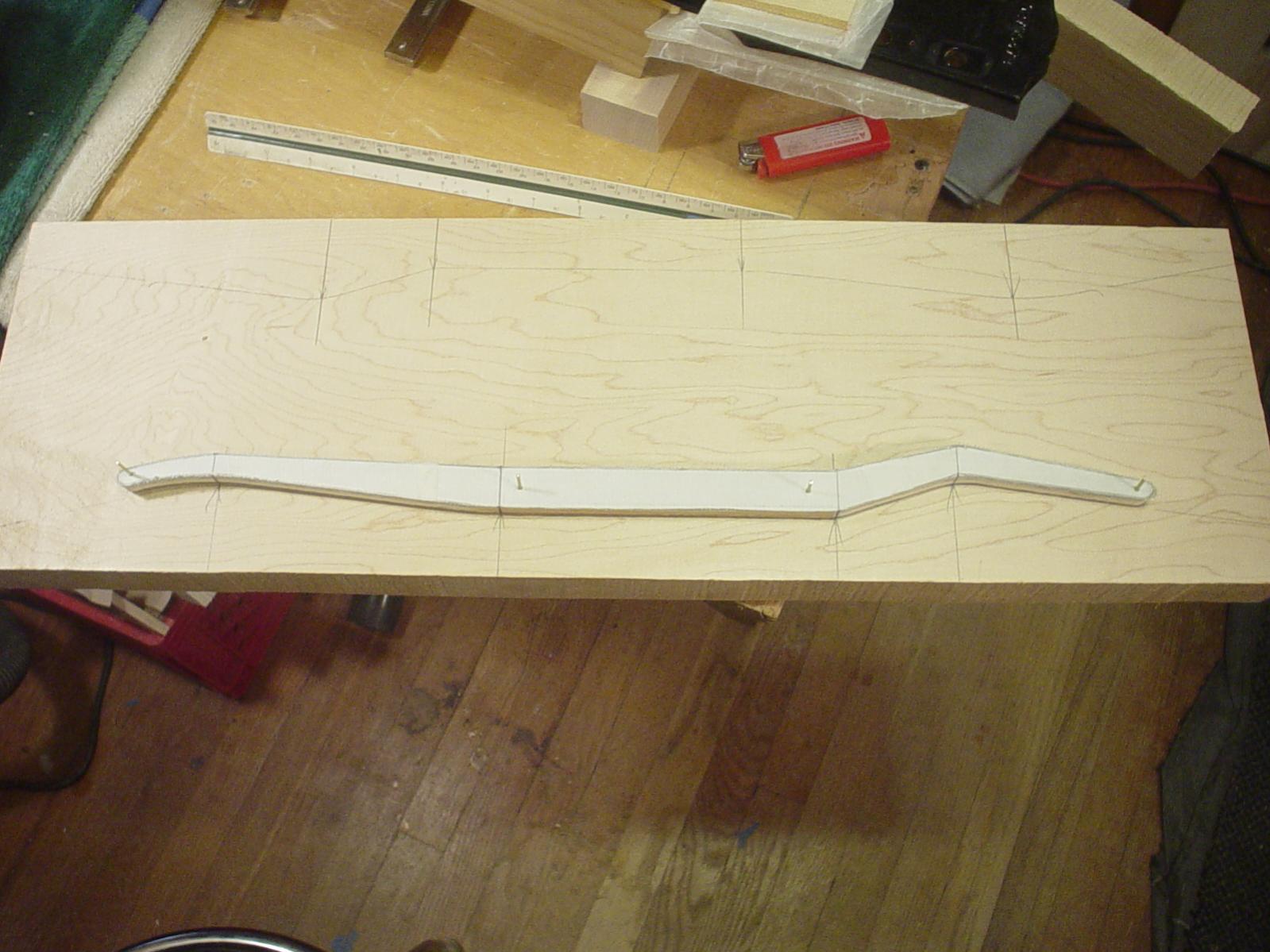

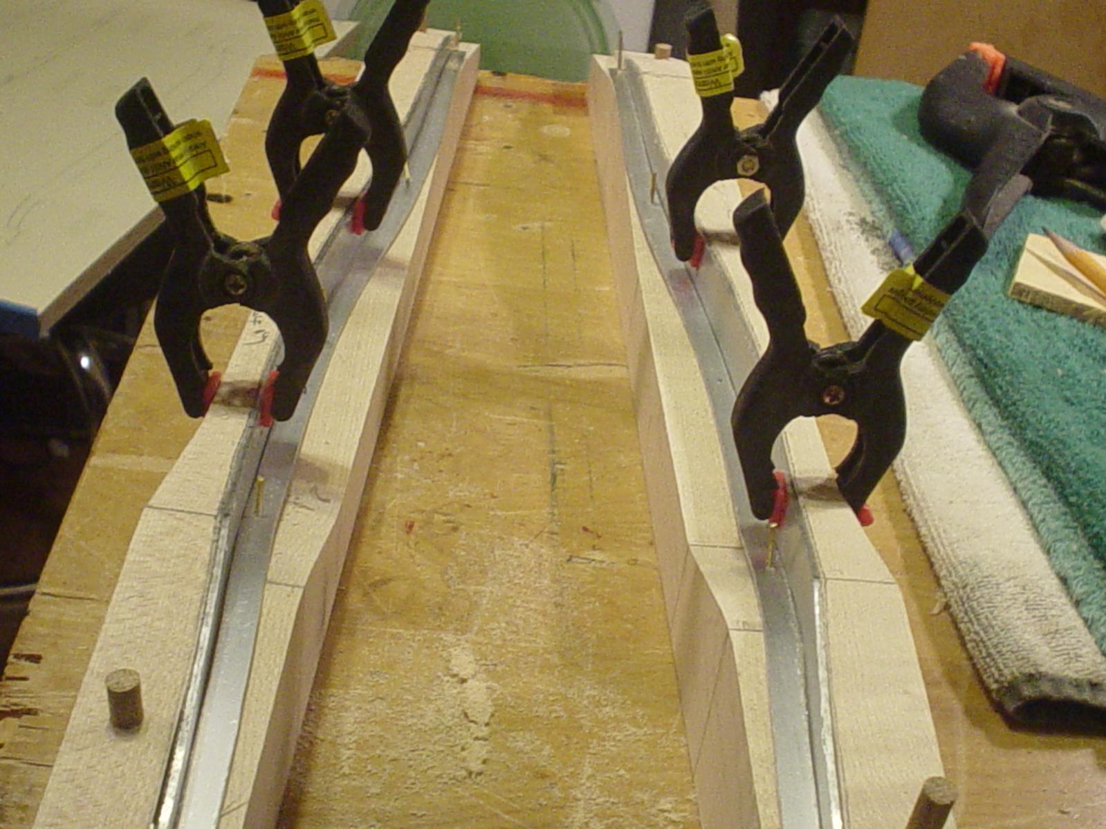

    The top sections of the frame ***embly jig are partially done.
    they will hold the side rails securely while the bottom & top edges are soldered in place.
    Next step is to lay out, draw & cut the profile for the top/bottom edges.
    Deuces likes this.

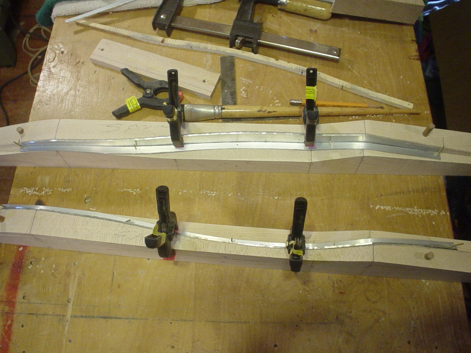

    Spaced roughly to scale for width.
    A few more pins to hold a couple of spots more precisely.
    Starting to look like a frame.

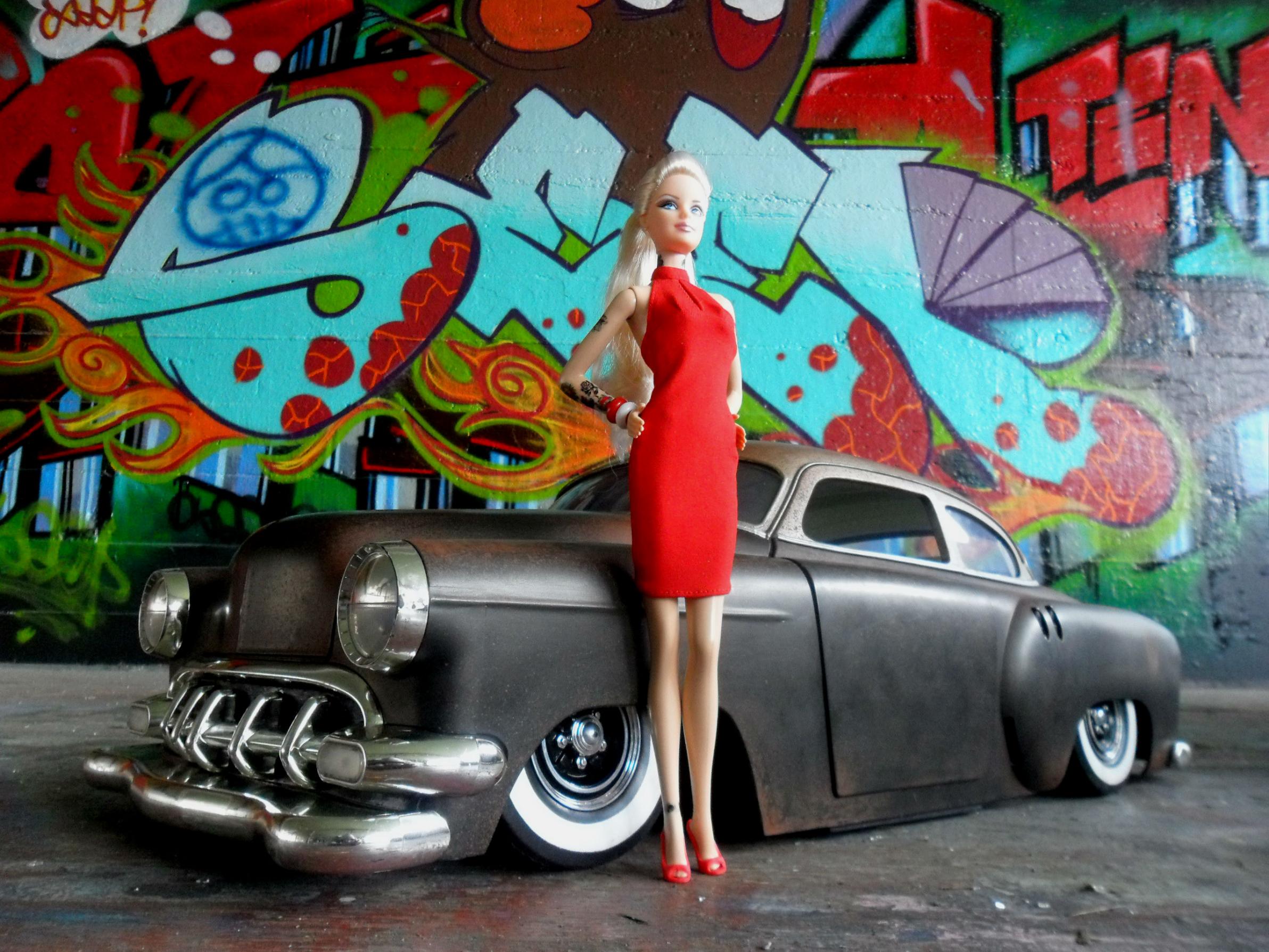

    Figured I haven't posted anything in awhile. So here is a picture of one of my 1/6 Chevy's. With a custom pinup.
