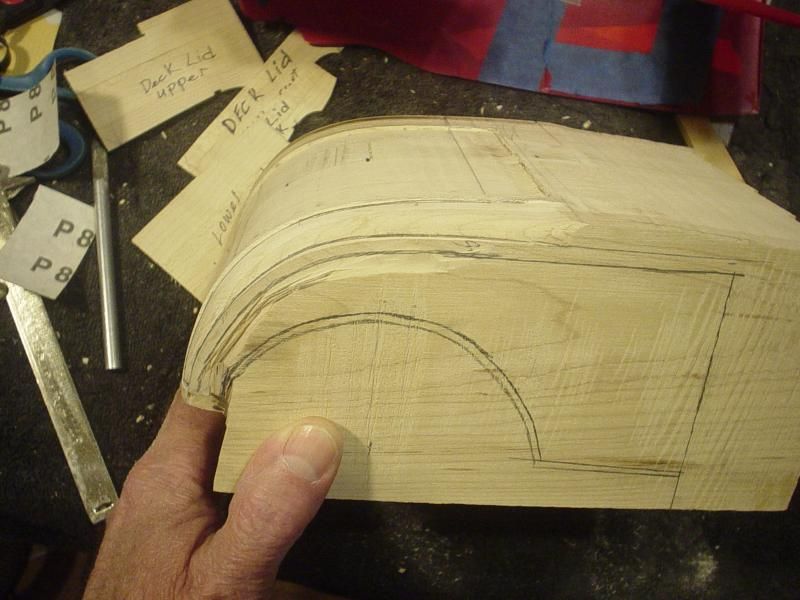

    Carving a buck out of hard maple for hammer forming metal body panels for my 1:8 deuce project.

    Using a Revell big deuce kit as patterns to build in aluminum.
    pulling templates from the kit body to verify my work on the buck.
    It's been slow going.

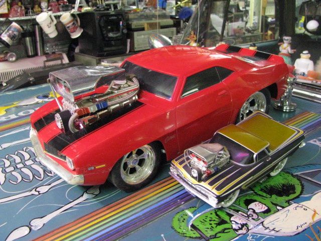

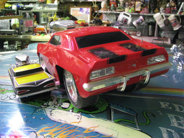

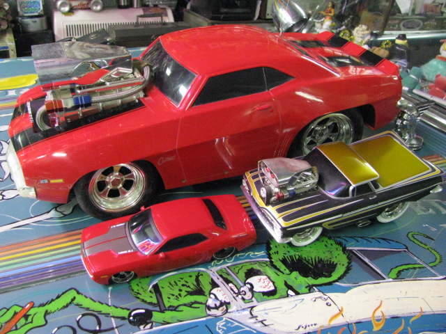

  17. LargeScaleMuscleMachine 001.jpg LargeScaleMuscleMachine 002.jpg LargeScaleMuscleMachine 003.jpg
    Picked this up at a yard sale awhile ago for $2.It's an R/C muscle Machine in about 1/8th scale.No radio with it but I just wanted it for display. Can't seem to find out any info on when they were built or if there were different models. Any one have any info?

  19. From what I remember, they were available in the early 2000's (snd maybe as early as the late 90's). As far as I know, the Camaro was the only 1/8 scale r/c car, but the same Camaro, a Mustang, and a Charger were all available in 1/12 scale.

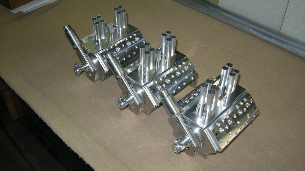

    Here are 3 Hilborn injected Flatheads in 1/4 scale, one for my desk and the other 2 are for 2 ' Gentlemans runabouts' in mahogany
    All parts machined out of 6061 alum billet, and the joints & cracks will be dip brazed together to look like castings when done DSCN0688_201.JPG
