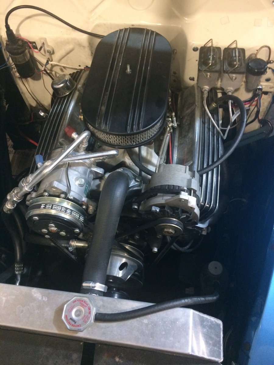

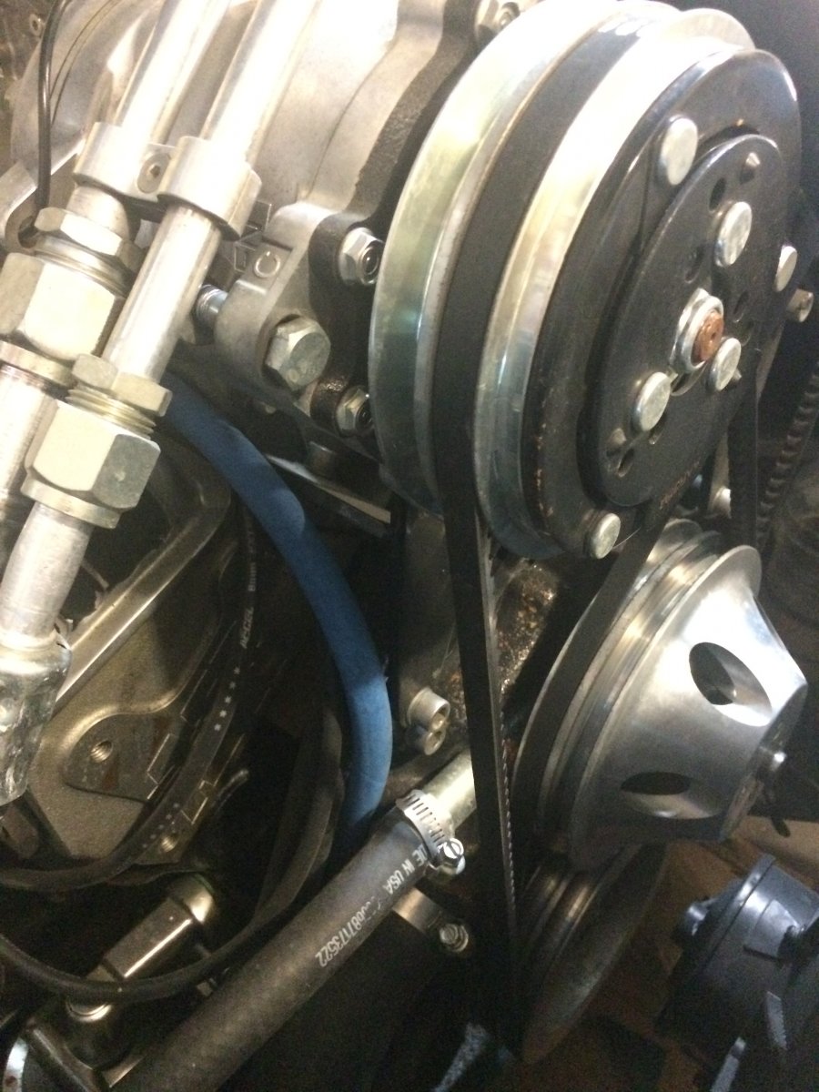

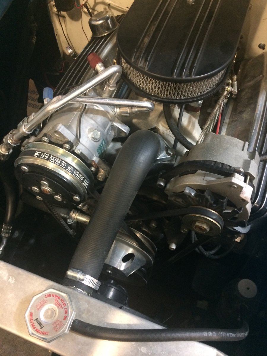

  19. Russco
    Joined: Nov 27, 2005
    Posts: 4,397
    Russco
    from Central IL
    81A2B40E-99F3-48B2-822E-9FC91474B8D0.jpeg CED05D81-0F0E-4455-9061-4D48718CDBCA.jpeg 21179EC2-AF07-479D-8769-061E1C4D5453.jpeg F078CE88-D56E-41D3-92C3-8F1542A2BFC0.jpeg
    I did a bunch of checking around and went with Bill’s set up on my 40. I can easily take the valve covers off and the alt and compressor are not hanging way out the side. For my application this was the best option yours may be different.
    OFT, gsnort and rfraze like this.
