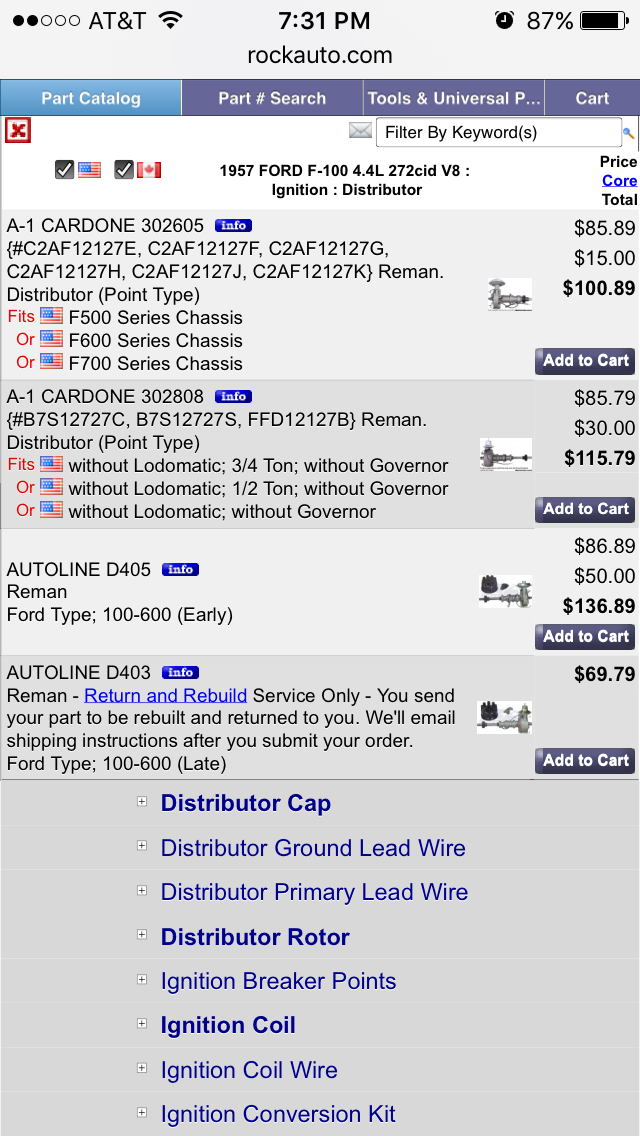

    I'm still unclear with this 57 y distributor. I can get one off rockauto but I'll have to know which one to get... There are still seemingly early and late model distributors.... I'm sorry if I'm being really dense but I want to make sure I don't kcuf if up, and order the wrong stuff from 53 different places... here is a screen shot that shows the early and late deal.

    30-2808 is the magic number for a post 56 Y block distributor. It will have both mechanical and vacuum advance.

    Truck64 you're a rockstar. I literally just ordered that part number from joblot going to pick it up from them Monday since I live 15 minutes away! Now I just gotta place the order for the pertronix kit which I ***ume is for a 57 y block... You guys on this forum are so damn helpful I'll tell you! I've tried on a few other forums for help and get nothing! Thank you so much!

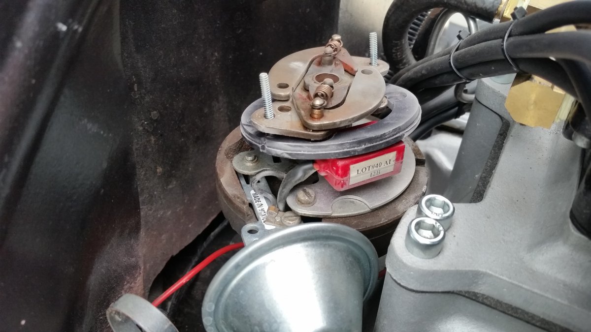

    Yes, that appears to be one of our Ignitor II units. You should be using a .6Ω coil. like our Flame Thrower II without a ballast resistor for best results.
    This is the replacement module by its self (without the magnet ring) http://www.summitracing.com/parts/pnx-911810

    Timely discussion. I've been having low speed drive-ability issues with my Avatar that has a 69 327 with a Pertronics Flame Thrower II distributor and coil. It was getting progressively worse. I was blaming fuel because it sat for 6 months while we were in AZ for the Winter even though I treated it with Stabil and ran it for about 20 minutes before storing it.. It would smooth out above 2k RPM so was ***uming problems in the idle circuit. Was planning to remove center carb and rebuild. Today backed out of the shop and had to use throttle to keep it running. It died at the end of the driveway and would not restart. Had fuel but no spark from coil wire. Coil and coil wire resistance checks good. Good power. Monitored ground side of coil to ground while cranking and saw no change in voltage. Not sure I would see the switching action on a DVM but it was the only way I could come up with to try to isolate the module without removing the distributor. The cap and rotor are new. The system is probably at least 5 years old with no previous problems on two different engines..I always ***umed a module failure would be immediate and not gradual because that's the way electronic devices tend to work. Anyone have a way to verify the module is working without removing the distributor?

    Continuing my saga of trying to figure out what's going on with my Flame Thrower II system in my Avatar. Pulled the distributor and got a new module. Tested it with a DVM before putting back in car and it looked just like original one, no voltage change. Thought maybe the best way to check it was with a good ****og meter. When I used one, both modules showed voltage flux when the distributor was turned so ***umed the module was not bad. Began focusing on the coil. Disconnected everything and hot wired coil plus to bat terminal on alternator and negative to a wire unconnected on the other end. Connected a spark plug to the coil lead and grounded plug. When I touched ground with the neg wire got a very weak spark on the plug. Ordered a coil. The coil had checked good resistance wise but an ohmmeter will not necessarily show shorted windings. Need an inductance meter. I should have done a better job of eliminating the coil to began with but when I didn't see any module action with the DVM when the engine was motored I ***umed module. Talking with Pertronix today, I was told there is no definitive way of checking an Ignitor II module other than verifying power and ground. I'm wondering if he was thinking Igniter III.
