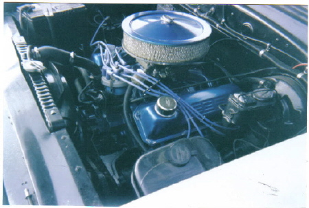

    I have a 351M in my '57 Ranch Wagon. It's big, heavy, ugly, slow and it runs kinda hot, but at least it gets terrible gas milage ;). The thing is very reliable though, and like most mediocre (sp) '70s American V8s, it probably will never die.
    As said before, there are a few aftermarket manifolds avaiable for them and Cleveland heads and dress up goodies (I have Cleveland finned valve covers on mine) will bolt on to them. Even so, I still wouldn't bother trying to "punch up" one of these motors.
