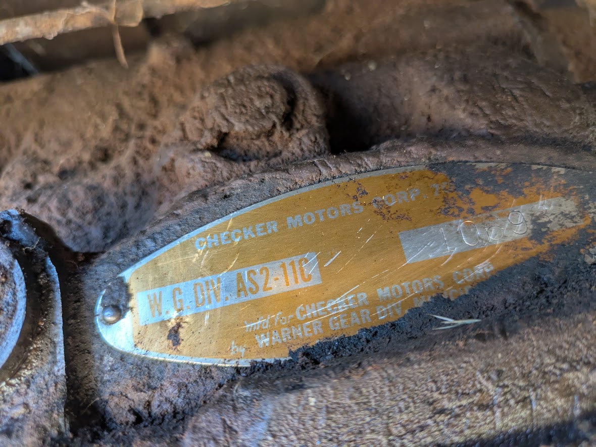

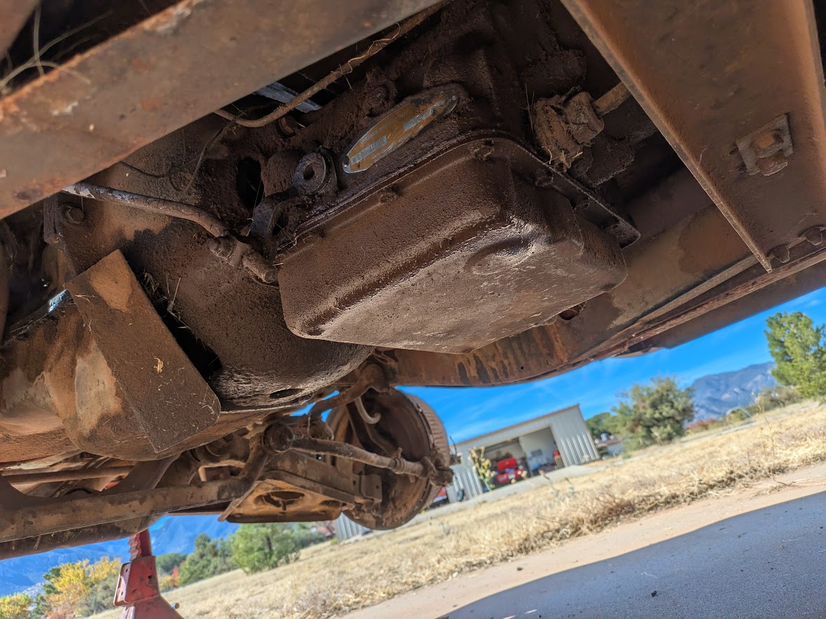

    Since I got one of those Checkers that has an FMX-like transmission bolted to a Chevy engine, I'm doing some research on the subject. Of course, it ends up being really complicated, and not much info out there is "right".
    What I'm finding is that Ford, Studebaker, and Borg Warner got together in the late 40s/early 50s, and developed a couple different, but similar transmissions. Ford ended up with the small, medium, and large case Cruis-O-Matic. AMC and Studebaker (and several other companies) ended up with the Borg Warner model 8 (and a few others, such as the 10, 11, 12, etc). Then around 1967, Ford refined the design, changed the bell and tail to aluminum, and named it the FMX. BW continued to make the transmissions for a few small applications, including the Checker, AMC, and some Jaguars. The transmissions are all similar in function, and appearance. Some of the parts interchange. But there's hardly any info at all on the BW Model 11 that I have in the Checker. And lots of guys call it an FMX, which is not...there are no Ford parts in it, it's pure Borg Warner. It says so right on the tag.

    The AMC guys use FMX rebuild parts iirc. Very close to the same thing. I had a ‘65 Rambler with a BW automatic. Worked fine

    Studebaker guys also use FMX rebuild parts. Since most Borg-Warner automatics in Studebakers start in second gear, it's a good mod to use the FMX internals to get a first gear start.
