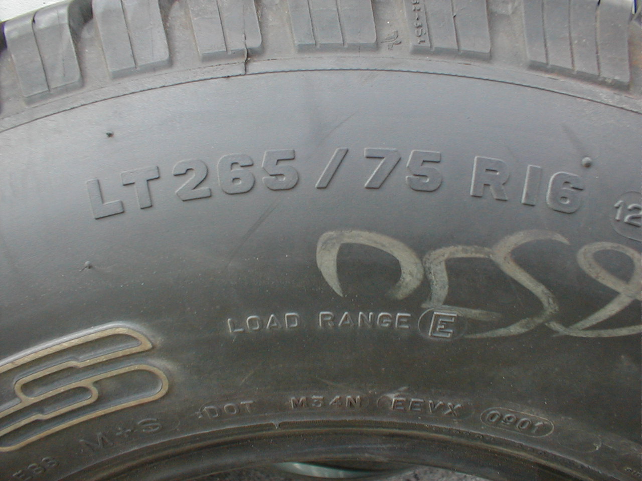

    Always go with ply ratings. Especially in that range of weight.

    Also be aware of load range ratings. I would use a Load Range "E" for that weight. I don't think you can find a ST tire that isn't made in China.

    i would go with load range E for shure.

    Just make sure that the tire has a decent margin above the max load number. For 10k, and depending on your tounge load, each tire should be in the 2800-3200 lb max load range.

    you can do a lower profile tire , Like others have stated keep the load range to E or higher , A guy on know just bought 16 ply rated tires for his bar-b-que trailer due to 10 ply tires blowing out . I had never even seen them in 16 inch. also avoid bearing buddies they do not pack wheel bearings and give false comfort you will burn a bearing at some point .

    I'm surprised that alot of you recommend a E load rating so I'll consider that.
    For what it's worth my trailer originaly came with D rated 8 ply tires and even though my trailer is 10k lb rated the most I ever will haul is about 7,500 lbs(including trailer and contents). The trailer is really over kill for what I need but it was a good deal and the bigger brakes are nice so I bought it.
    Now, do you all still recommend I get E tires or are D rated still good enough?
    It sounds like LT tires will be okay as long as they are rated high enough and yes I'll be getting a domestic brand but not the Goodyear Marathon because I've heard nothing but bad things about them. I have nothing against off shore tires, I just like to support our economy where I can.
    So lower profile tires are okay as long as the load rating is adequate?
