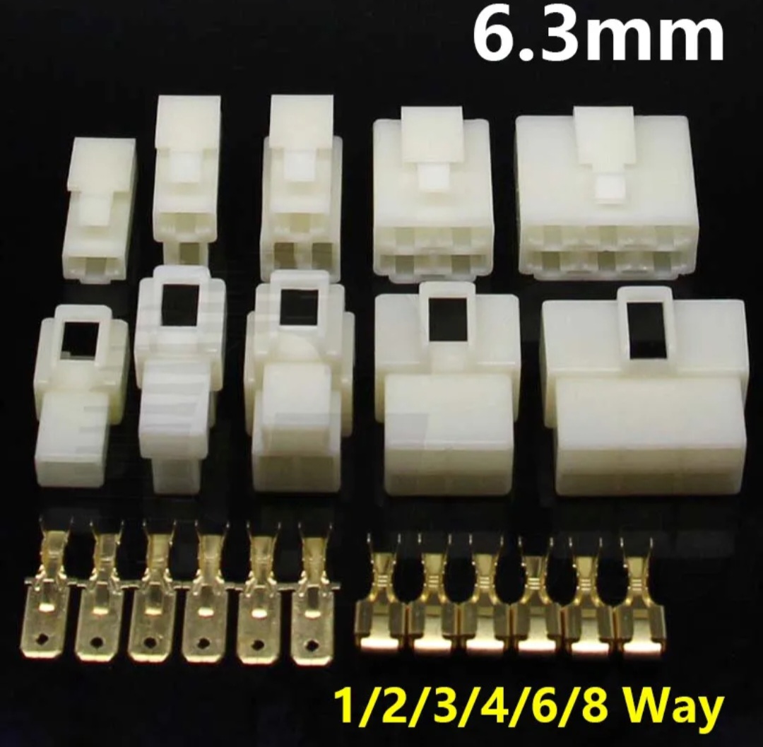

  26. i.rant
    Joined: Nov 23, 2009
    Posts: 4,775
    i.rant
    Those white plastic connectors belong on your washing machine, not your car.
