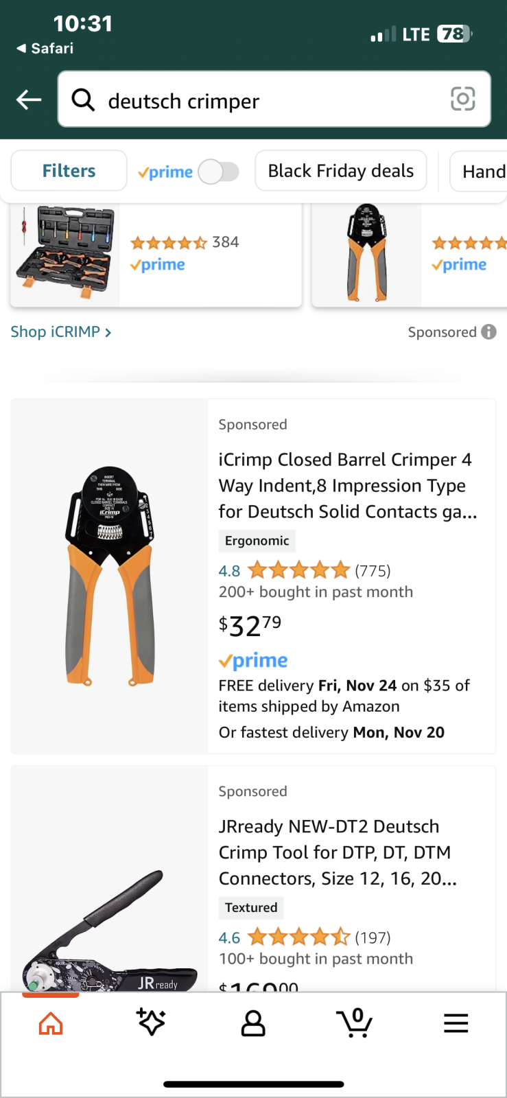

  3. I am adding another vote for Deutsch connectors. They don't feel cheap in your hand because they aren't cheap. They are really easy to ***emble and separate too. I do not have the Deutsch crimper but have used my Blue Point ratchet crimper with the bare terminal jaws to a degree of success, I give the terminal a crimp on one side near the shoulder and then flip it 180 degrees and crimp it again near where the wire enters the barrel. Not remotely the correct way to install them, but I tried clamping the terminal in the vise and giving a piece of s**** wire a yank and they are in there pretty tight, took a serious amount of pull to get them apart.
    I would say over a long period of time moisture will eventually get in or the connection is not as optimum as it should be since it is not getting the squeeze from all sides like the proper tool does. I did my method when I had a camper shell put on my modern truck for the 3rd brake light and interior dome lamp, this was back in 2014 and they still work, even with an excited Dutch Shepherd back there slobbering all over the connector...and as well as every other surface.
    Go with the Deutsch stuff.

    That iCrimp connector and others of that type are junk. The JReady or similar copies of the official Deutsch crimper are substantially better.
