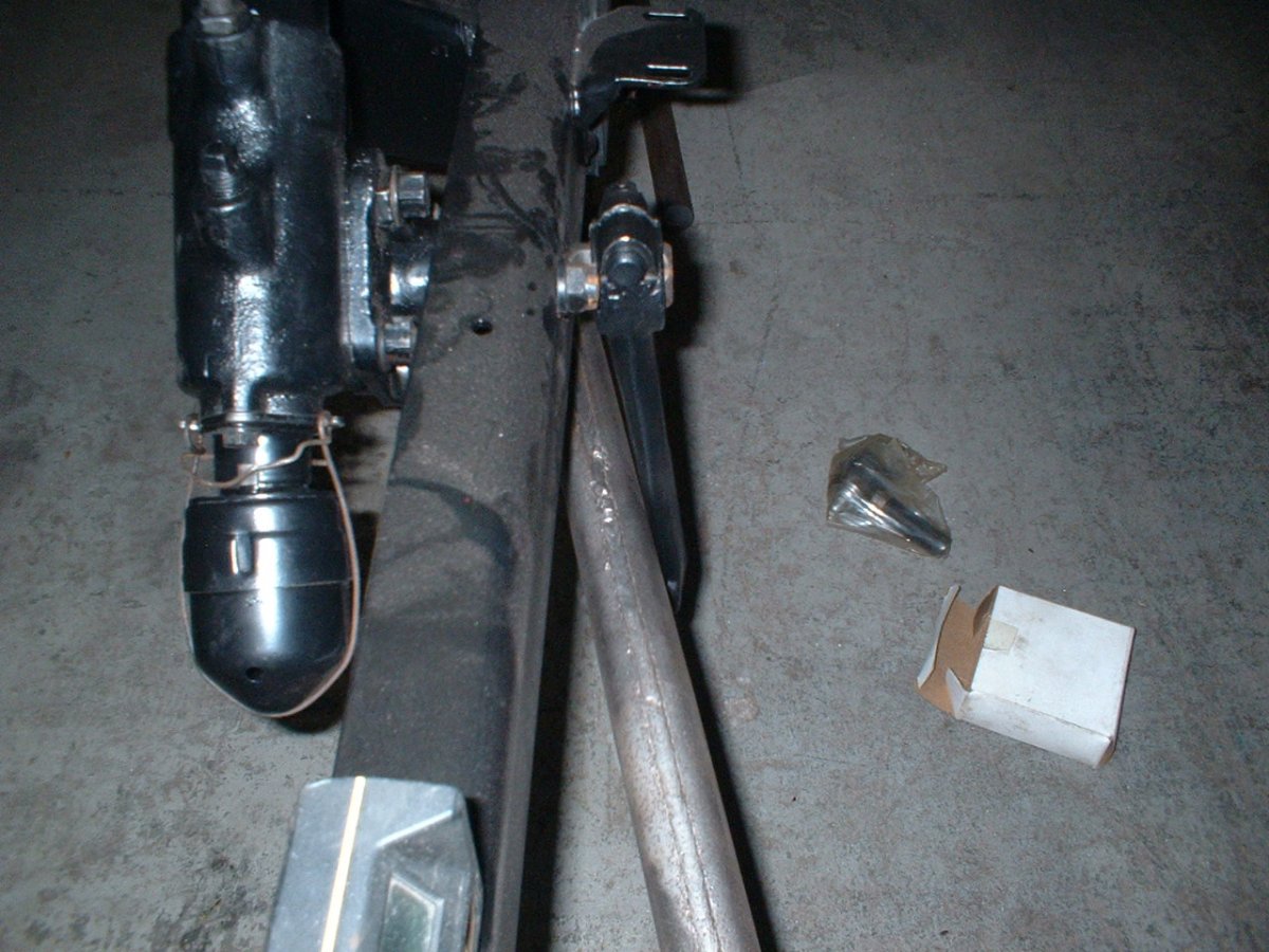

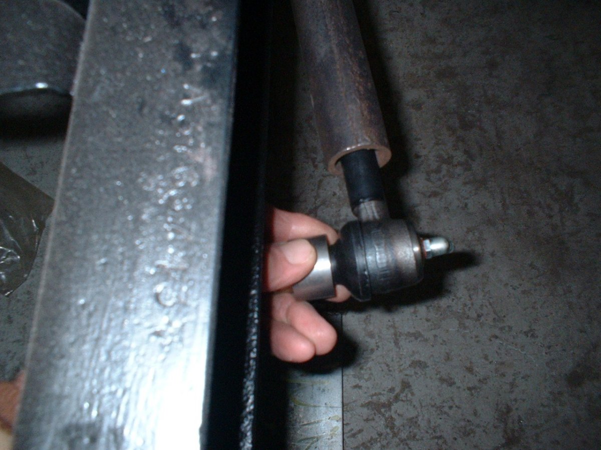

    I'm using an F1 box with a Model A snout welded on it and moved as close to the frame as possible and still had clearance problems with my split wishbone. I also used the snout off another steering box as a support bearing on the outside of the frame since the sector shaft stuck out quite a ways. I ended up buying a 7 degree drill bit and mounting the wishbone on the inside of the bracket and bending the pitman arm. With the 4 bar I would probably use the Vega box.
    lake_harley and ClarkH like this.

    Model A Gomez.....I've been searching the HAMB for solutions to a split wishbone/drag link interference issue I believe I'm going to encounter. You're post and photos are similar to what I think I'm going to find. I have a Model A frame, '35/'36 axle, plan to use the stock Model A 2-tooth steering box if possible, and because of engine/transmission choice I need to run split wishbones. I ran out of time today to do a complete mock-up, but at first blush it appears the draglink and split wishbone might be on a collision course.
    To get caster into front axle without pie-cutting the A wishbone I have and splitting it, I had hoped to use a pair of wishbones that have already been separated. I think they're from a '37 since they have a 2 1/4" opening on the "wrist" that pins to the axle, have more bend built in for caster purposes, and they're a bit longer than the A wishbone would be. My wishbone frame brackets would land about 1/2 way between the front body mount and the front running board bracket with the '37 (?) wishbone.
    I'm guessing your pictures posted were "during construction" and I didn't quite understand if your drag link is mounted to the inside or the outside of the pitman arm. The photo shows the wishbone on the outside of the frame bracket, but it almost sounds like you might have re-done the frame bracket hole's taper and mounted the wishbone on the inside of the bracket, with the rod end's nut toward the outside?
    I hope to spend some time doing more of a complete mockup of the front end tomorrow, but these unknowns really bug me and I hope you can offer some input on what you ended up with. It might be a solution similar to what I'll need to do.

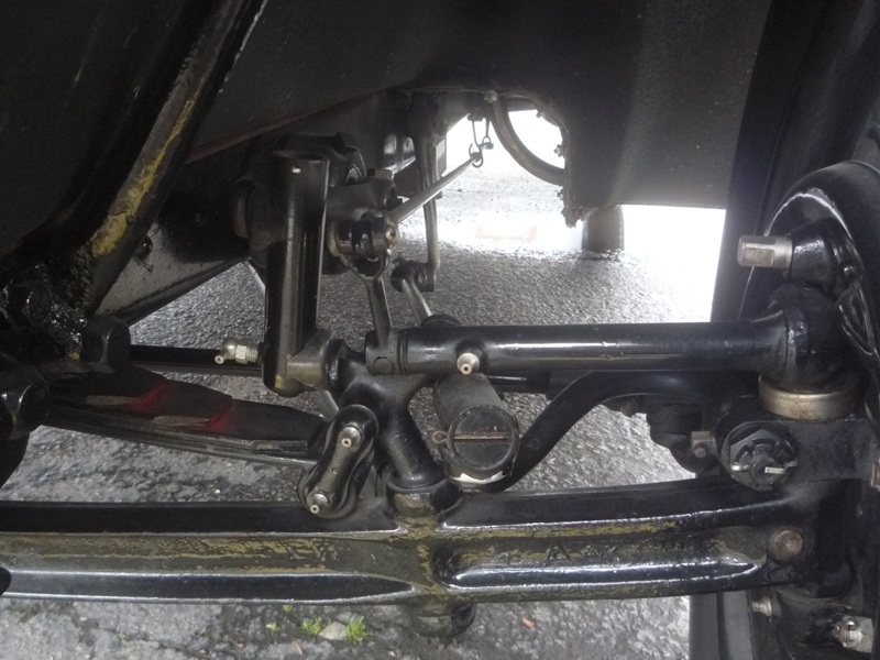

  10. @ClarkH kinda what we were talking about
    Sent from my SM-G965U using The H.A.M.B. mobile app
    ClarkH likes this.

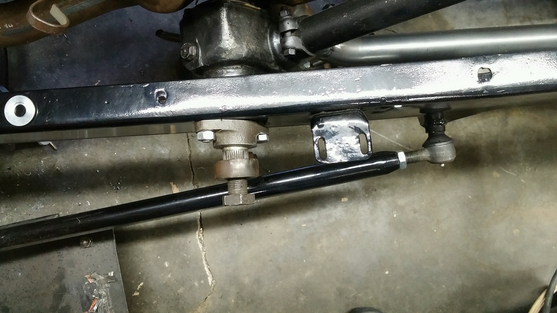

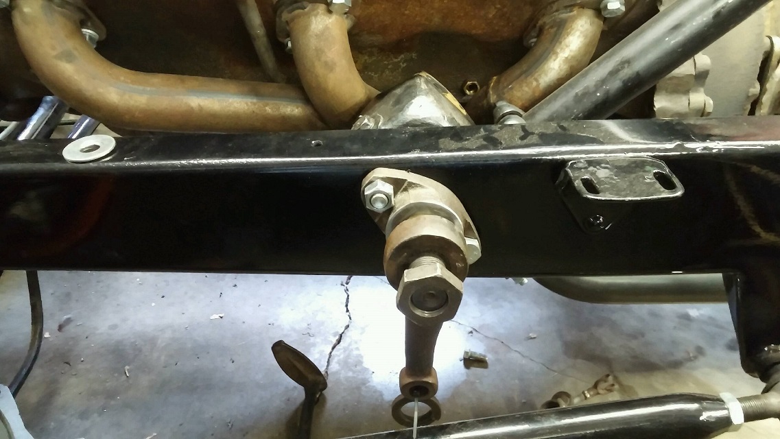

    I did a bit more mock up of the steering and split radius rod parts on my Model A frame. Most parts involved are listed in my post #8 above, but I'll add that I have '32 spindles on the '35/36 axle.
    Problem is interference of the split radius rods ('37 I believe) and the pitman arm on the stock, Model A 2-tooth steering box. FWIW, the radius rods are 40 1/2" long from the center of the perch bolt hole to where the wishbone was cut apart. The first photo is looking down on the radius rod toward the inside of the frame rail with me holding a Ford tie rod end in approximate position it would be in on a bracket mounted to the inside of the frame. Second photo is the interference of the pitman arm and radius rod. Mounting the radius rod to the outside of the frame would require the drag link to "cross over" the radius rod and that can't possibly work the way I see it. I don't think I could move the radius rod/frame attachment bracket far enough inboard to clear the pitman arm without getting into the bellhousing and/or transmission I'll be using. Although I'd like to retain the Model A steering box, I'm thinking I may have to go to a Vega or Unisteer cross steer setup and switch to a pair of '40 spindles I have.
    I've tried searching the HAMB regarding split radius rods on a Model A, and have looked at many Model A photos that might show how steering and split radius rods co-exist but haven't found anything. This really has me baffled. I thought I knew something about hot rods and how they were built, but apparently I never paid nearly enough attention to details when I looked at Model A's.
    I hope I'm not crashing in on this thread, but it sounds like I have a somewhat similar problem as the originator of the thread.
    Thanks, in advance, for input.
    Lynn
