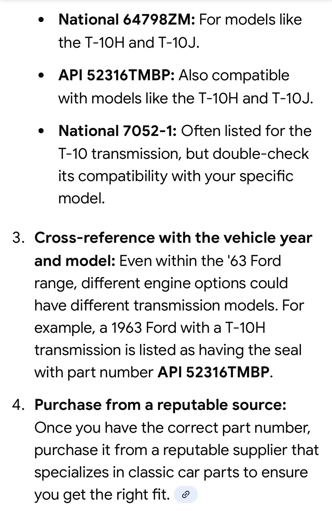

    I have ordered on from an online trans shop and one local. Both are wrong. Main Case is T10B-1 and Tail Housing is T10H-7. 28 spline output shaft. It had a Victor 63565 seal in it, but I believe that one is incorrect as well. Thank you!!!
    Inside diameter is 1.49 inches and outside diameter is 2.36/2.37. Thank you.

    Looking around on the ‘net it looks like you might want a National seal, p/n 64798ZM, info I found says it fits Ford Sprint, that was a Falcon model. IMG_4790.jpeg

    It might help if you gave us year, make, model etc. Also, are you sure the transmission is original to the car? Dimensions would also be helpful. O.D. of the seal, O.D. of the yoke, thickness.

  5. Is the problem the od or id?

    Unfortunately, it is not in the original car. It is in a 1940 Ford Coupe, behind a 289. I will have to get the measurements. Thanks.

    Both. Thanks.

    Found the correct seal at RockAuto.com. National Part # 7692S Thanks for the help.
