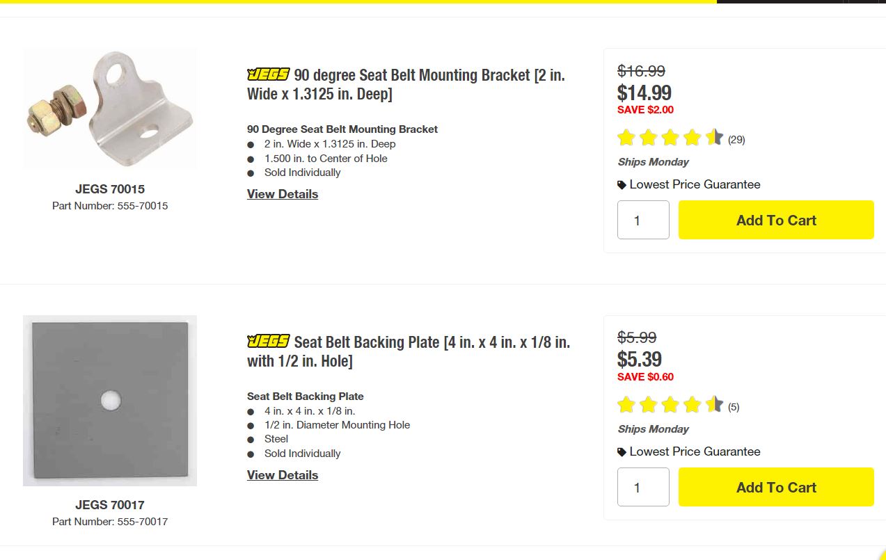

    The belts in my Ford, under the car I use parts bucket thick (5/16") front end washers and the floors are good. Also something stout inside the car and grade-8 bolts and nuts. I torqued them too.

    Fender washers won't keep a bolt from pulling through the floor in a good collision. A large plate that distributes the force across a larger section of the floor might.

    1/8" thick... ? Nah... I used old thick front end washers, 3" diameter at least. In hindsight, if I had to do another installation, I'd be doing a more serious job with something welded from both sides and more substantial.

    those were the best ones I saw in my quick search. 4" square, I think rounded corners may have been better. there were others that were like a 3 X 2 with a bolt welded on, they looked thicker and the edges were rolled.
    most were just thin washers.

    It's not the thickness of the plate, the floor is much thinner. It's the size of the plate to spread the load across the floor.
