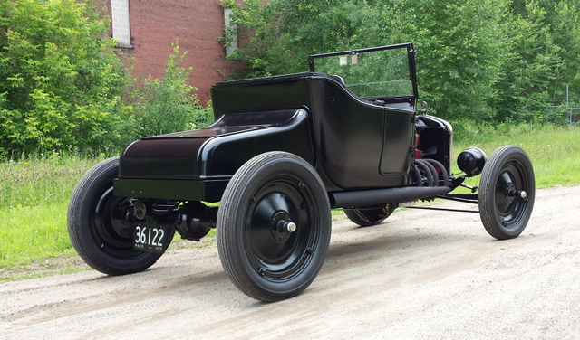

    IMG_7747.jpeg I found the builder, he was in M***achusetts when he built it. Sold to Virginia or somewhere south. No trace since. Anyone know it?

    That’s a neat car! Chevy wheels?

    Yes those are Chevrolet wheels, 25-26 wheels.

    Certainly looks like it, wonder if the hubs were changed or if they fitted early Fords?

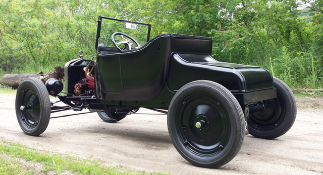

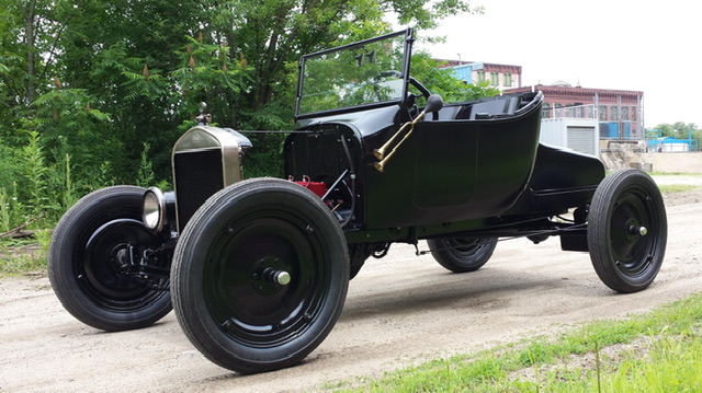

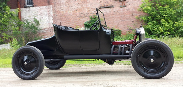

    Here is the description from the builders web page. Probably also a good idea to post this here because who knows how long that will be available. And some more pics
    Engine: Rebuilt & balanced Model T, Simmons Super Power Head, Bosch Magneto, Zenith Intake and Winfield Carb, Finned side & Oil pan Covers, Stipe 290 cam with bronze cam gear, external oiling kit, Indy style hand fabricated header, re-cored radiator
    Transmission: Rebuilt to stock and balanced
    Ch***is: 5" drop, Model A steering box and links
    Wheels: 21" disc w/new Lester tires: 4.50/4.75-21"
    Electrical: 12 volt system, rebuilt starter and generator, custom hand wired with 100% cloth covered wire IMG_7790.jpeg IMG_7791.jpeg IMG_7793.jpeg IMG_7794.jpeg

    That is very cool, are 28/9 Chevy wheel's 21"?
    I'm guessing he used Chev stubs on the T axle
