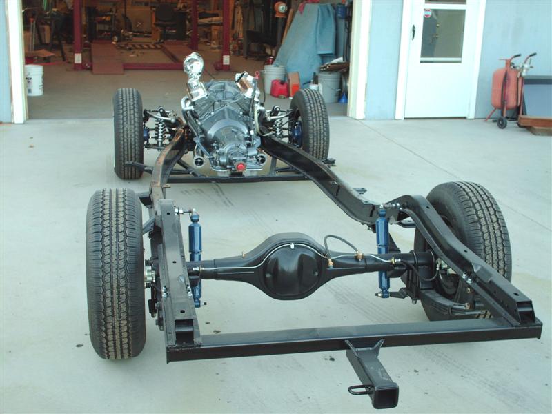

    I removed the stock crossmember at the rear of the chassis on my 54 and replaced it with a heavier piece of 2x3" tube. I welded triangular braces running up the frame on each side, and a 2x2 receiver to the middle with a couple gussets. The side pieces (2 on each side) sit under the old rivet holes so everything is plug welded to the upper part of the frame. I can jump up and down on the hitch and don't see any deflection.

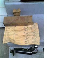

    I had bought this one for my 50, but I have since sold the car. Its a Fulton universal hitch that fits all kinds of different cars from the 50's (up to '59). the instructions tell you how to configure it, in the picture its configured for 49-54 chevy. It bolts through that rear cross member and one bolt through the bumper. It says its rated for 2000# gross, but If you were gonna actually do some real heavy towing I have to say Charlie Chops' looks pretty sweet.
    Let me know if you are interested, I was going to ebay it. Its a cool period hitch. and its already chromed!

    The 1/4" tube on mine is the same as the hitch that is on my motorhome with a 10,000 pound rating. Should be heavy enough.

    The picture doesn't show it, but I put two pieces on each end of the tube that extend about 9" up the side of the frame. That prevents any twisting of the tube and spreads the load up almost into the rear spring mount. Once I got the car back together, I compressed the suspension of the car by winching down on the end of the trailer ball while measuring twist of the whole assembly (used an indicator similar to an old beam type torque wrench) and didn't see any movement. I feel confident that it's stronger than any bolt-on hitch that was used in the old days. I had one that was on the 54 and it had two u-bolts around the stamped crossmember with a bolt to the bumper. When I stood on it the bumper bent. With the present hitch, it I put something on the back that could cause it to flex, I probably wouldn't be able to tow it with a car anyway.
