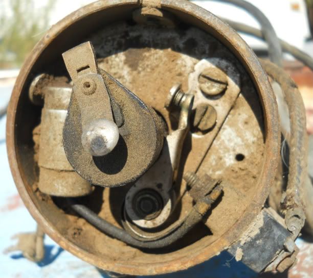

  13. Mr48chev
    Joined: Dec 28, 2007
    Posts: 35,898
    Mr48chev
    Unless it has been converted to 12 volts with a resistor and resistor bypass the coil should be getting power when cranking on a six volt system that is not missing anything. I'd say that isn't the issue though.
    Does he have the coil polarity correct? Coil polarity always matches battery polarity with no exceptions on oem applications.
    Rather than a test light when cranking I'd stick a dwell meter on it to read dwell or rpm either one and that should at least show that the points are controlling the function of the coil.
    Remembering back to when I was 16 and doing a tune up on my car that probably didn't need a tune up I got the lead from the condenser in the wrong spot when I put points and condenser in and it was actually over on the other side of the insulator block rather than against the lead from the points as shown on this old 216 Chevy distributor.
    Also make sure that the condenser is tight in it's holder. I've had replacement condensers that did not fit tight in the original holders. That is more prevelant now with one size fits a lot of applications ignition parts for older cars.

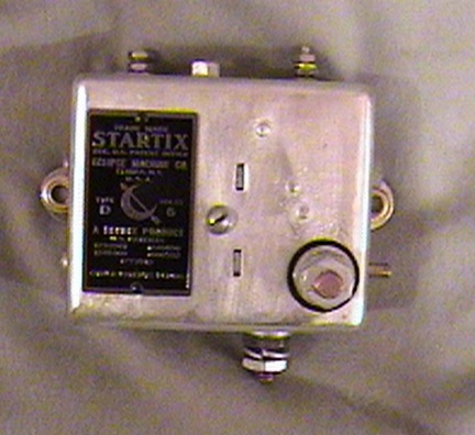

  17. theHIGHLANDER
    Joined: Jun 3, 2005
    Posts: 10,710
    theHIGHLANDER
    Most of them had a contact switch in the throttle mechanism with a vacuum override so the starter wouldn't engage in normal operation. It's actually a pretty trick deal when it's right. Better yet? Startix. Just turn the key, if it stalls you get an instant restart. Nice when they're fussy n cold but you need to be aware during an inconsequential stall and stab the clutch. To avoid that the ign switch has 2 settings, Stx and Ign. So once started you can flip the key or switch the other way and the autostart is defeated. "Hey, no pics?"
    Ok, a pic (shagged from a net search)
    ClayMart likes this.
