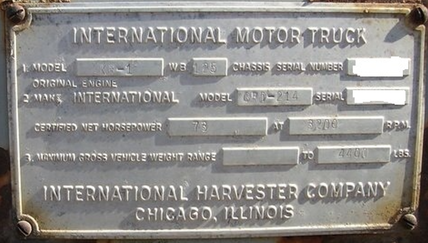

    I sold this truck in 2011 (much re-***embly required). The serial numbers are obscured as a courtesy to the buyer.
    Note: Max GVW is used instead of axle weights.

    Made it a bit bigger for you :)
    Click on the photo to make even bigger

  6. Thanks but like you said, I can't read any of it. this is the style I need to see. I never have seen one like this mounted on the firewall, this style usually is mounted on the kick panel and used on trucks from 41 to 46 and the 47 on trucks had a different style plate on the firewall.
