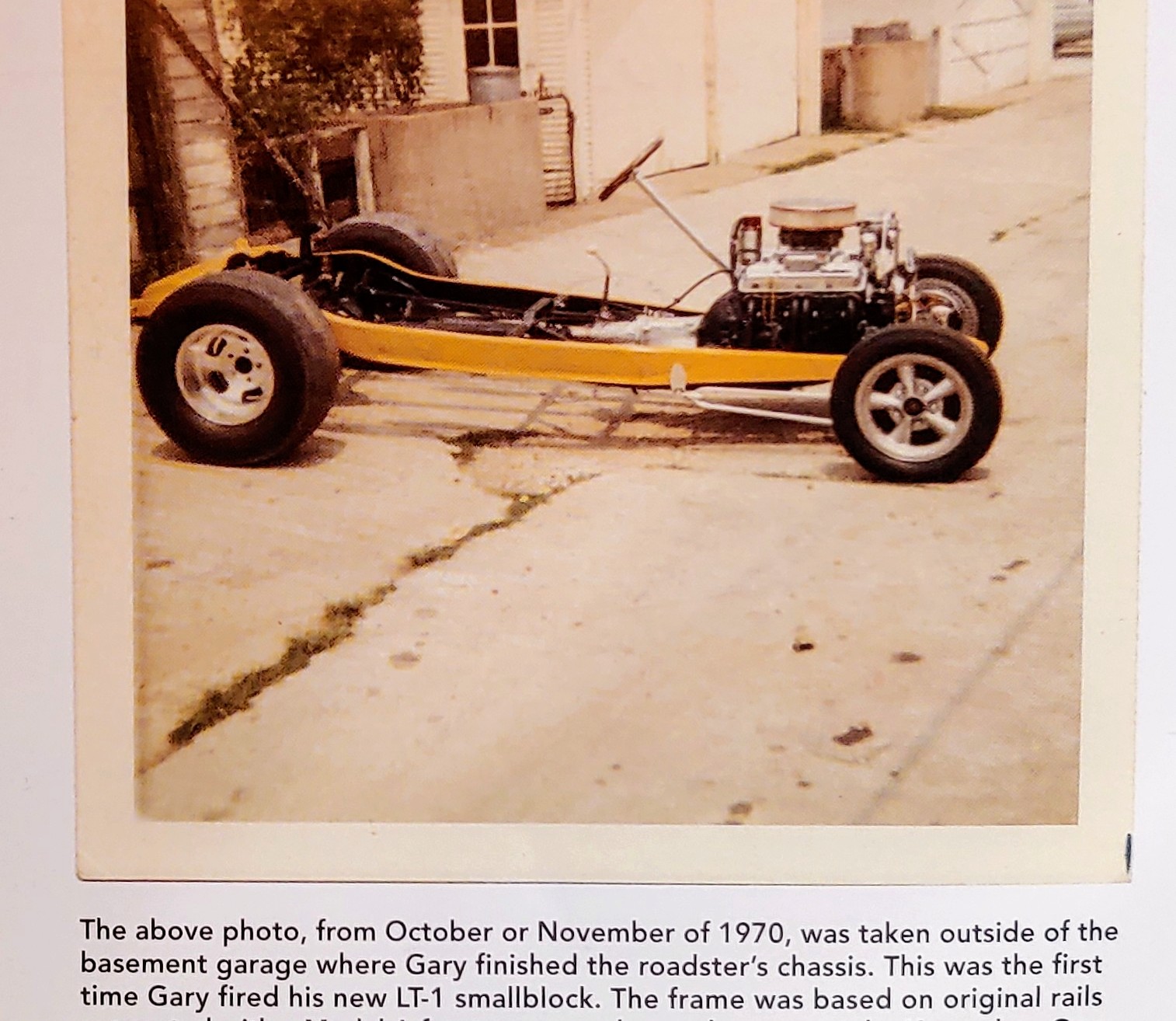

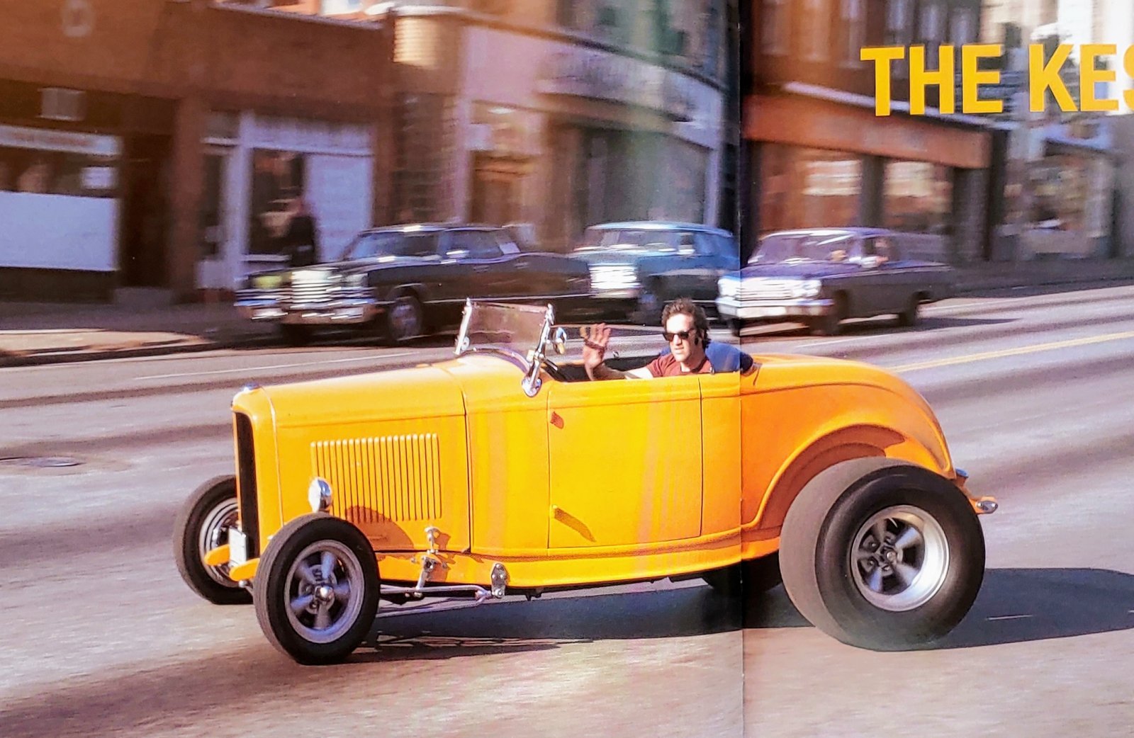

    Gary Keesler's iconic yellow '32 had a black-painted center crossmember & inboard sides of rails:

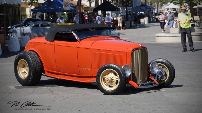

    So did Ryan Reed's '32 in RJ #64:
    42ECBDFE-6A1C-490A-8521-2B1C2877765D-e1574528428541.jpeg :
    Thoughts? Have any of you HAMBers done that? Would you do it again?
    It seems like a good idea for a really nice car that you're actually gonna drive.

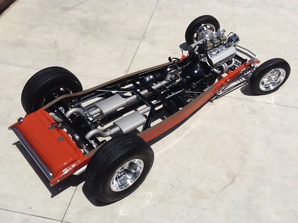

    I'd do it on a driven/show car just to make touching up rock chips easier.
    A little krylon spray can black and a few minutes and I'd be done with the inside.

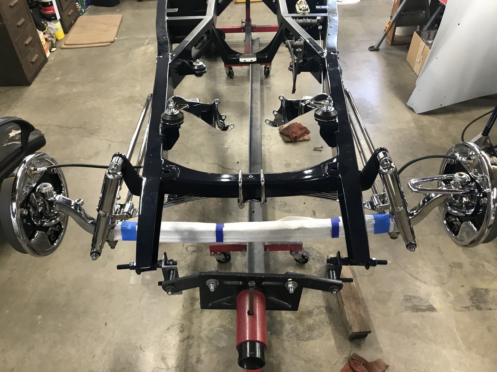

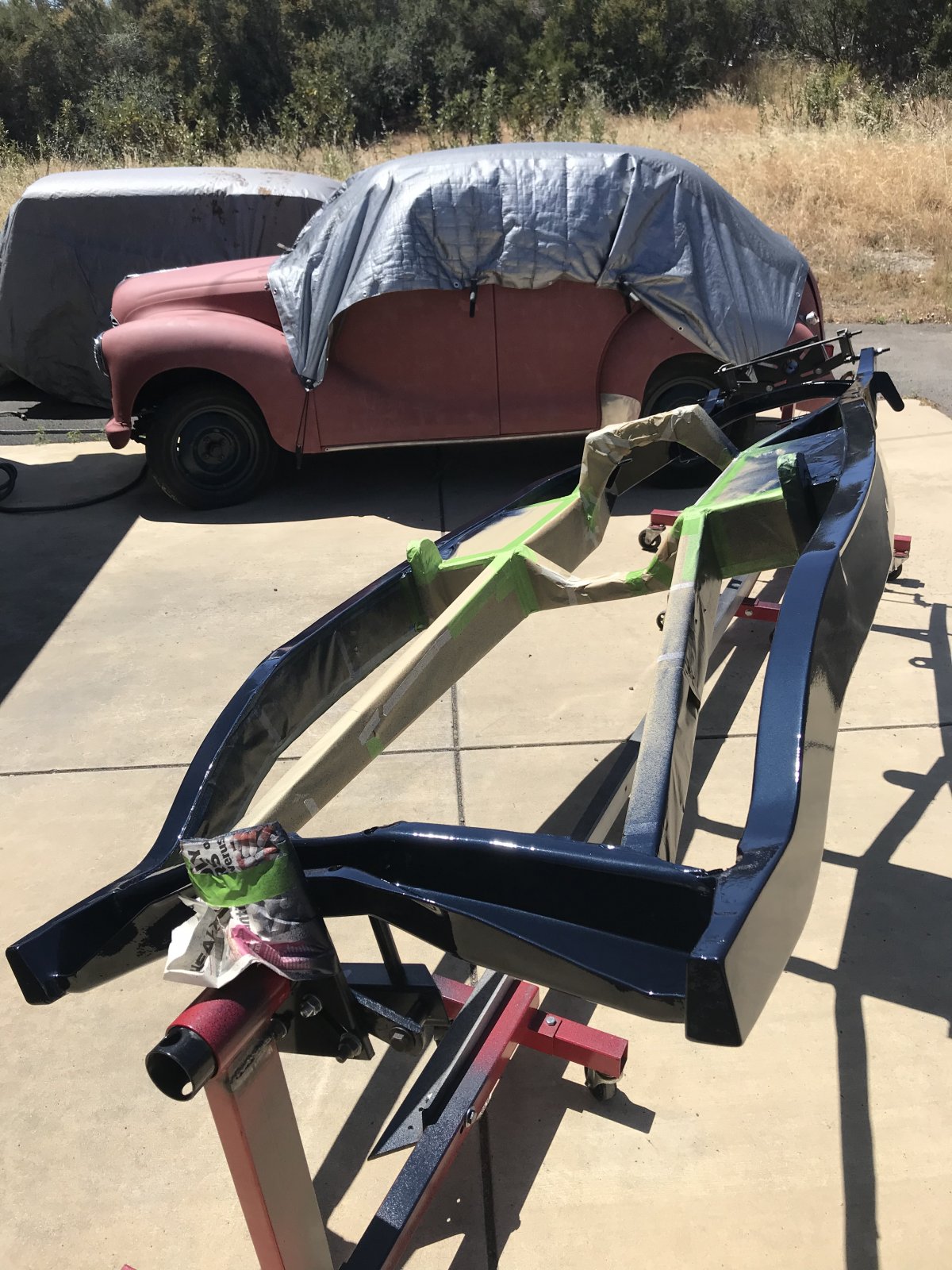

    I just did that to my roadster frame. The outside is mid 60s Buick Diplomat Blue metallic and I painted the inside, from the firewall back, with Krylon Rust Tough semi flat black. So everything you see normally is body color. I’ve had great luck over the years with that type of Krylon as chassis paint. I figured that I would probably have to add a bracket or drill some holes under there and that paint touches up nicely. Hard to see in the picture. A whole lotta masking.
    588387DF-27C0-4079-908D-DBE3FC71BC88.jpeg 7473105F-6F83-4193-A2F0-62EF6E7E4623.jpeg
