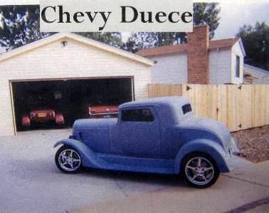

    Heres one. It belongs to a friend. He skinned an early 90's vette and lengthened the frame. Every thing on the car is all corvette including the wiring and dash.

    That's what I'm talking about. Does he have more info? Or, can he point someone in the right direction?
    After reading some of the posts above (that vette's don't really have frames), I started to comprehend why there is no info to be found on such a conversion.

    i dont have any more pics and i doubt the owner does either. He literally skinned the vette added the length, and lowered the 55 down on the vette and made mounts.it was pretty straight forward .his is kinda rat roddish, but the same principle would apply . Just take more time with the fit and finish. Hope that helps. Good luck!
  20. Kind of what I figured by the pictures you posted. I blew them up and the car does look a bit ragged, race car like. Still would have liked to see some pictures of his process.

    no its safe and built good, just needs to be finished better on the inside.
