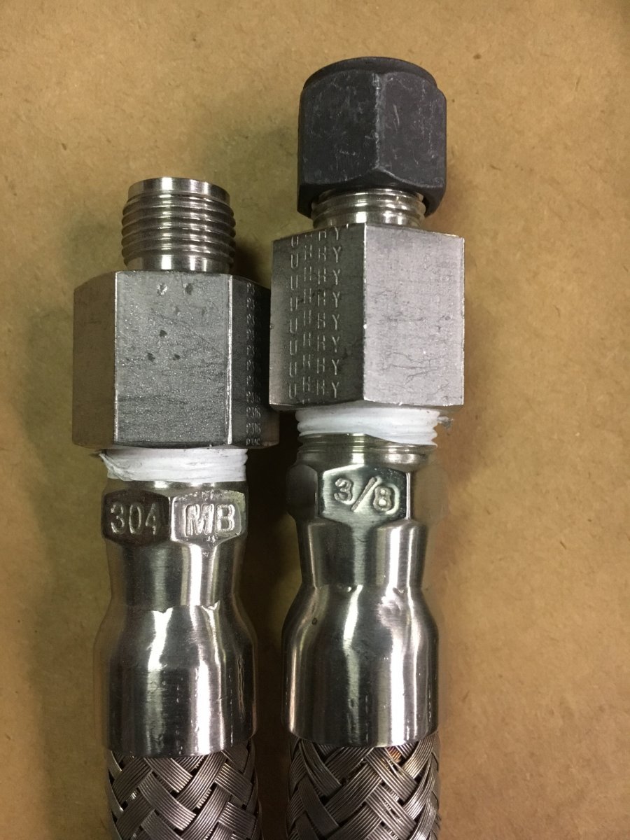

  17. A mystery,,, I love a good mystery!!!
    Here’s the problem,
    The male end of the fitting screws into that ^^^
    Yep Some ***hat ****forbrains idea

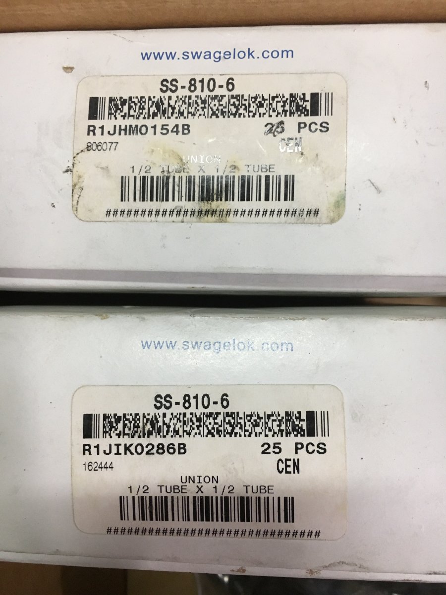

    I have some fittings that look similar. I believe their 3/8” Swagelok.
    deathrowdave likes this.

  29. ekimneirbo
    Joined: Apr 29, 2017
    Posts: 4,218
    ekimneirbo
    It looks like the part you originally showed with the thread isn't damaged, it's the other part that's stripped out. Can't you just dress it up and get it welded, brazed, or soldered back in place?
