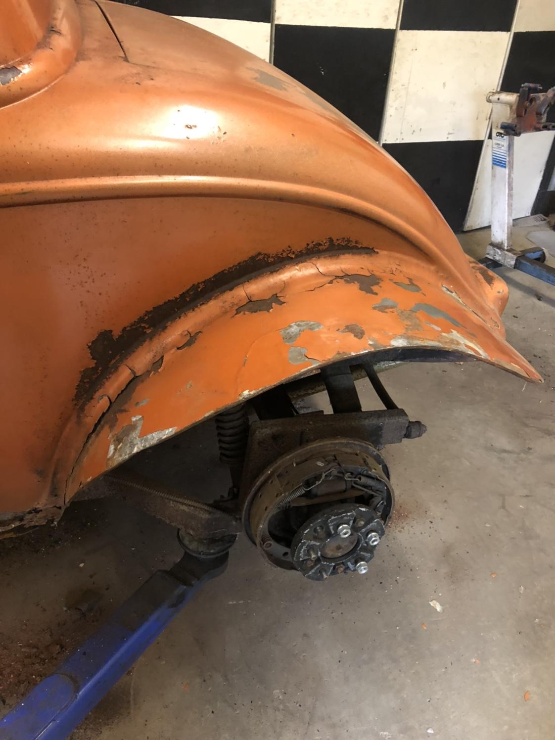

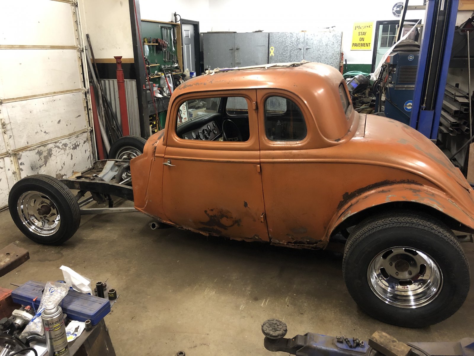

    Big thanks to Randy Haubrich for banging out this fender bender
    Really contemplating moving the crossmember back, and going with a spring over axle. Wheelbase was extended 4” to 116”. Front crossmember was moved 7” ahead, running a ‘48 front end with added leaf springs.

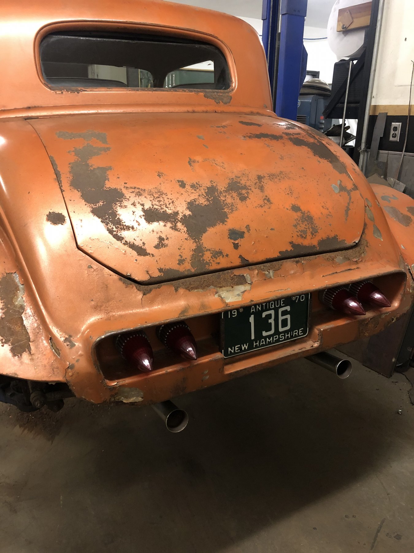

    I've had this old Kodak snap shot in the garage for sometime...finishing up this evening, I remembered to bring it in and scan it for you...The picture was developed in April 1974 (according to the back). Some real similarities, but, I don't think its the same car.....rear fenders are similar, poncho motor, and some other cues... I don't have much to tell you about the picture...I bought it at the Brimfield Fair (an antique flea market that happens 3 times a year in Brimfield, MA). I saw it displayed with some Fleer drag racing cards and bought the lot. The seller didn't have any info on it, but, he was from CT. Anyway, for whatever its worth....I figured I got this far so why not scan it....enjoy that wonderful 5w!

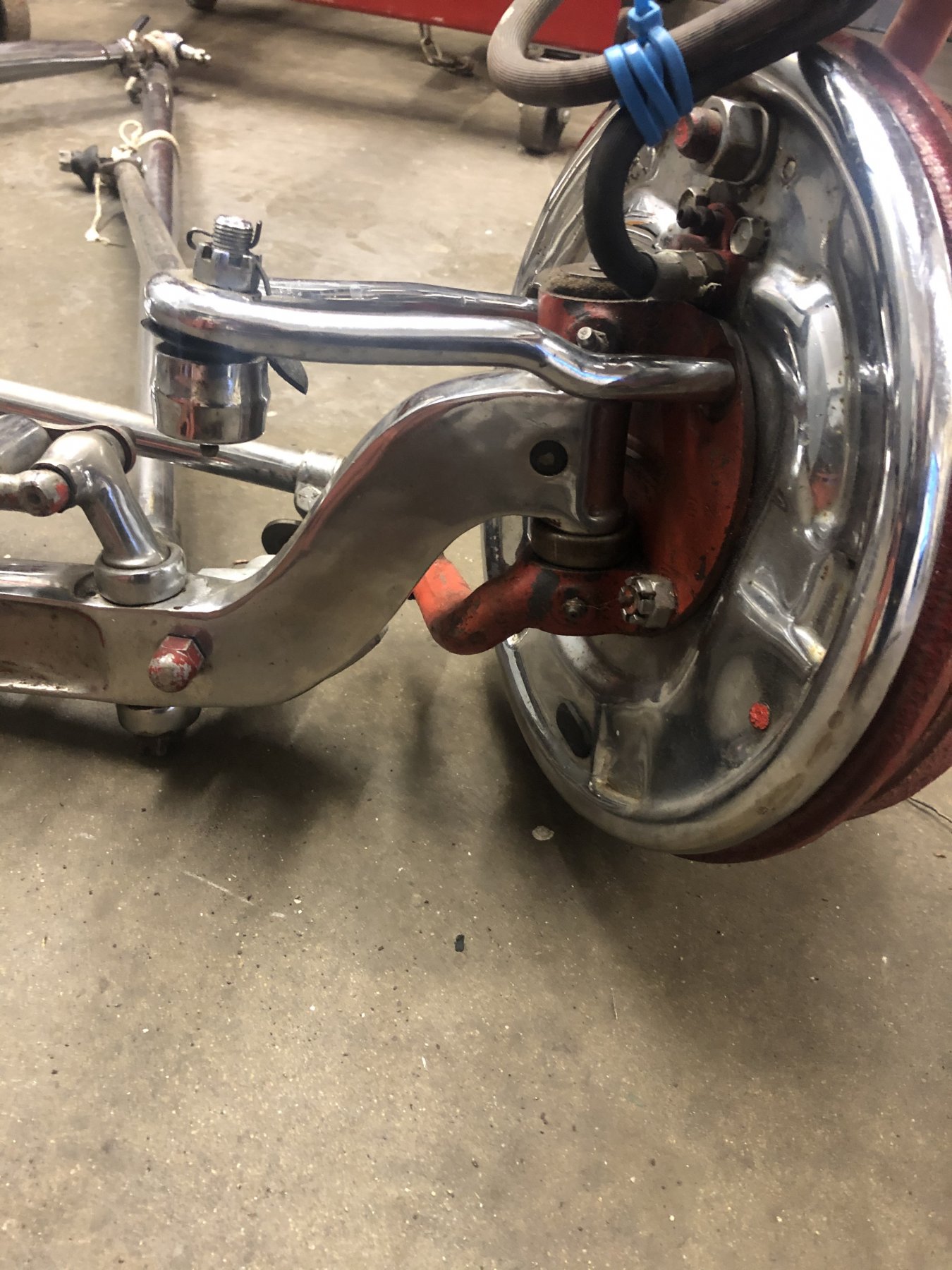

    393EF687-02B8-4421-9259-2D753BB76D0C.jpeg 8D48A238-AA20-4F65-A5E1-AA26D1A0C093.jpeg Found an old chrome dropped front end to put in the coupe. Came out of a California show car that was built in the 50’s. The drop and filled sections are beautiful, can’t wait to get it under this thing!

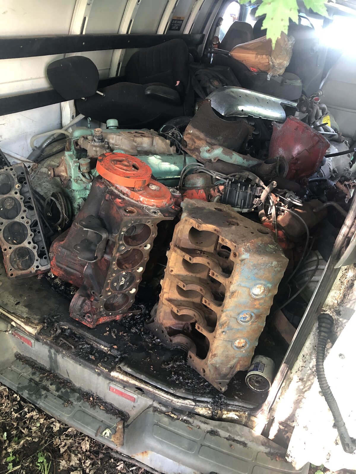

    Found a ‘63 389 in the back of an old van for a fair price, just waiting on the guy to move some other cars in order to get to it.

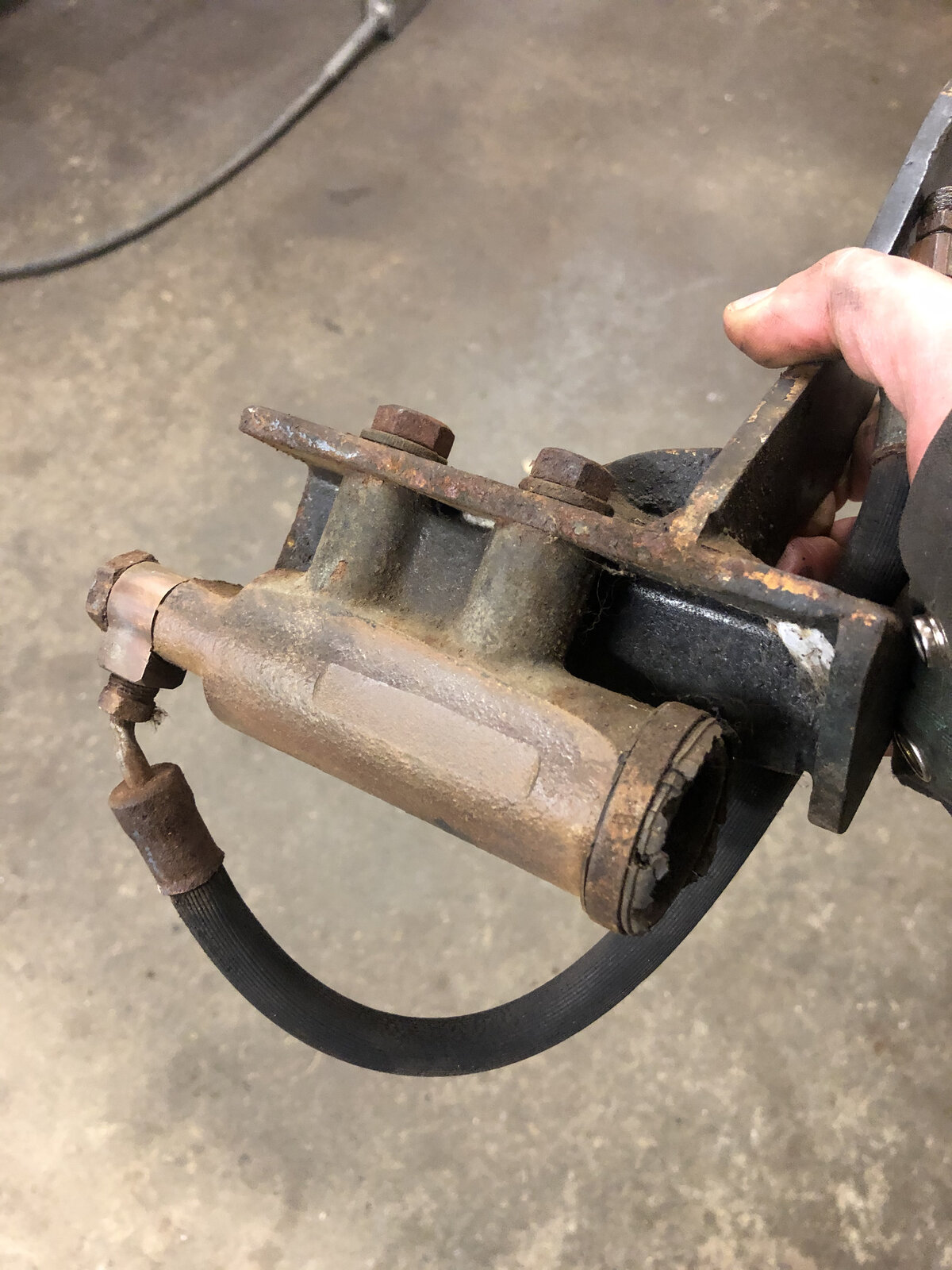

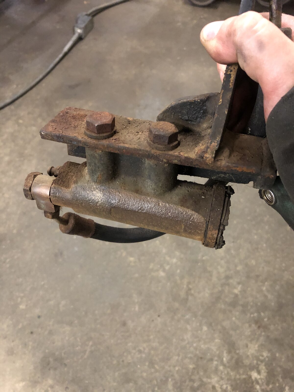

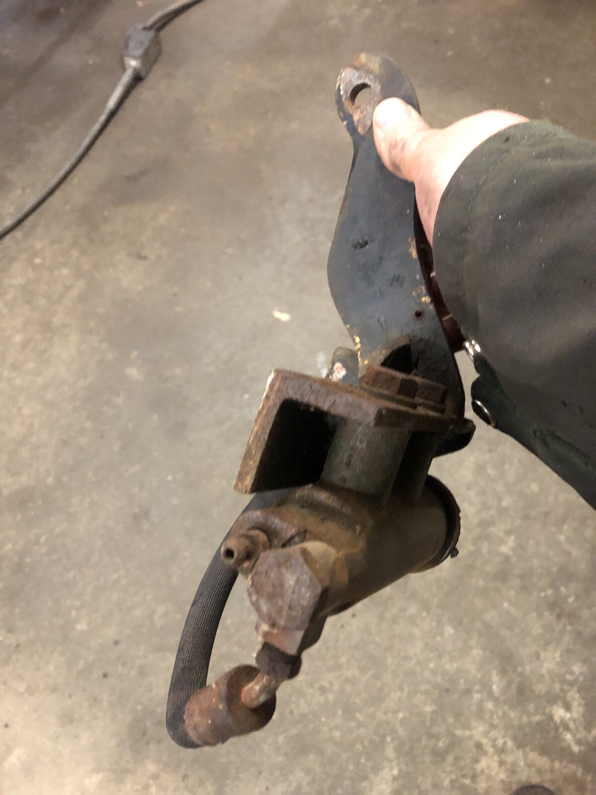

    Does anyone happen to recognize this slave cylinder?? Don’t think it’s international like the clutch/brake master cylinder.

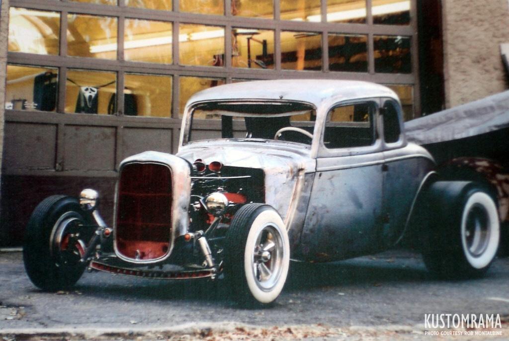

    To me this looks like the car![​IMG]

    Should I ***ume that there are no casting Identification, names or numbers on the salve cylinder?

    Shaun, NAPA may have a mount book with pics and specs. We had one from Anchor in the parts store back about 10 years ago. Might be one on line also.

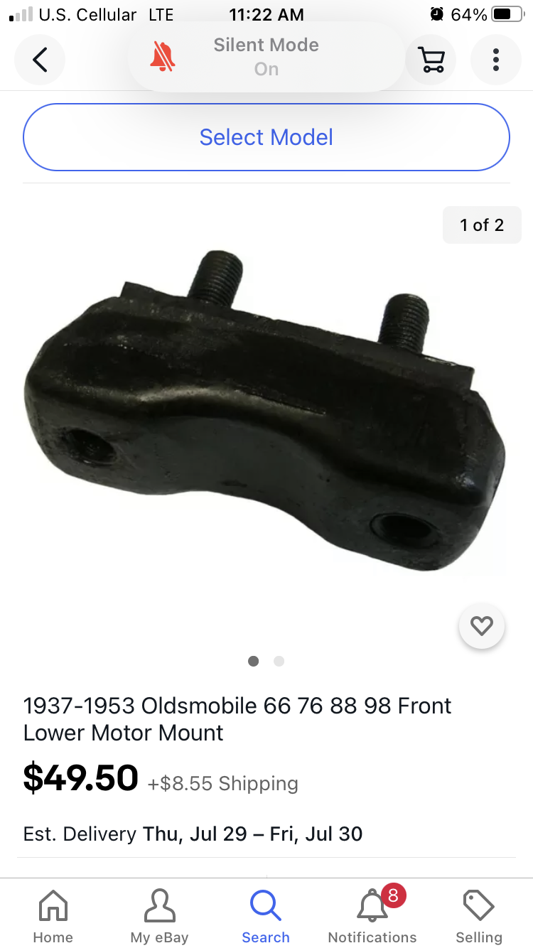

    Think I’ve got it! 1953 Oldsmobile front motor mount

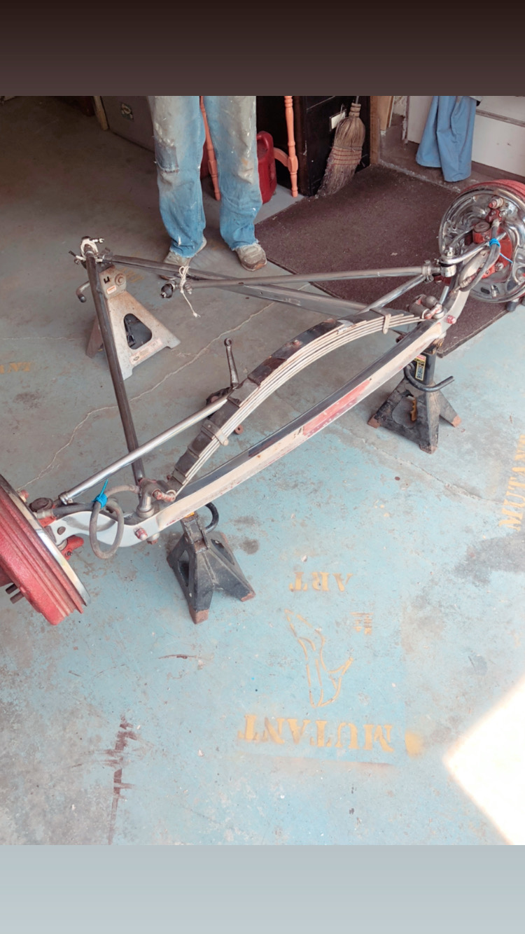

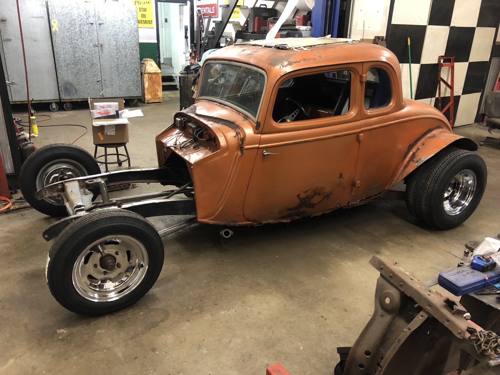

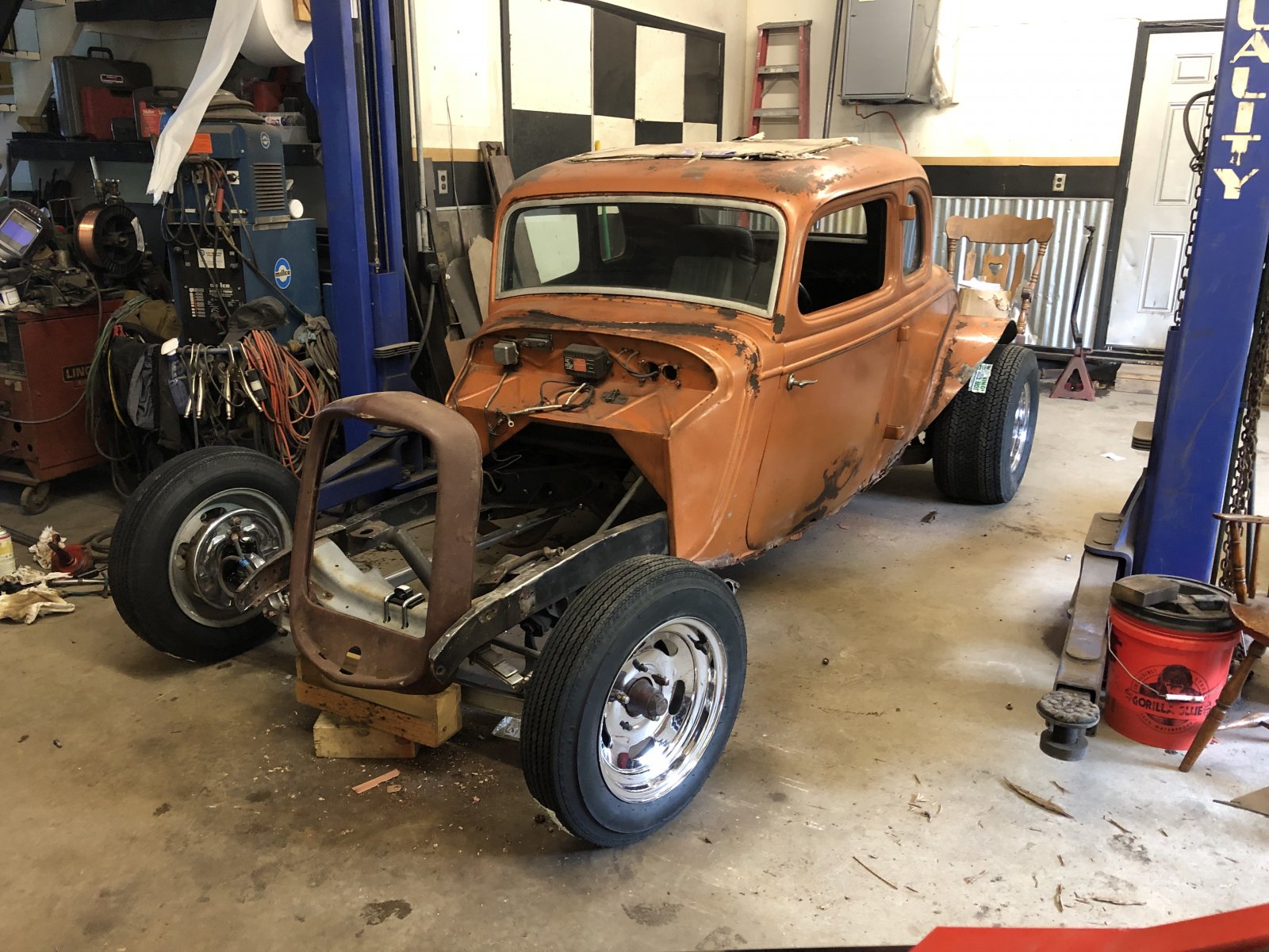

    Got the steering arms bent, and most of the steering figured out, had to roll it outside for first time since I brought it home. I think I got the stance right where I want it.
    The chrome front end ended up being way too low, so I cheated and re-reversed the spring back to stock. Also cut down some springs and made a 1” spacer at the top. Not as bad of a nosedive now.
    I was planning on running the tie rods below wishbone, but after dropping the steering arms I saw that was never going to happen, luckily there’s plenty of clearance over the wishbones.

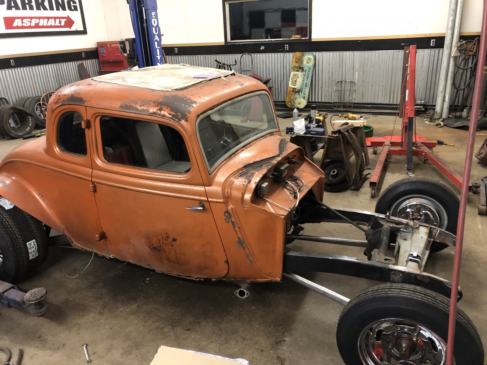

    A little update…
    Thrashed on the coupe to be able to bring it up to the Pinetree Jamboree in Winterport Maine to display, but unfortunately the car just wasn’t ready.
    A friend heavy into old hot rods recommended his buddy to rebuild the 389 in the coupe. He seemed reasonable and somewhat knowledgeable so I gave him a try.
    After waiting a few weeks, I bug him and he said the block was bore too far, really need another engine. So I found one. Unfortunately the one in the car was a 60, and I bought a 63. The builder had both engines, as well as my bellhousing, flywheel, and front motor mount so when I dropped off the 63 I told him be sure to check that everything fits before he started.
    Well. He didn’t check. Ended up with a rebuilt 63 389- that doesn’t fit. None of it fit. Bellhousing, flywheel (which he cut), motor mount, etc. none of it fit. When I showed him nothing fit he told me “ahh you should just sell this engine and buy a Chevy”.
    Pretty disappointed, but hey what can I do now? How hard could it be to adapt a 63 Pontiac to the T-10? Well after about 100 hours of research, trying multiple adapters, cutting up a BOP ****tershield, having a starter plate plasma cut, buying another flywheel and starter, and pulling my hair out I finally threw in the towel.
    So. The Poncho is back to square one. Haven’t had much luck finding a 59 or 60 block locally. I’m weighing my options of sleeving this one, or possibly sonic testing and boring to use 400 pistons, or maybe custom pistons?
