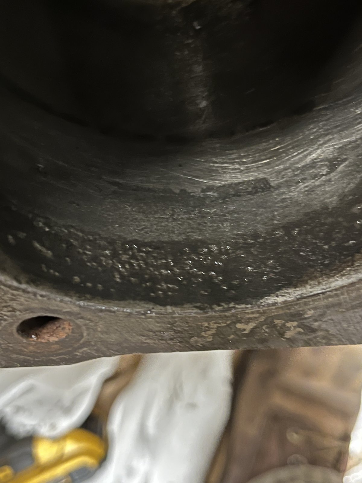

  21. Shaun1162
    Joined: Feb 22, 2010
    Posts: 973
    Shaun1162

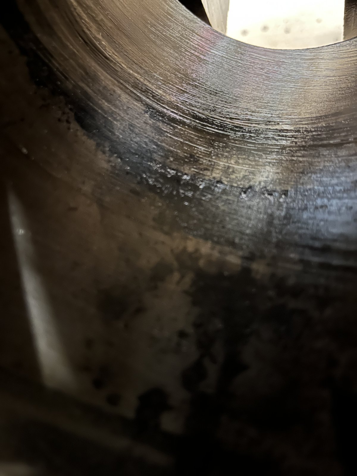

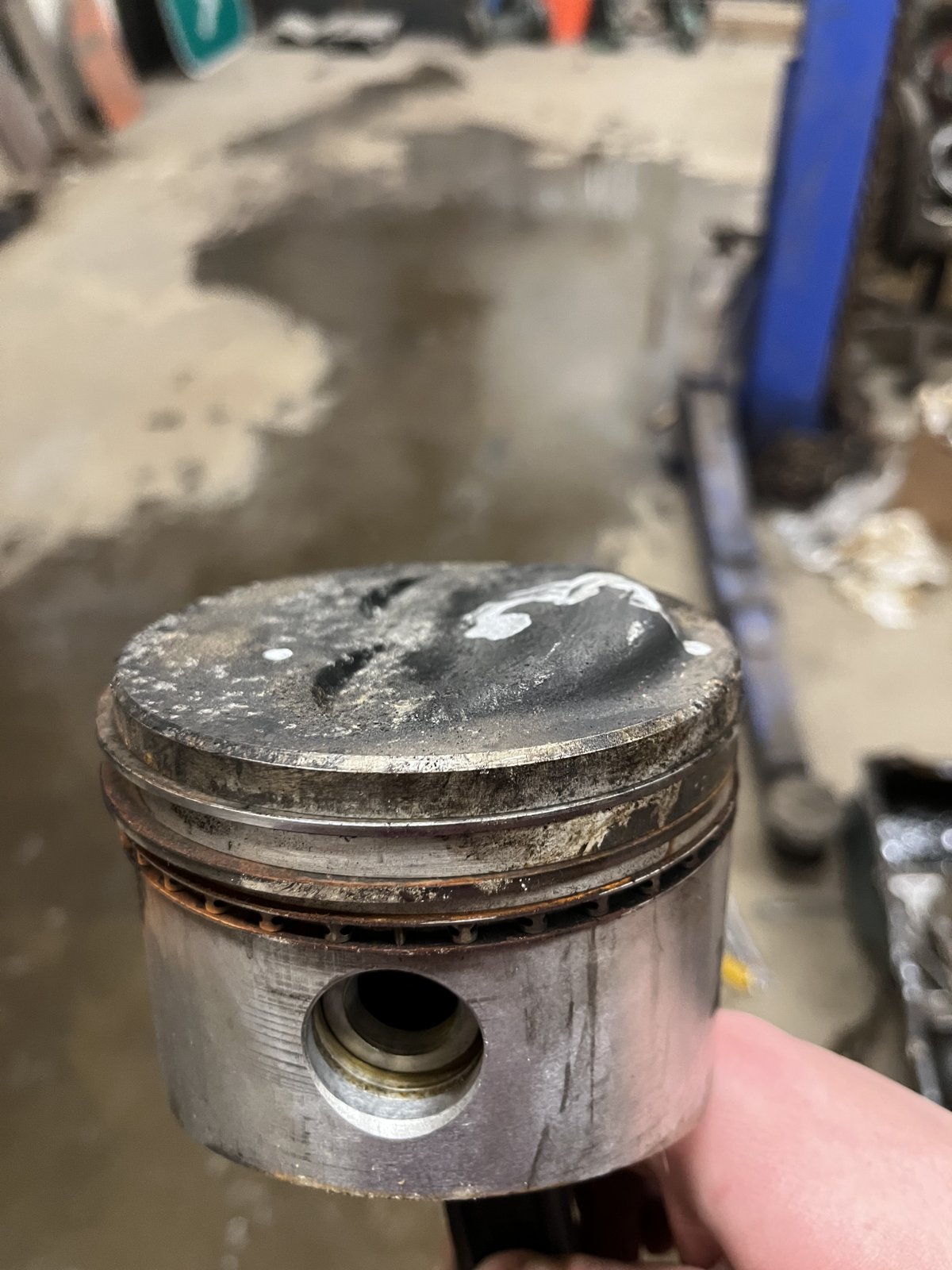

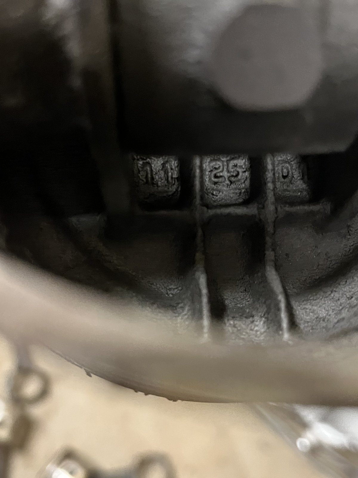

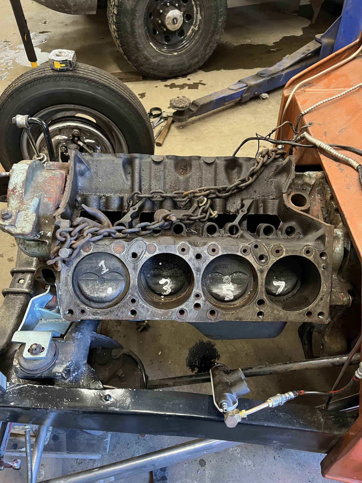

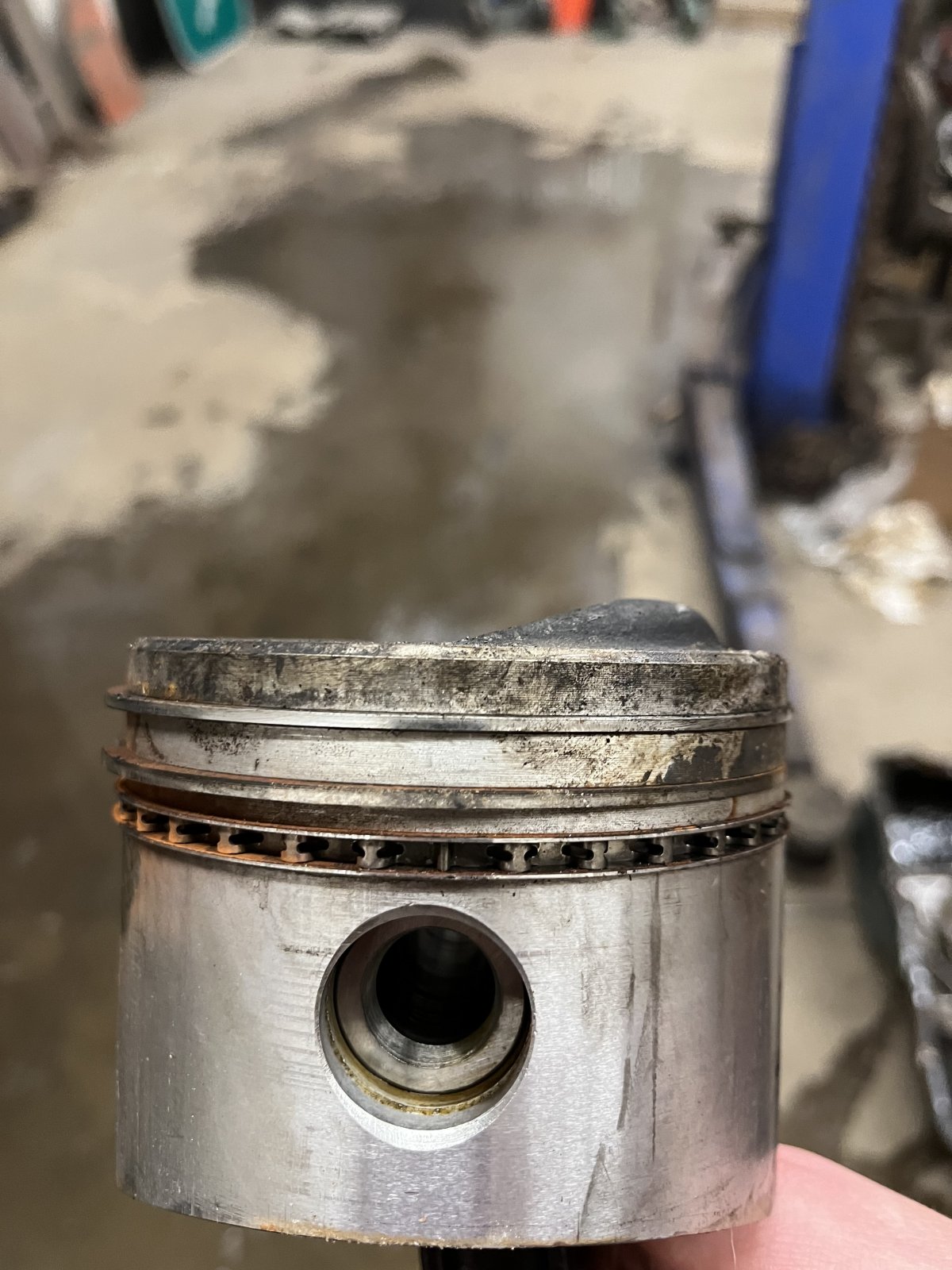

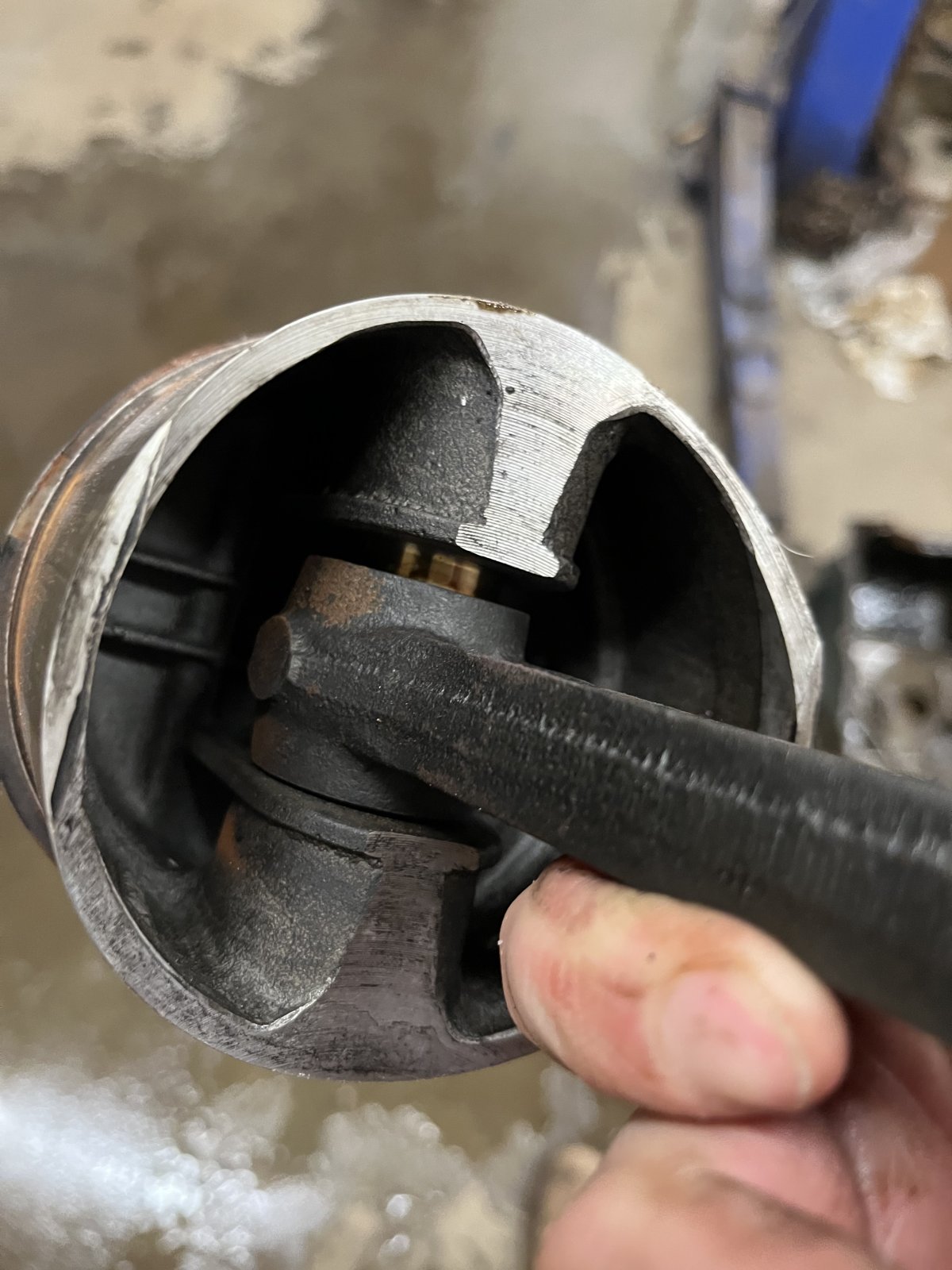

    F5D69E15-0FAE-4A78-A2F3-A54F26774DC2.jpeg 922BF685-CAC6-4A1C-B42E-D7E4A3D6E0A4.jpeg 6A5D7270-5F21-4F00-9AF8-B3701CB8D4AD.jpeg 82215881-FBFD-4741-A4CF-B36401D5AA89.jpeg EDE944A9-5948-43F1-A728-E1EA1AFE20C9.jpeg 9CF6A7FF-3CF3-45A6-B183-7197195346CF.jpeg 9AEEED62-E442-484C-A0FD-0B7A269BE6F4.jpeg 6BCA75DB-6BB5-411A-A461-B8306096B858.jpeg
    Took the block out of the coupe and took out the pistons and rods. Putting was worse than I thought. Looks like it had Jahns pop up pistons. Anyone happen to have an old catalog on Jahns? Tried taking block to machine shop, but they were leaving early yesterday for Christmas.
    I’ve been doing more research, pretty much a 1960 only interchanges with 1960. Earlier 55-59 have same bellhousing but “reverse flow” cooling, which gets into even more confusion and the blocks have different ports as well. And of course 61 and up at different bellhousings.
    I’ve been reading that 59 and 60 blocks are quite thick, and I’m hoping the sonic test proves that. I see one guy on the HAMB has a 389 bore .315 over! 577 CU in!
    Looks like it was balanced at some point. Crank is marked .010 for both rods and mains. Cam bearings have wear.
    Also there’s no clips in the pistons for the wrist pins?? Am I missing something?

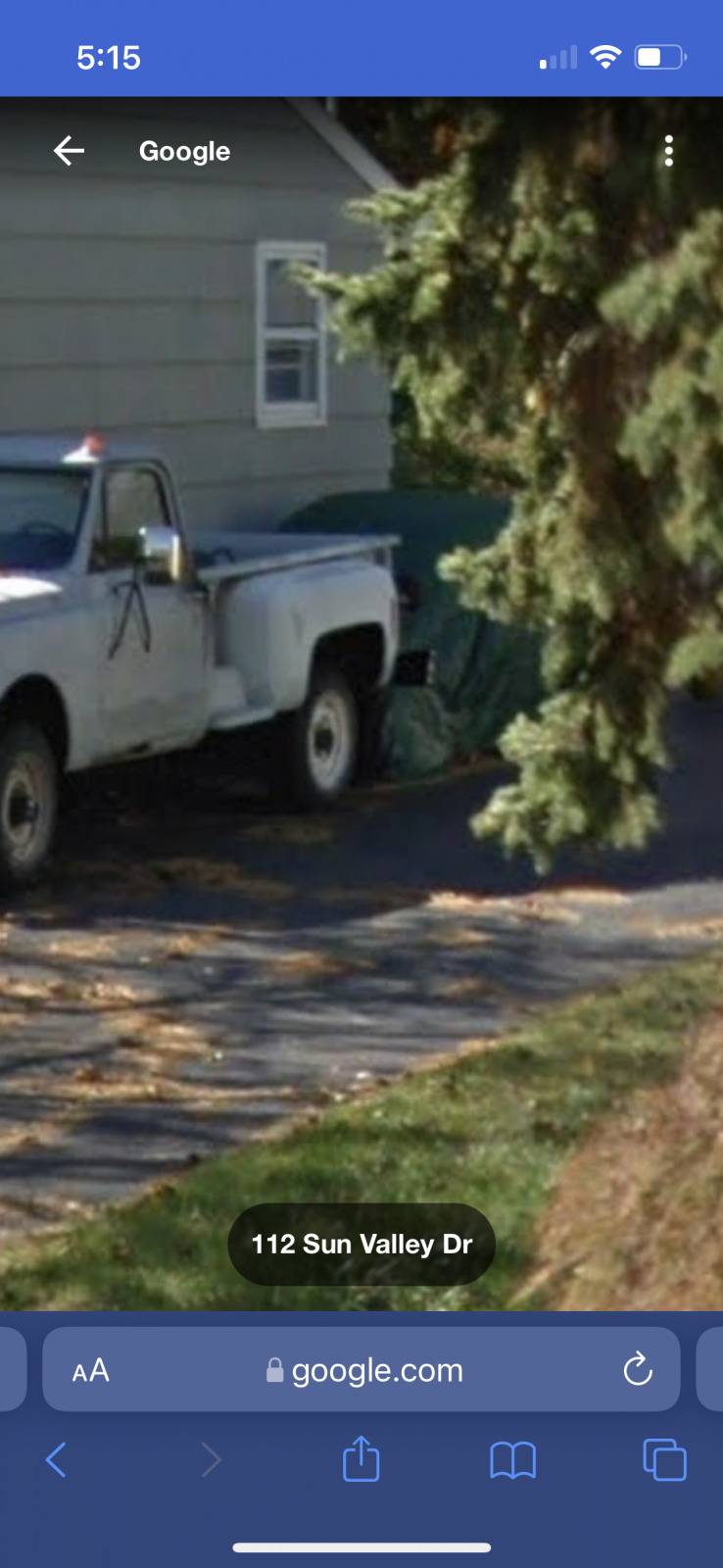

    A Christmas update for you all-
    On a whim, I sent some pictures and a message to the guy that I got the coupe from. He wouldn’t really give me any info when I bought it, but figured what the heck?
    He told me that Tom Staback from Meriden Connecticut built the car but never drove it much. He said that it sat next to his home for years under a tarp. Did a little Google detective work and looks like he’s right.
    Unfortunately Tom p***ed away shortly after I acquired the coupe. Going to see if I can track down any of his relatives. Fingers crossed.
    Looks like Tom owned Tom’s Mobil on Meriden-Waterbury road in Southington and later started Tom’s Auto Service in Southington. He also lived in Southington as well.
    Does anyone remember these shops or know someone who might??

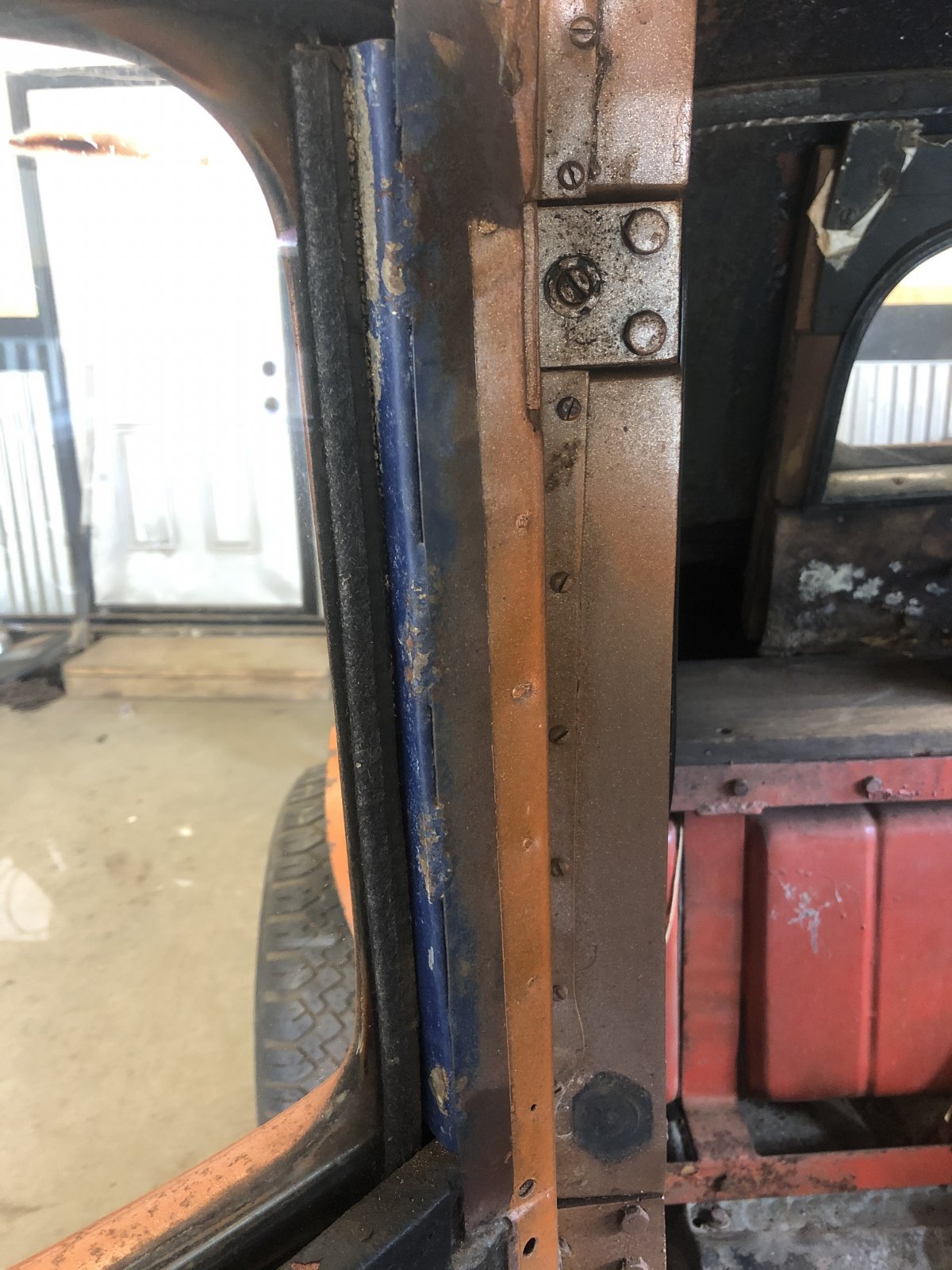

  30. Shaun1162
    Posts: 973
    Shaun1162

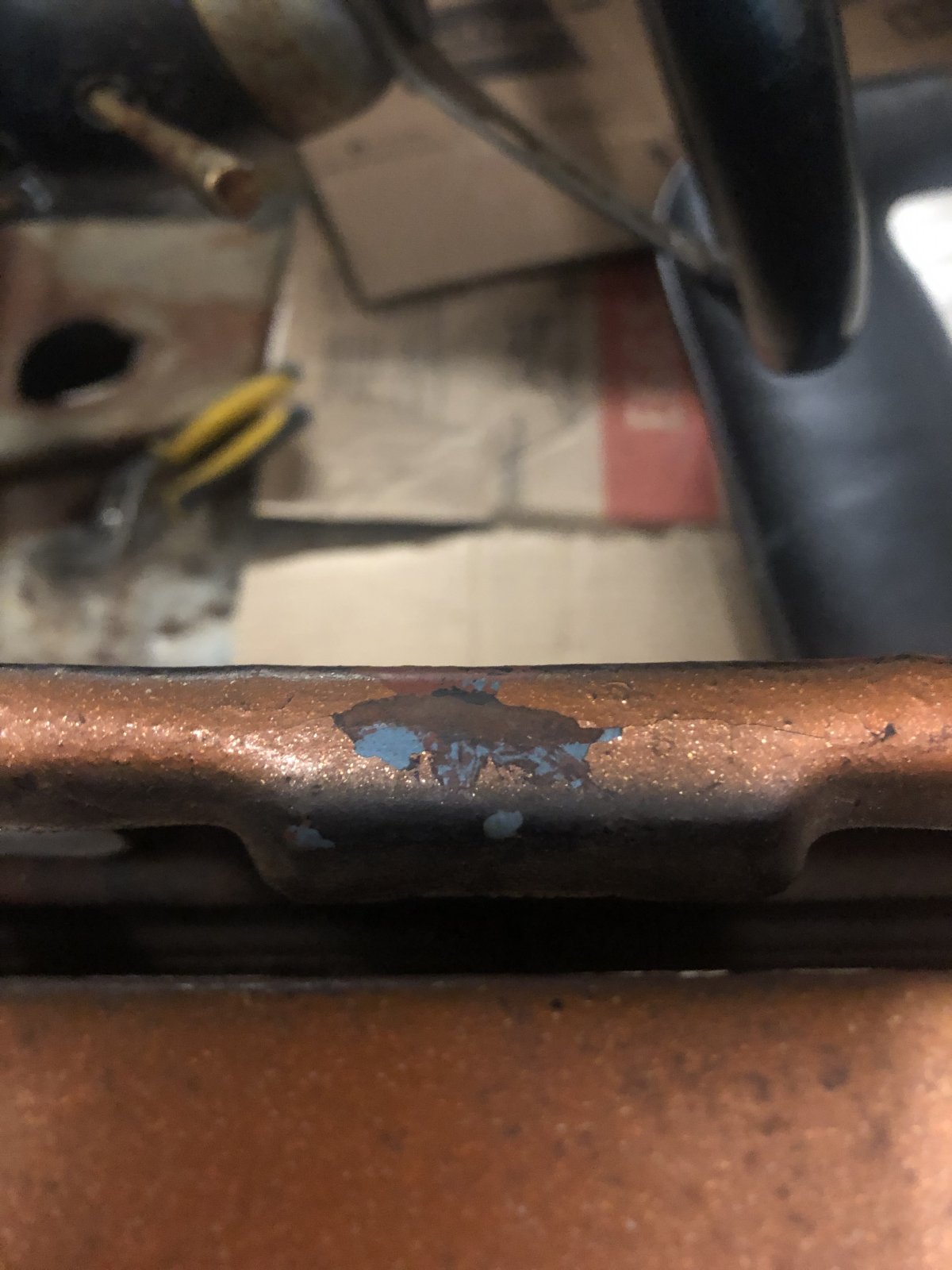

    500D5F88-8964-4AC0-B5D5-22DF2A946A4D.jpeg 2652C30E-9044-4ACA-9507-38462B04DEDC.jpeg 929A5F6E-E3DF-45BD-BBAD-95A5B5070155.jpeg 247CFDC4-C037-43D9-989A-34EA8BAE3352.jpeg B04D3C2A-6B7B-4910-BA60-3F41F80AB6BB.jpeg 7F4DF875-8398-4BBD-B5BA-3018B80616DC.jpeg 380FB120-CFE2-499F-A301-E3CF734592F2.jpeg These pictures help show some of the different colors on this coupe. Looks like dark blue body, and red frame. Both appear to be metallic. Maybe a lighter blue on the door? Some silver accents on frame as well. Whole frame could have been silver as well.
    The engine was Pontiac blue, and before that Gold and Red.
