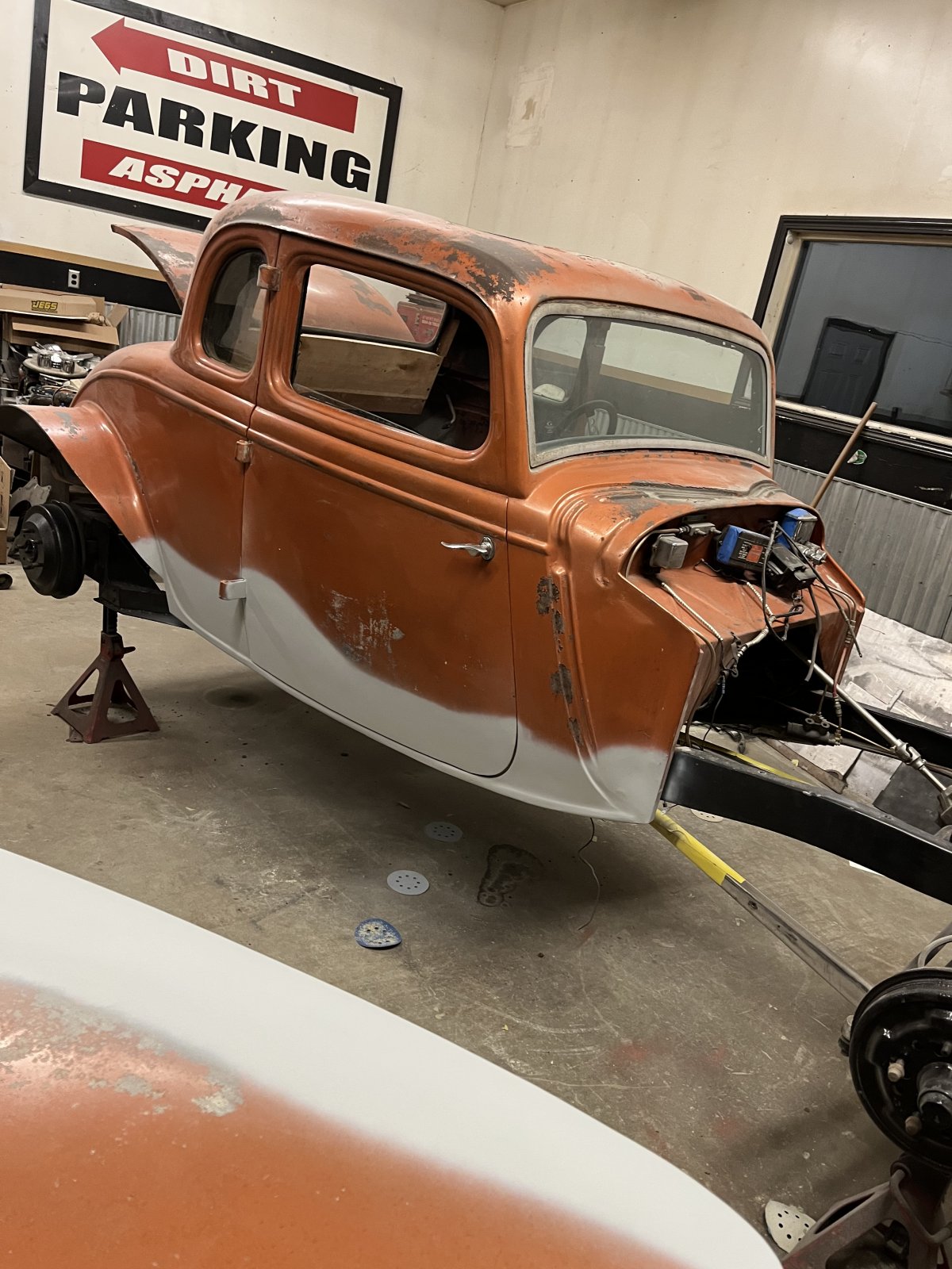

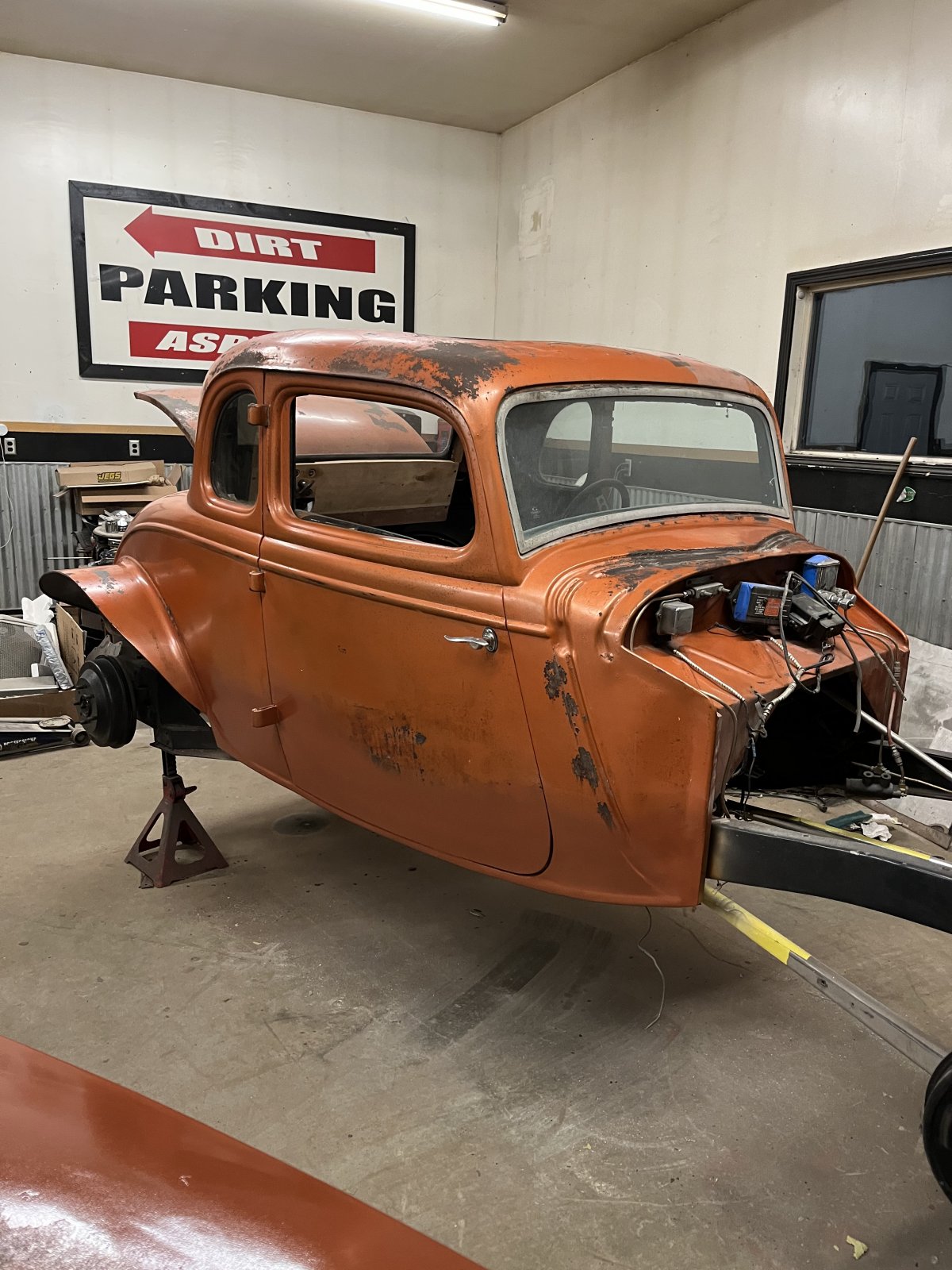

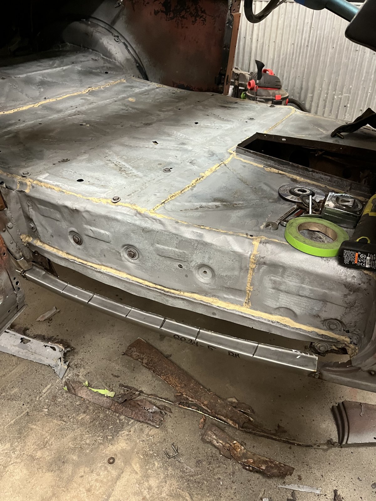

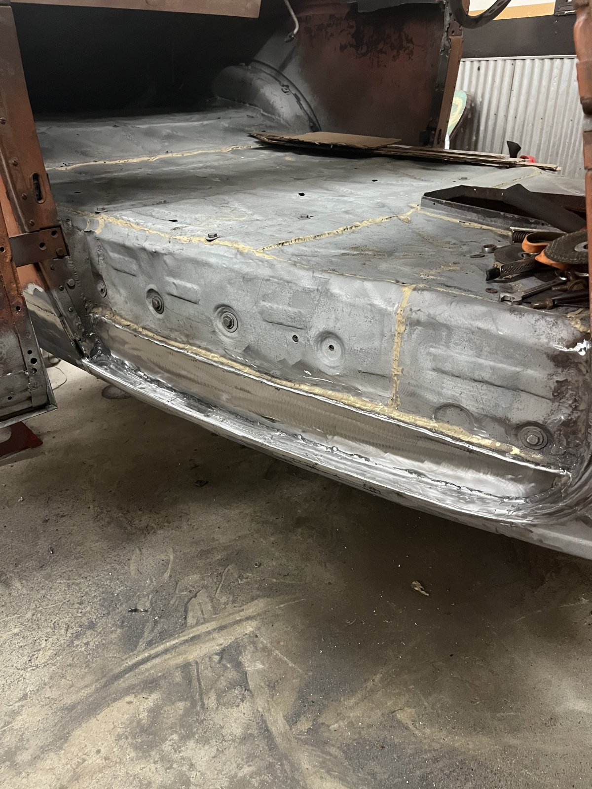

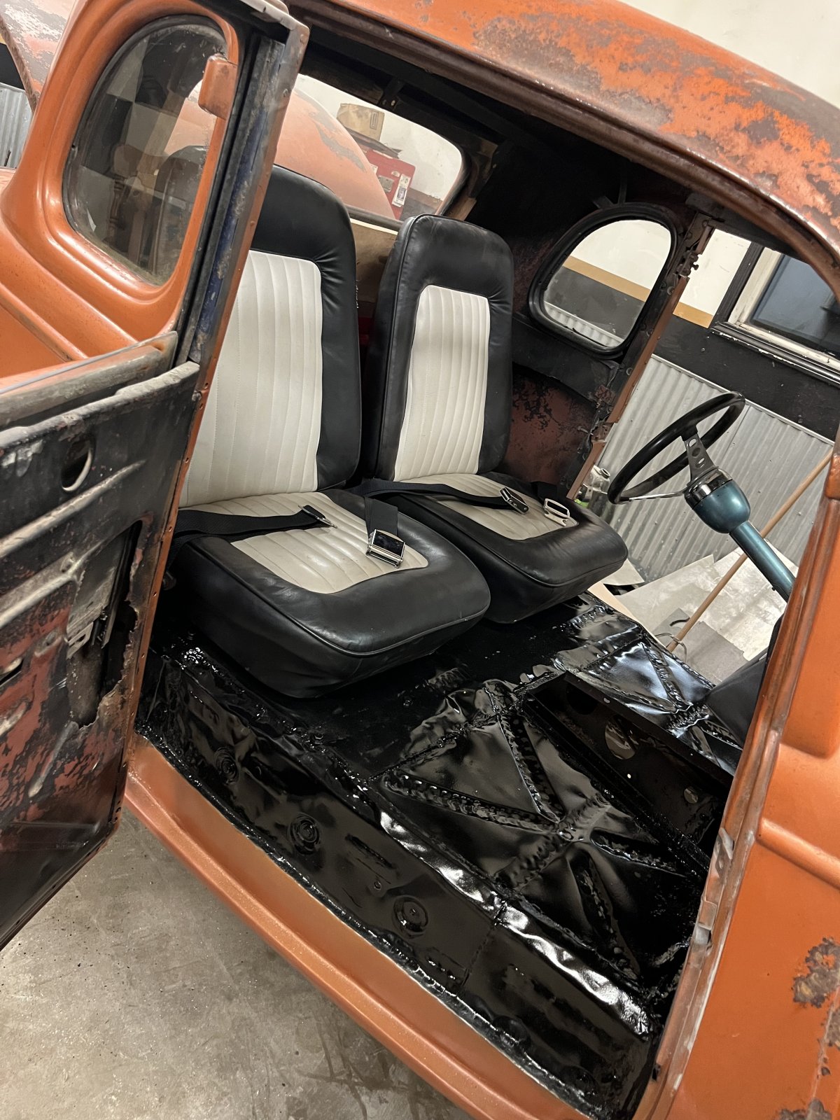

    Some more progress…
    Rockers were a challenge. Where the rockers met the rest of the body had 4 layers of sheet metal. It seems like they channeled it once, then channeled it again, then unchanneled the front of the car an inch.
    I tried to leave as much of the brazing as I could. I thought about getting rid of that bump out half way between rocker and top of floor, but after going back and forth i decided to make it how it was back then.
    I originally used a rear quarter patch from SAR, but it was terrible quality, so I cut it back out and used a panel made by Don Smart. I guess the guy is a nut… But his panels are so much better then the other junk repop ones out there.
    D672E635-3F59-489F-990B-DA33B3AA9460.jpeg 3BB51875-2A00-428E-A49E-99AE596D6447.jpeg EE377101-892A-4268-A30E-7AF8E109E5AB.jpeg 97D13C3E-E0A7-4B03-A98A-71BB43D5749B.jpeg

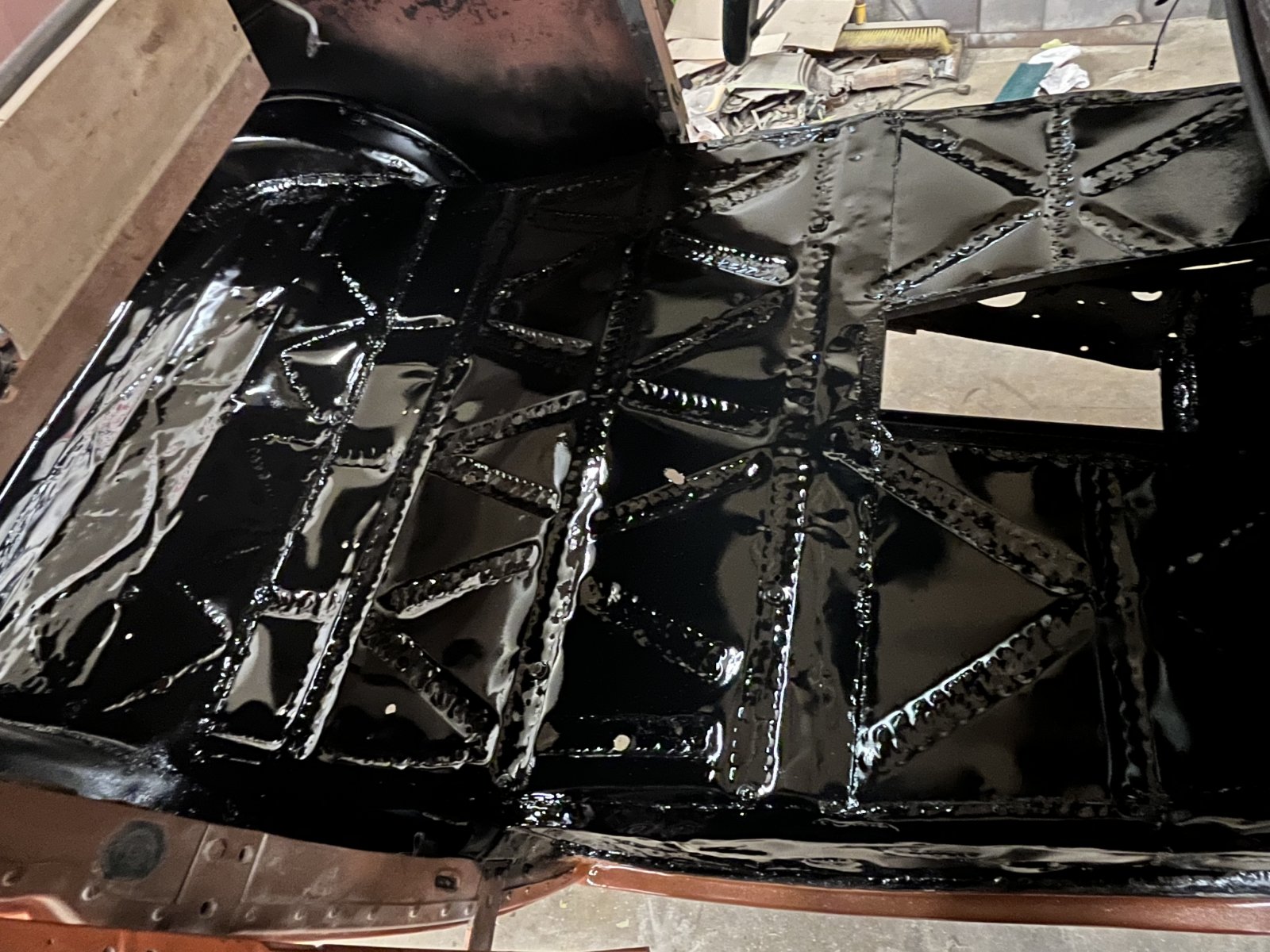

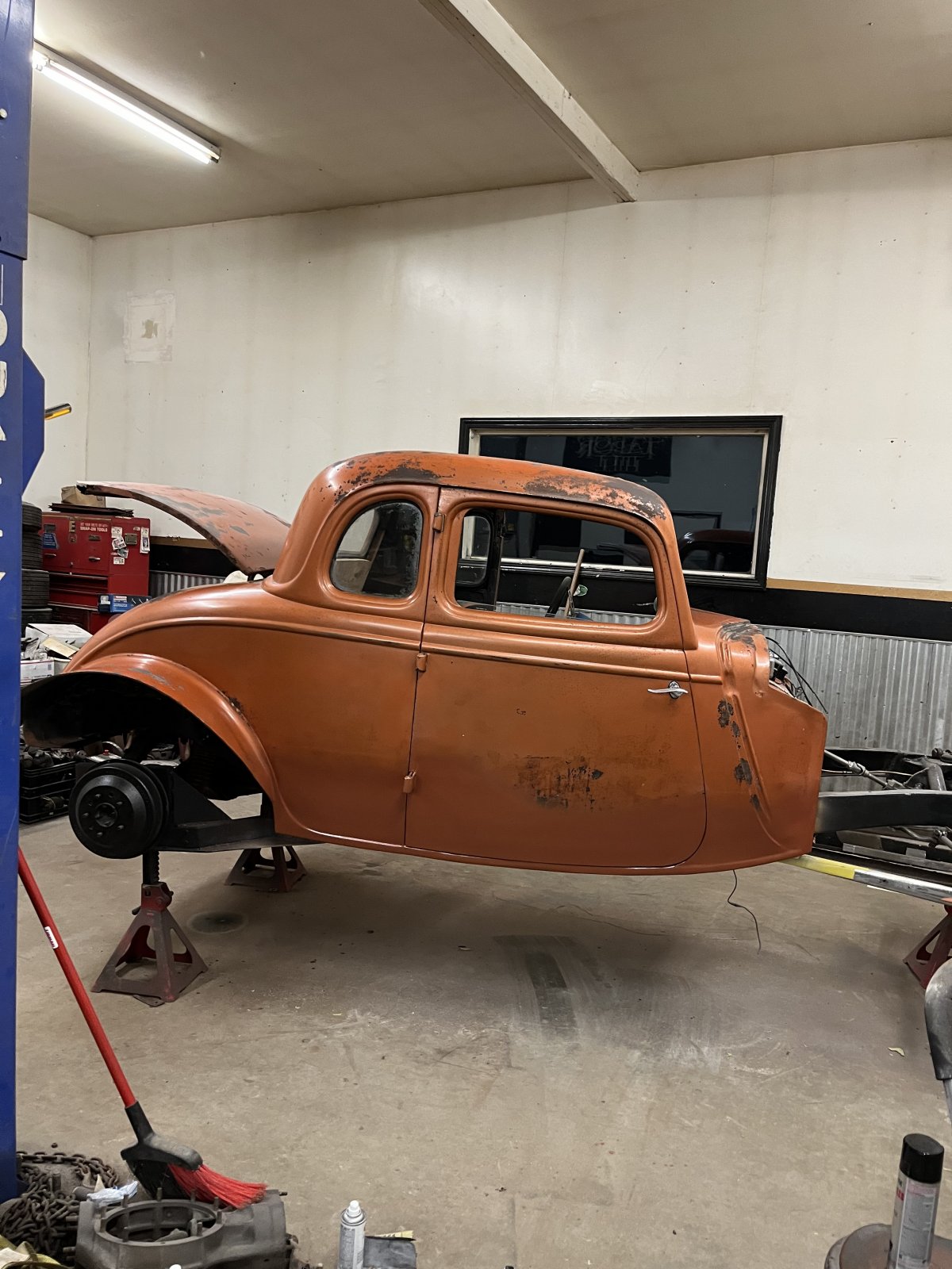

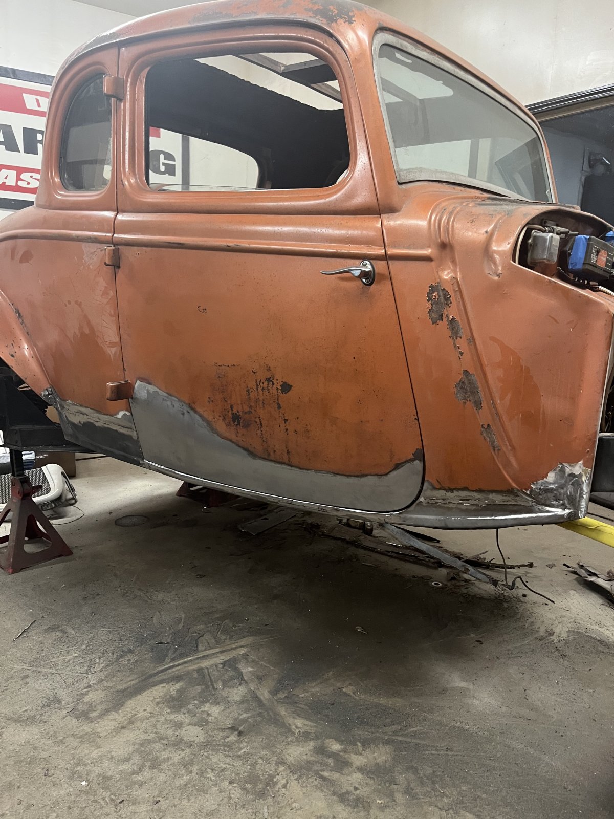

    A lot more progress, haven’t had much free time to update!
    Finished the body work, not perfect, but good enough for a brazed together car channeled 7”. Got so busy I forgot to take any pics of the p***enger side being fixed!
    Paint match wasn’t exact but it’s OK for now
    443A5D56-E522-4311-846D-089DDE644E22.jpeg 46AA3E22-E23D-4A2A-A792-DD9E07A1EE30.jpeg 8775157B-31E3-407A-AE53-C40DCCE0C872.jpeg 41E40E5E-AA33-495E-9C3E-F54A2B9E390E.jpeg FDFFC3FF-912C-4983-BA65-15A3003E99C9.jpeg 55E84BC7-9BE9-4B46-8540-15B71ECE7153.jpeg

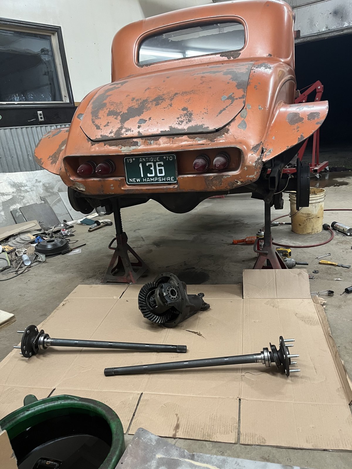

    Also went through the ‘64 Pontiac 9.3 rear end. Has 3.42 gears and Posi. Everything looked good, but put in in axle bearings, seals, and gaskets.

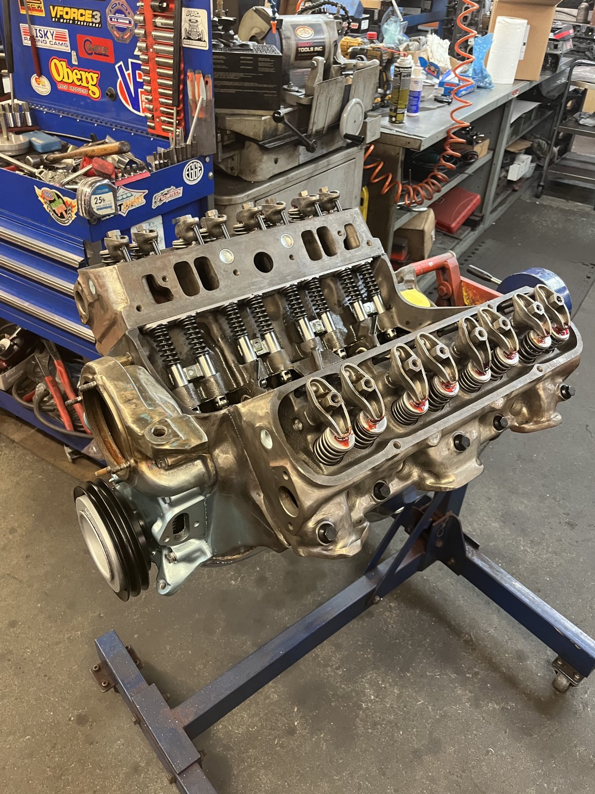

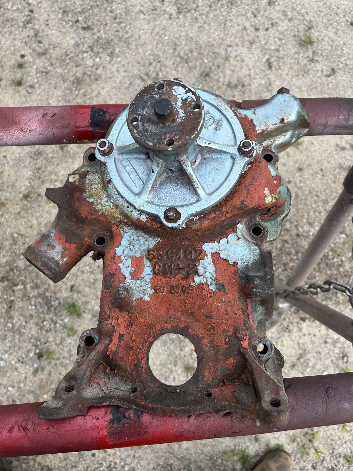

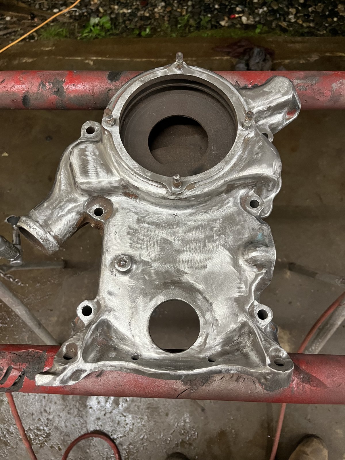

    “Polished” the timing cover for the Poncho.

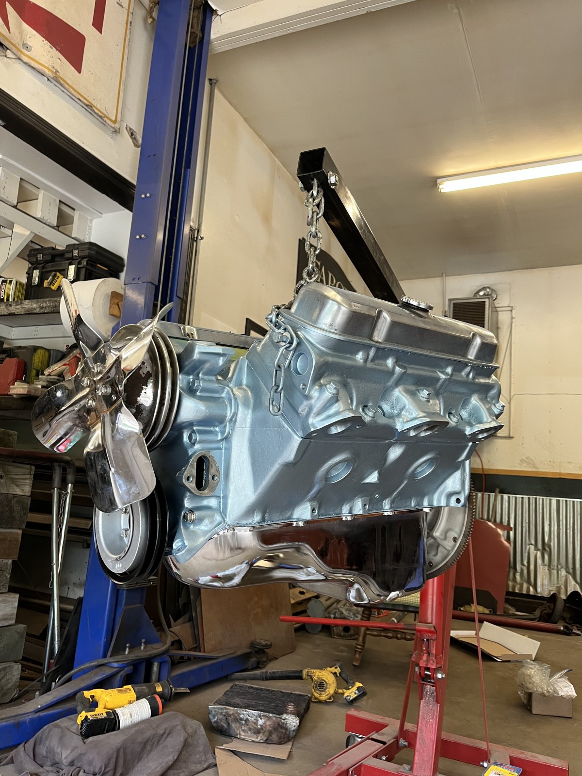

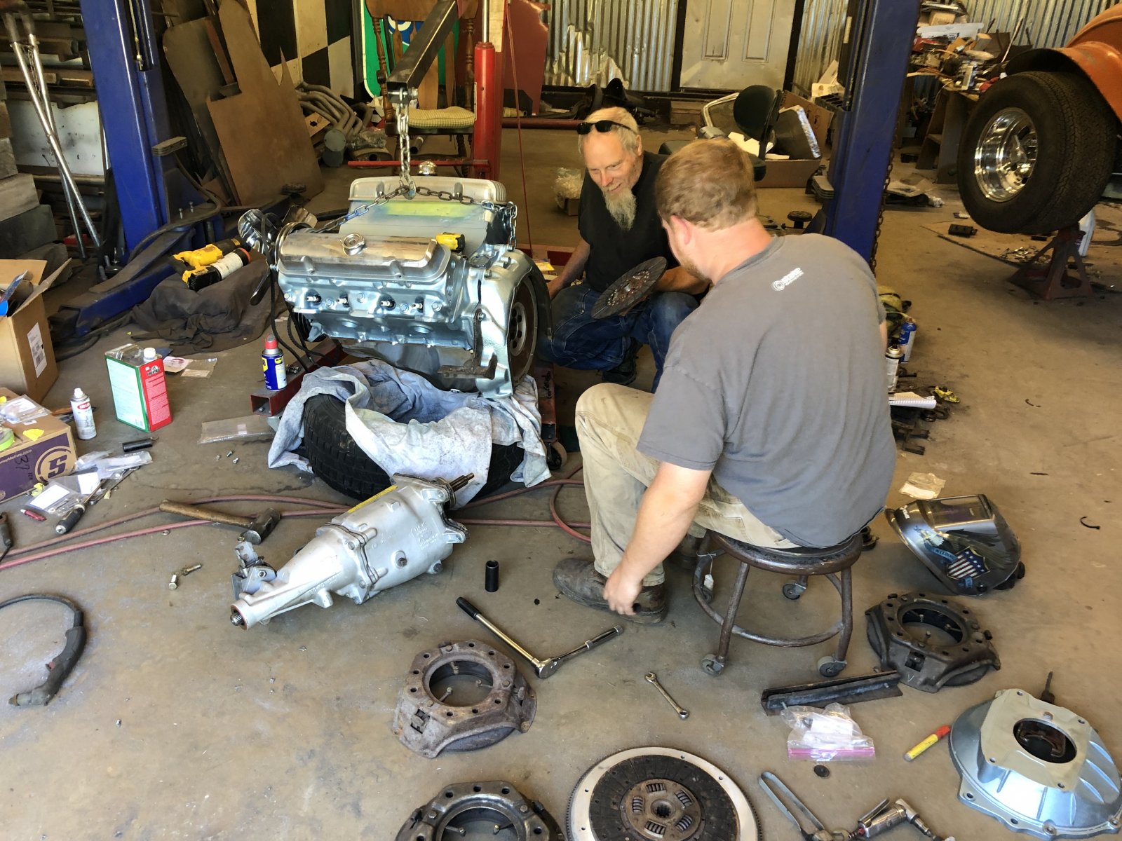

    So engine had been as machine shop for about 6 months, started to get nervous. Want to have the coupe up at Pinetree jamboree in Winterport Maine. So I start buggin em. In the beginning, they said machine work only. Not enough help to ***emble. Then I managed to talk em into doing a short block. Then I guess they changed their mind 2 weeks ago, and put the long block together for me. Maybe having my girlfriend bring donuts for the guys when dropping off parts helped? I’m just glad they ***embled it, this thing has been a challenge for them and me!
    So picked engine up last Friday at the end of the day, and I’ve been working non stop. Got hung up using a repop Flathead pressure plate. The “fingers” didn’t retract enough when torqued down on the flywheel. Luckily I had a spare 11” pressure plate (actually 3!) and got the motor set in on Sunday with the help of @rust abd his girlfriend Gabby!

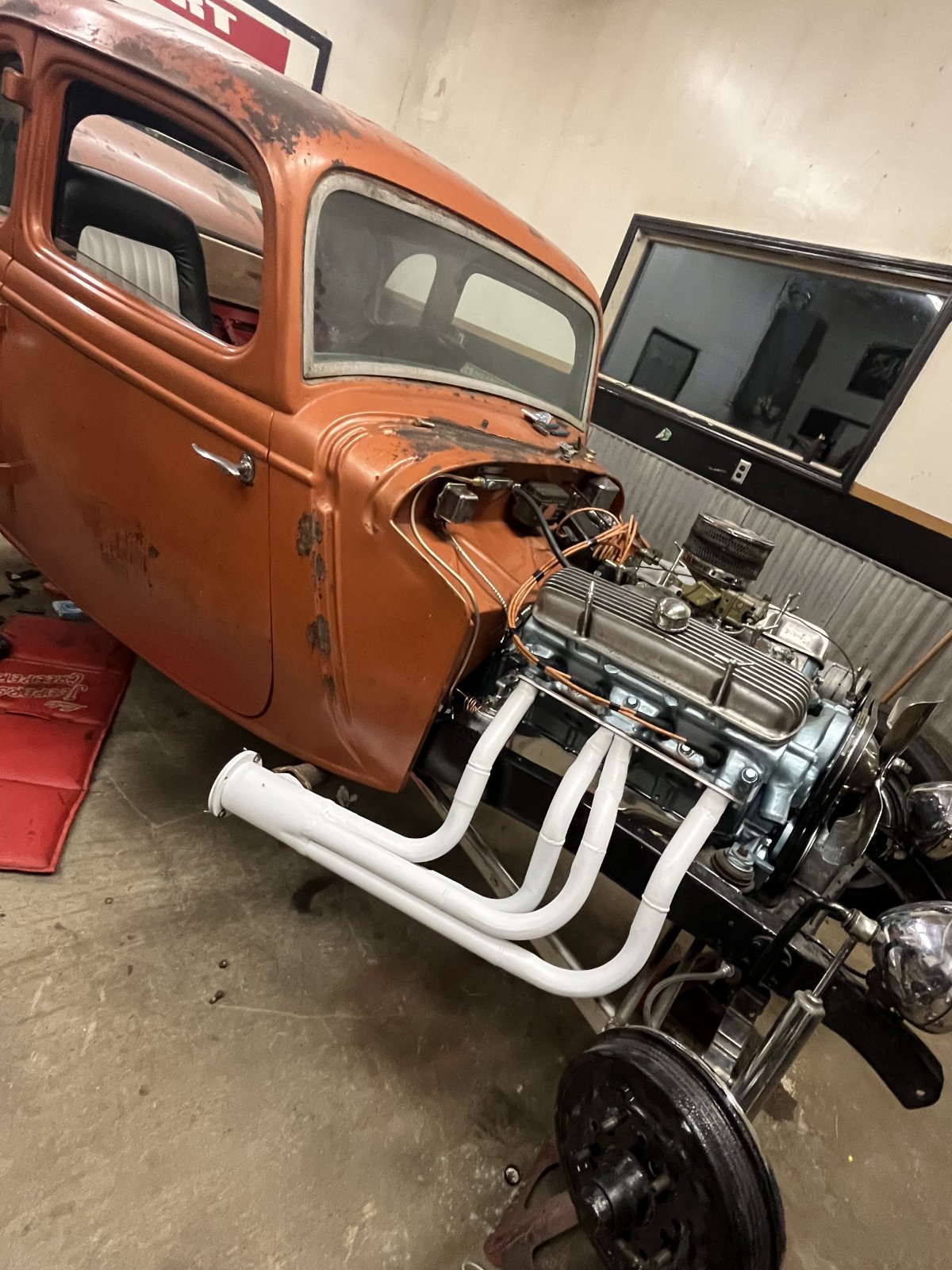

    Another update….

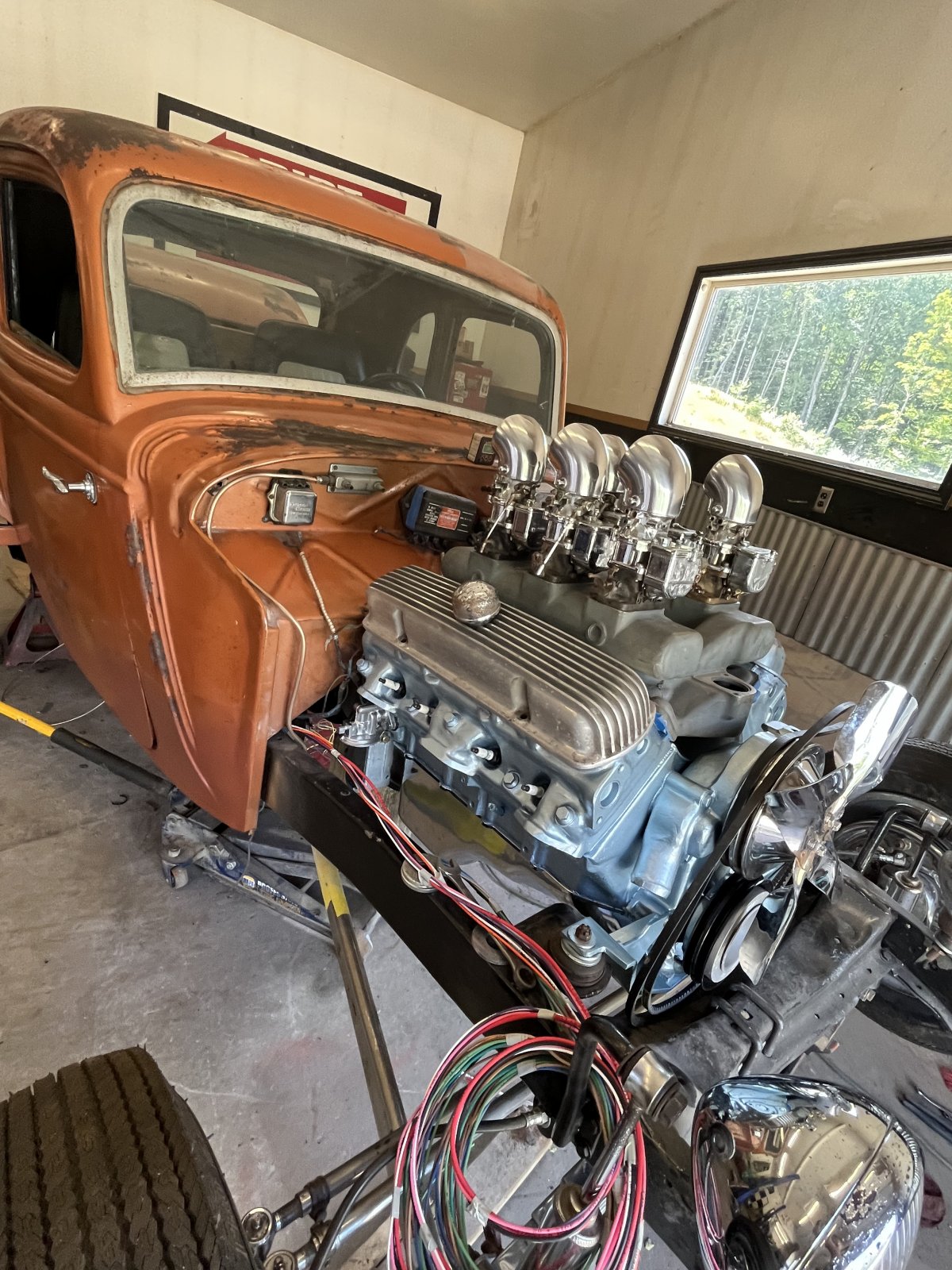

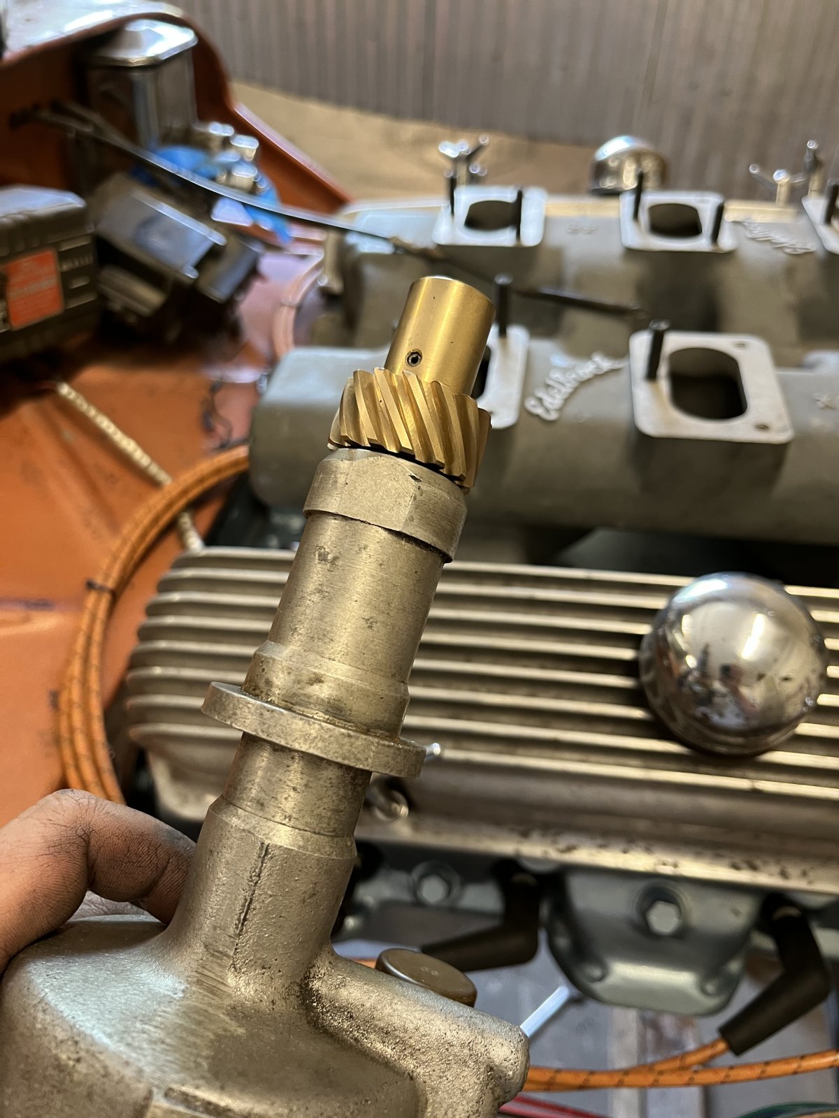

    Well the Pontiac is officially running! I stuck a stock intake and a rebuilt Holley 500 2 barrel on it that I had laying around, and after advancing the distributor a little, it fired right up! Sounds mean!
    Unfortunately though I have no idea how to upload a video!

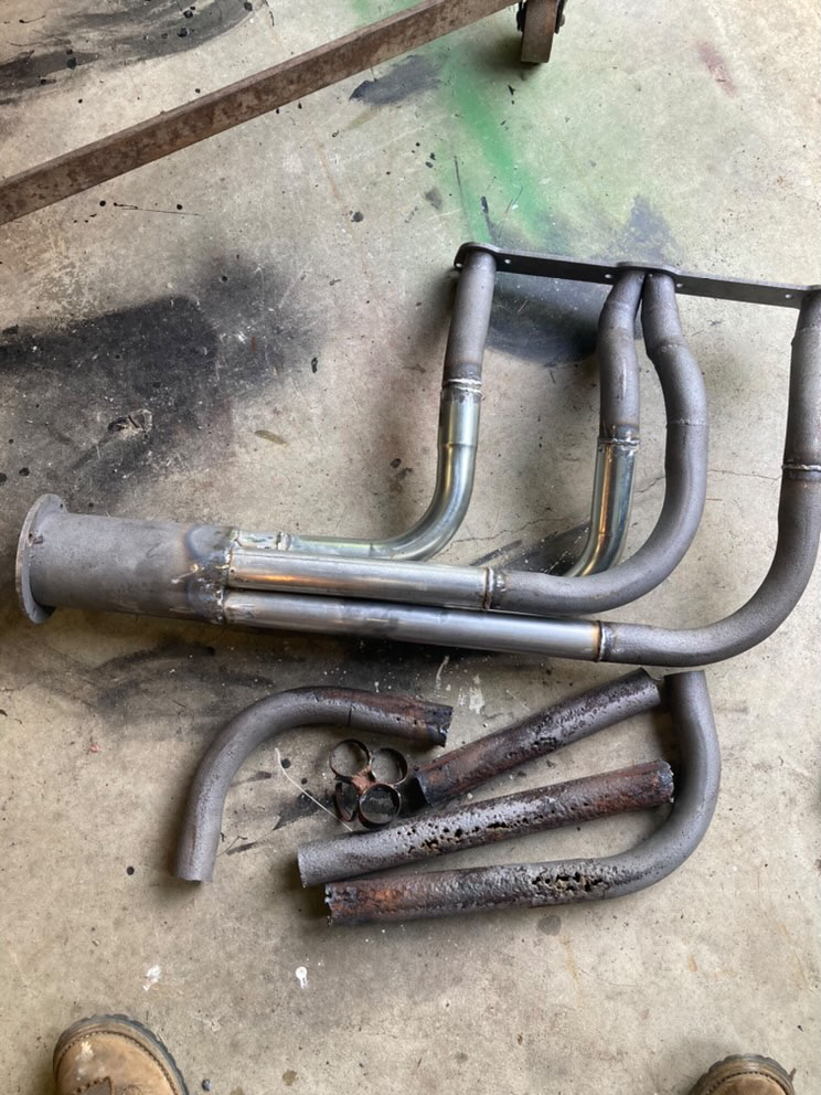

    But here’s some pics of the header rebuild that my friend Tom Clarke did:
    1843FEEB-9402-493C-B24B-47D990190E2F.jpeg E58382EA-F966-4DEF-9A5D-8538231A68FA.jpeg

    That's a milestone for a big thumbs up...congrats...I was gonna say that's got to be loud and I'm sure it is but I see a side exhaust on the frame side of the collector... looking good...;)

    Thanks Stogy! Yes they end up going under the car… I’m using some Porter mufflers, man those things are nice! Then they exit the back through scavenger pipes with chrome, flared ends.
    Thanks! Yea I definitely wanted to keep them on the car… I hope the white fades a little, but that’s what they were originally and it was definitely the trend at the time.
    Because that’s what GM did. Late 50’s GMC trucks had Pontiac engines, with Ford/Long style pressure plates. The old Trans-Dapt catalog specified Ford pressure plate, Chevy clutch disc, and GMC throwout bearing to make this combo work with their trans adapter.

    That's awesome you were able to salvage the original headers, Thay look great!

    Yes I was happy to be able to reuse them! Can’t exactly go find another set on Speedway!

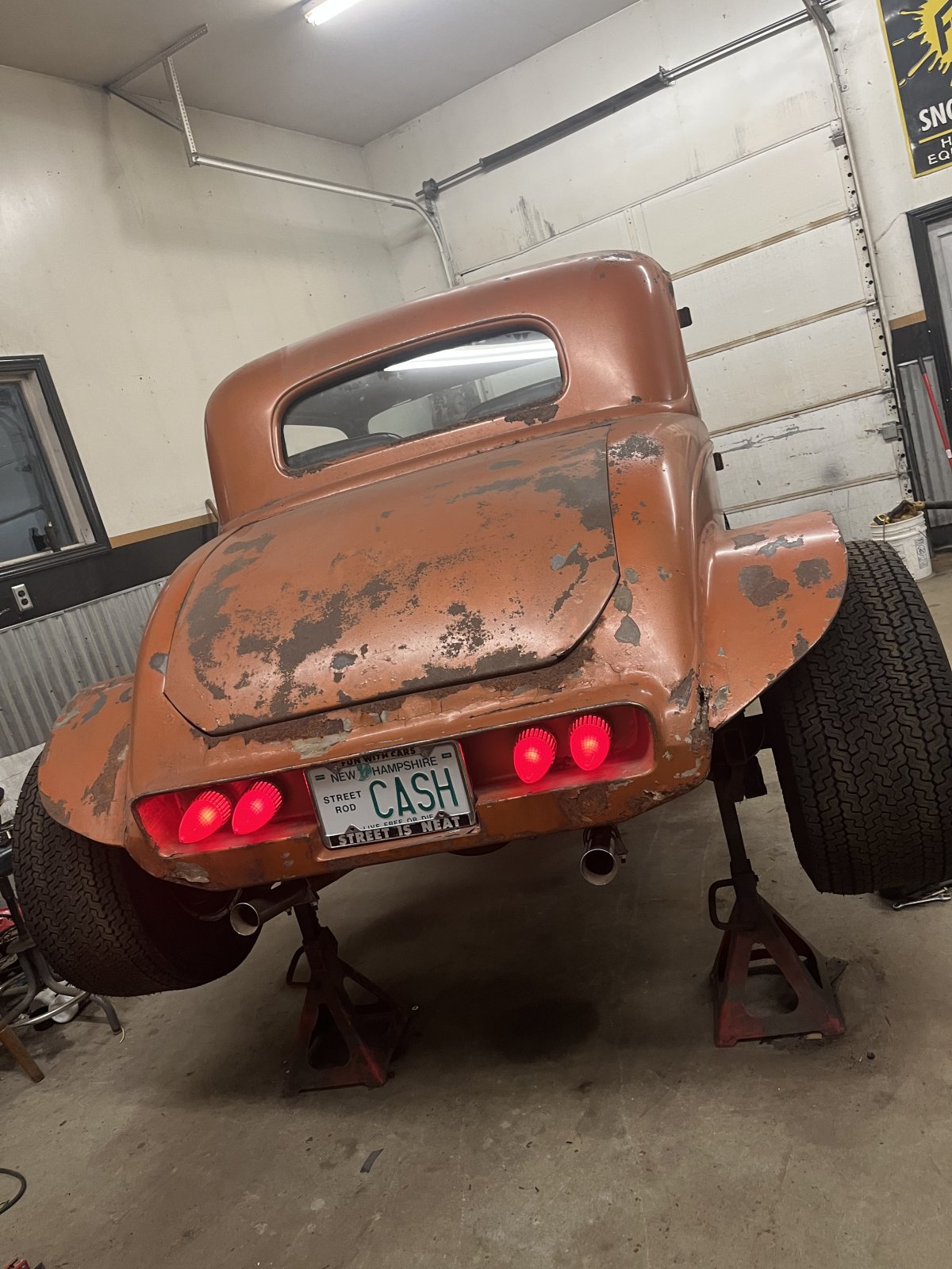

    I got ahead of myself, and skipped over some other progress….
    After 3 trips (two in same day) to the State of NH DOT main office, I was finally able to finish registering it. The first two trips down there were a nightmare. The head lady didn’t know squat about the Street Rod plates, and had a fit that I knew more. Left me waiting in the lobby for 45 minutes, and after interrogating me on the car, finally said that my street rod certification was valid. There was another laundry list of other reasons they wouldn’t finish the registration, and I ended up leaving quite unhappy after I went home, made a trip back to my town office, and then back to the DMV to be turned down again. Ever heard of a bill of sale being rejected because it was two different colors of ink?
    So I waited a couple months and then tried my luck again. I waited maybe 5 minutes to talk to a much more pleasant woman who couldn’t have cared less. She said “Oh wow, haven’t seen one of these in a while” sign, pay, stamp and I was out the door in under 15 minutes. Couldn’t believe it. Finally got my plate after about 6 weeks.
    Need to find a cool old plate light. Maybe one that’s recessed into the body? Old chrome, of course.
    You can also see I’ve got the old chrome scavenger pipes hung back up. I need the re-work the exhaust pipe between the header and the muffler, but then I’ll be ready to take it down off the jackstands!

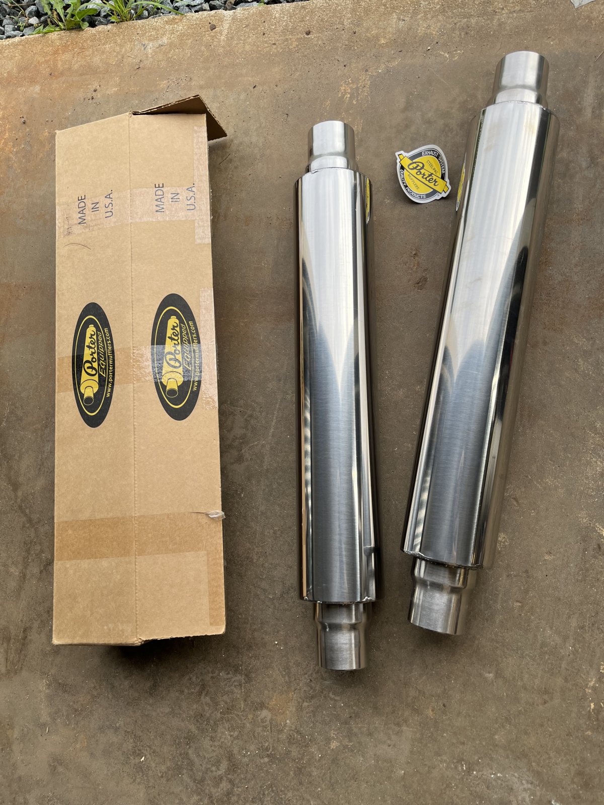

    I ended up using these stainless Porter mufflers….. I’m excited to hear how they sound, but they’re impressive just to look at! By far the nicest mufflers I’ve ever seen… Definitely way too nice for this old gal!

    What is the dimension on those Porters (overall length)
    Shaun1162 likes this.
  29. Shaun1162
    Joined: Feb 22, 2010
    Posts: 973
    Shaun1162
    The overall length is roughly 25 and 1/2”, the body itself is around 20”.
