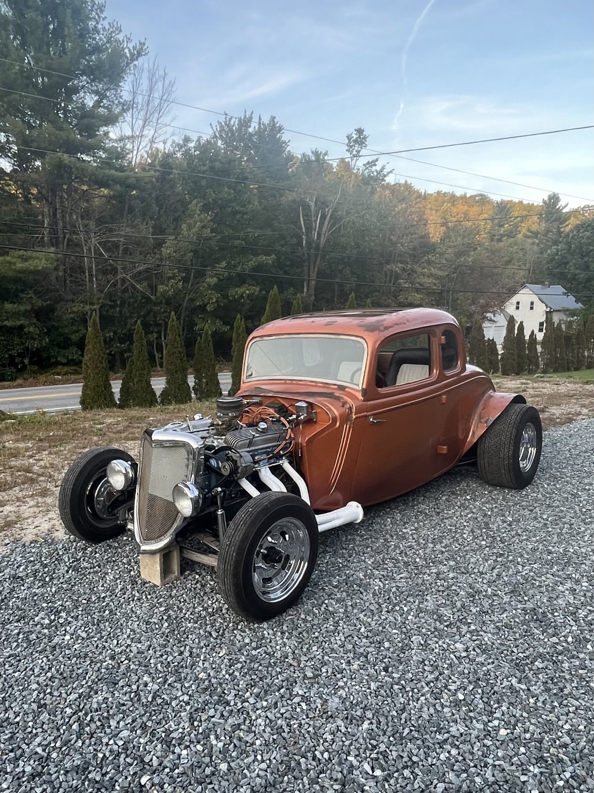

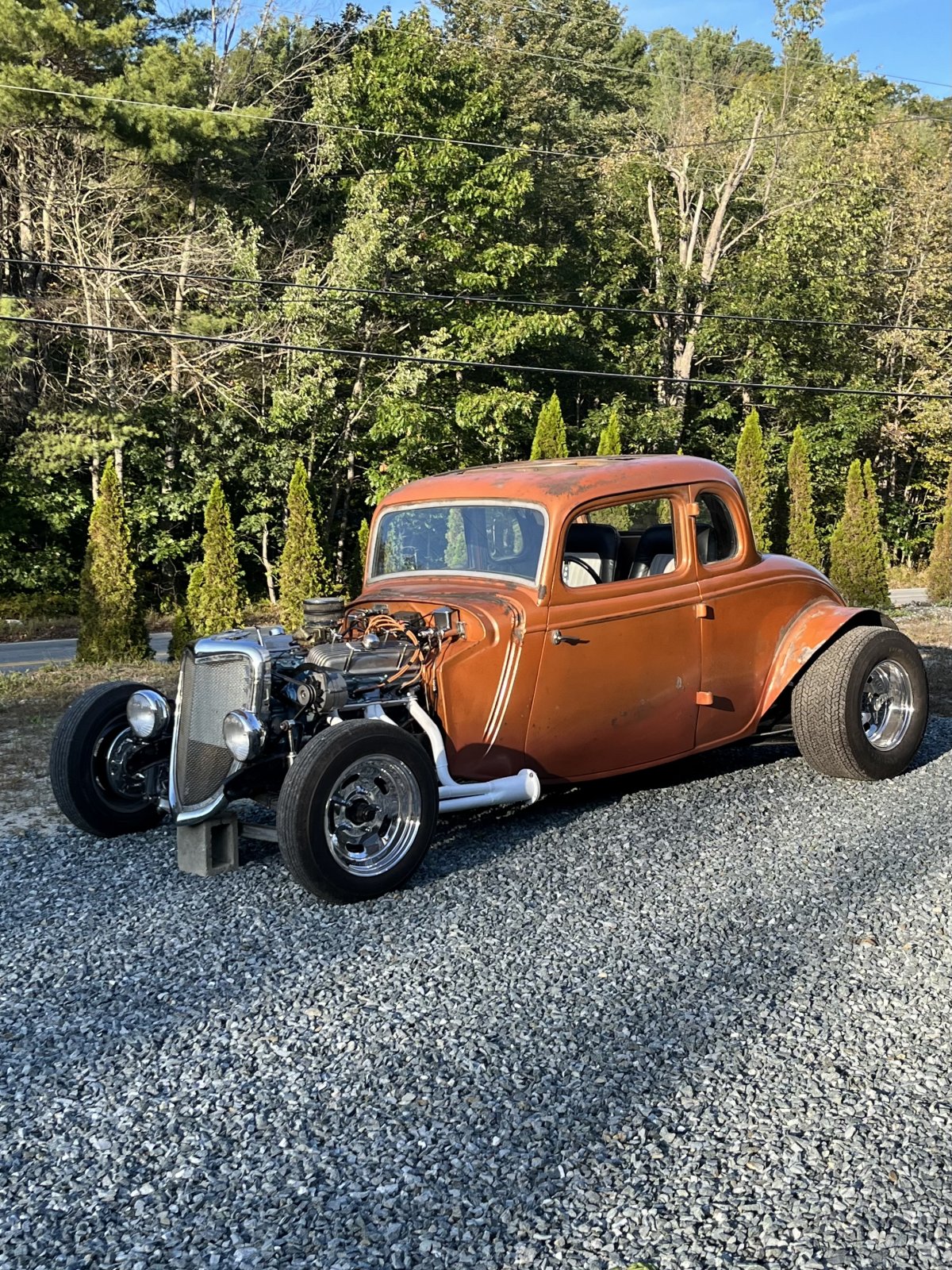

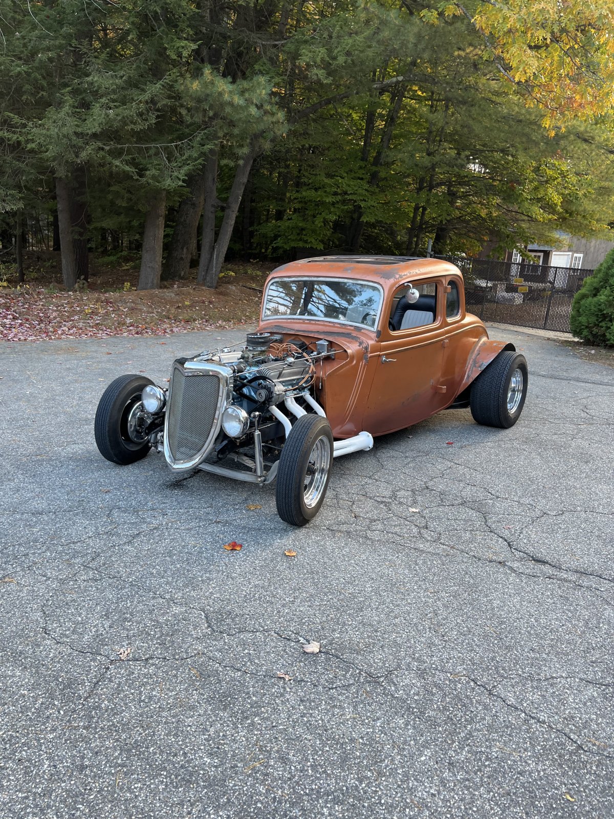

    Look ma, no more blocks under the grille!
    A little under a year and half after acquiring this coupe, I finally got to drive it down the road.
    I decided the other day that I’d waited long enough to drive it, so I told myself I’d get it going for the last local Cars and Coffee event at the WFK Ice House museum in New London, NH.
    I ended up working all night Friday, no sleep, but damn it I did make it!
    Overall it goes down the road pretty well, but I’m fighting clutch slipping, and it’s a little difficult to get into 2nd gear. I think the clutch may have gotten grease on it from the throwout bearing somehow? Hoping I don’t have to pull engine and replace the clutch disc!
    107F1BEE-9274-4CF5-BBEC-F47A01E92C43.jpeg 0B2BC8AA-4C73-457F-AB25-81DFC4AE7856.jpeg 721CF496-C20C-4D95-AC7A-BB1F2475774F.jpeg 765C1E04-FAC5-49D0-A592-21CF5AD5D487.jpeg C85FE349-D409-4FD4-AA85-A06D4E9259CD.jpeg 5DA029E0-B0DA-493F-B19D-3E218920FF3C.jpeg

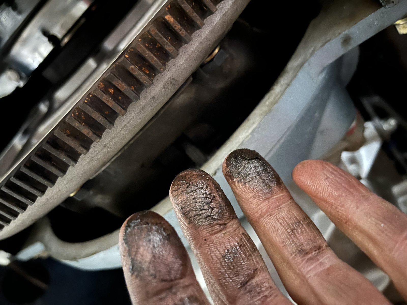

    Lots of reasons for clutch slippage. If you just reached in the clutch housing itself and wiped your fingers on the inside, not really a valid test IMO. My clutch housing gets loaded with stuff and will make your fingers black for days, and the clutch itself is dry. It could just be worn quite a bit and a weak pressure plate too. Some oily residue can be off the rear main and just get whipped around in there, but not necessarily make it to the clutch surface itself.
    Either way, great job on getting it back on the road. I would personally be putting a new clutch for piece of mind in it over the winter.....and checking that the rear main isn't leaking.

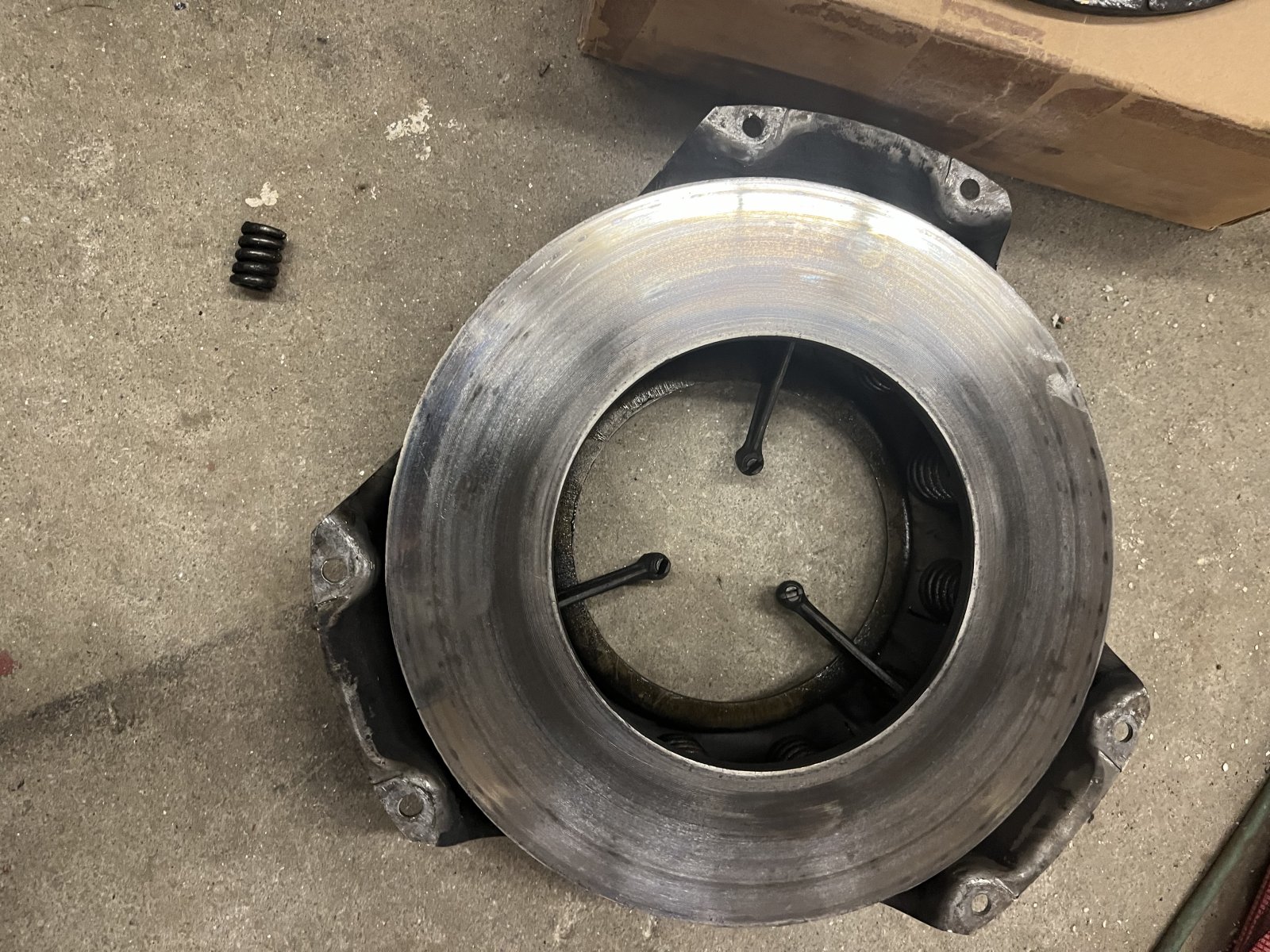

    Been doing a bunch of trouble shooting, and @rust came over and checked it out. After trying about everything in the book, it seems the pressure plate just isn’t up to the task. It was a used Flathead one I had kicking around, so I’m not entirely sure of the history. The new pressure plate I bought from Mac’s didn’t fit worth a ****. The bolt holes were 3/8 instead of the standard 5/16, and the release fingers were much higher and messed up everything when ***embling.
    I’ve ordered a new Ram street/strip pressure plate. I guess a stock Flathead pressure plate designed for 110 HP and skinny tires isn’t quite up to 350+ HP in a 2,000 pound car, with 13” wide tires… and Posi

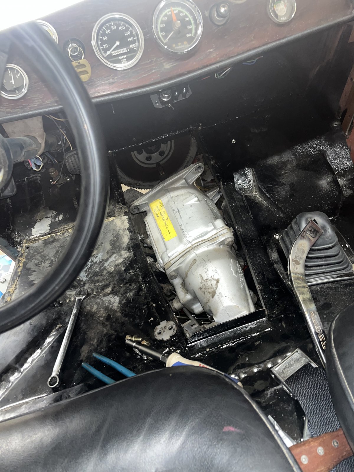

  21. Shaun1162
    Joined: Feb 22, 2010
    Posts: 973
    Shaun1162

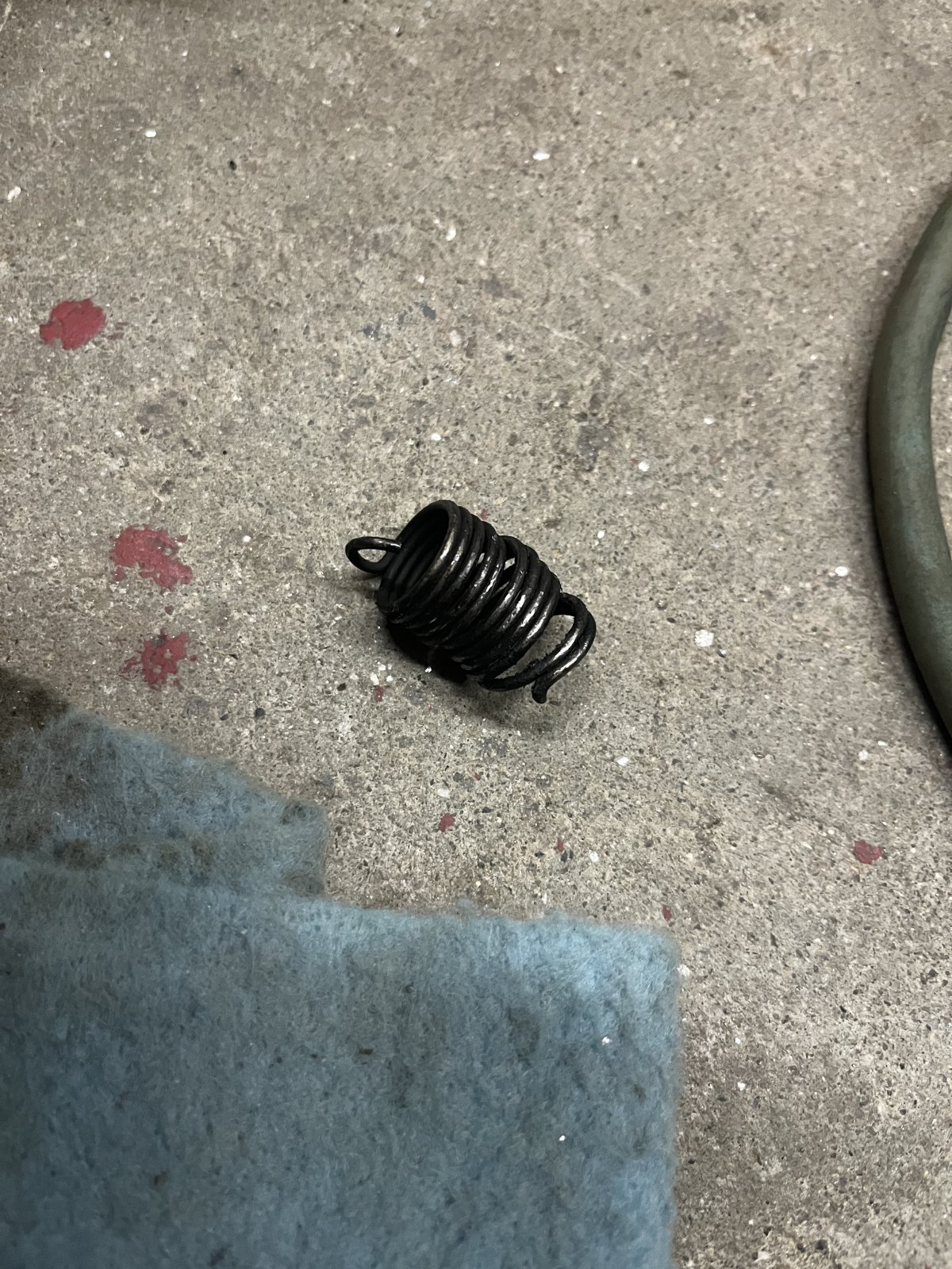

    So I managed to fix the clutch slipping issue. New Ram street/strip pressure plate took care of that. I found two stray springs when taking out the trans. I believe they were wedged into the pressure plate, leaving it partly engaged when it was ***embled and making everything seem kosher. The problem occurred when the springs fell out, the pressure plate was able to disengage fully and ran into the throwout bearing.
    6436AD2F-1B3C-485D-8287-C762694B0DBD.jpeg 29E3B5DA-4474-4A32-977B-CCF51EDF0AA6.jpeg A2AA14DA-A8FD-481D-8304-FA4445A95F29.jpeg

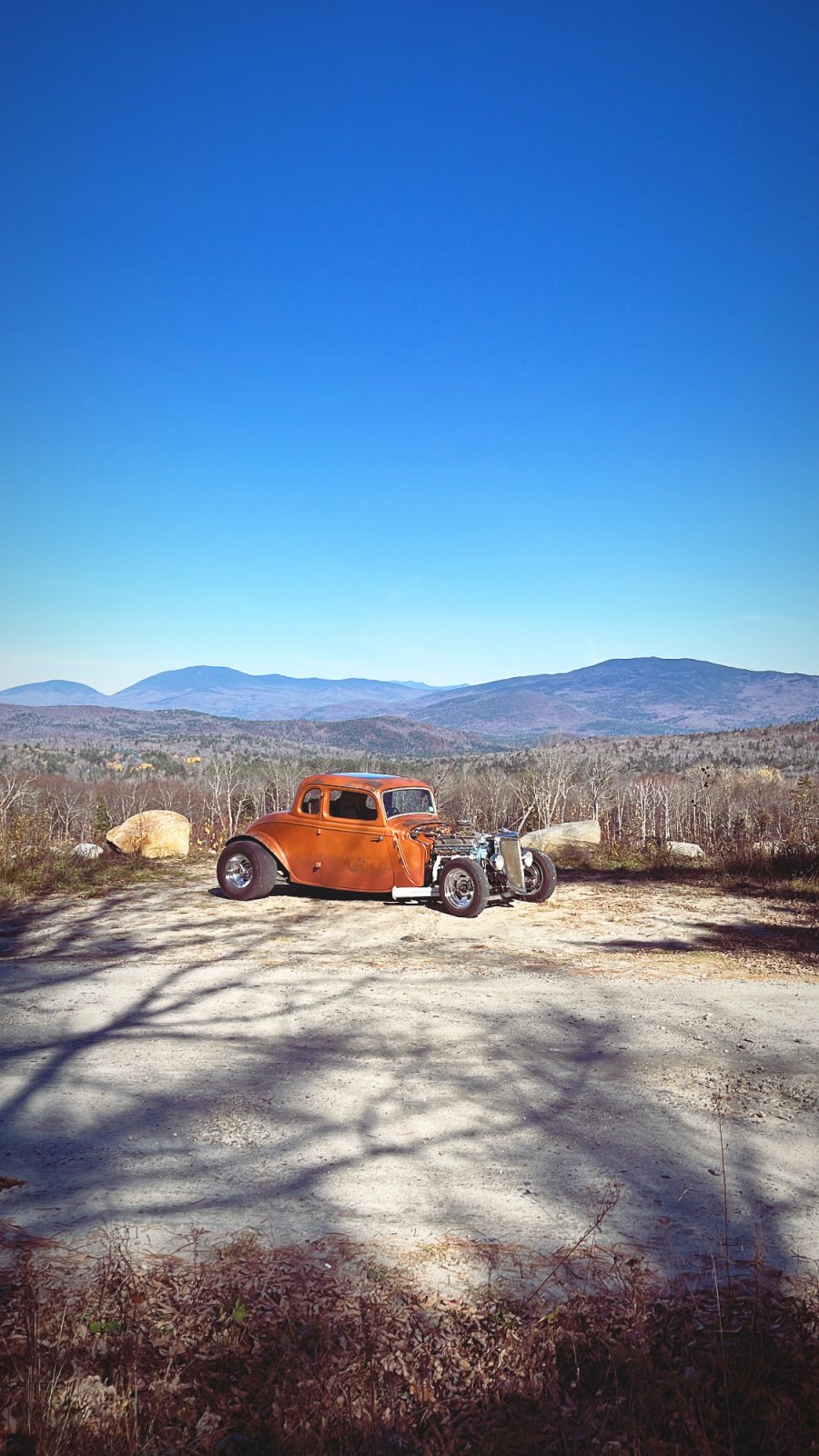

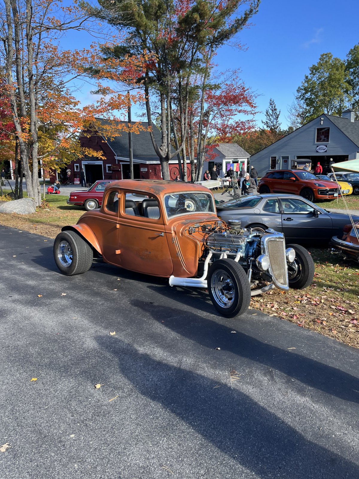

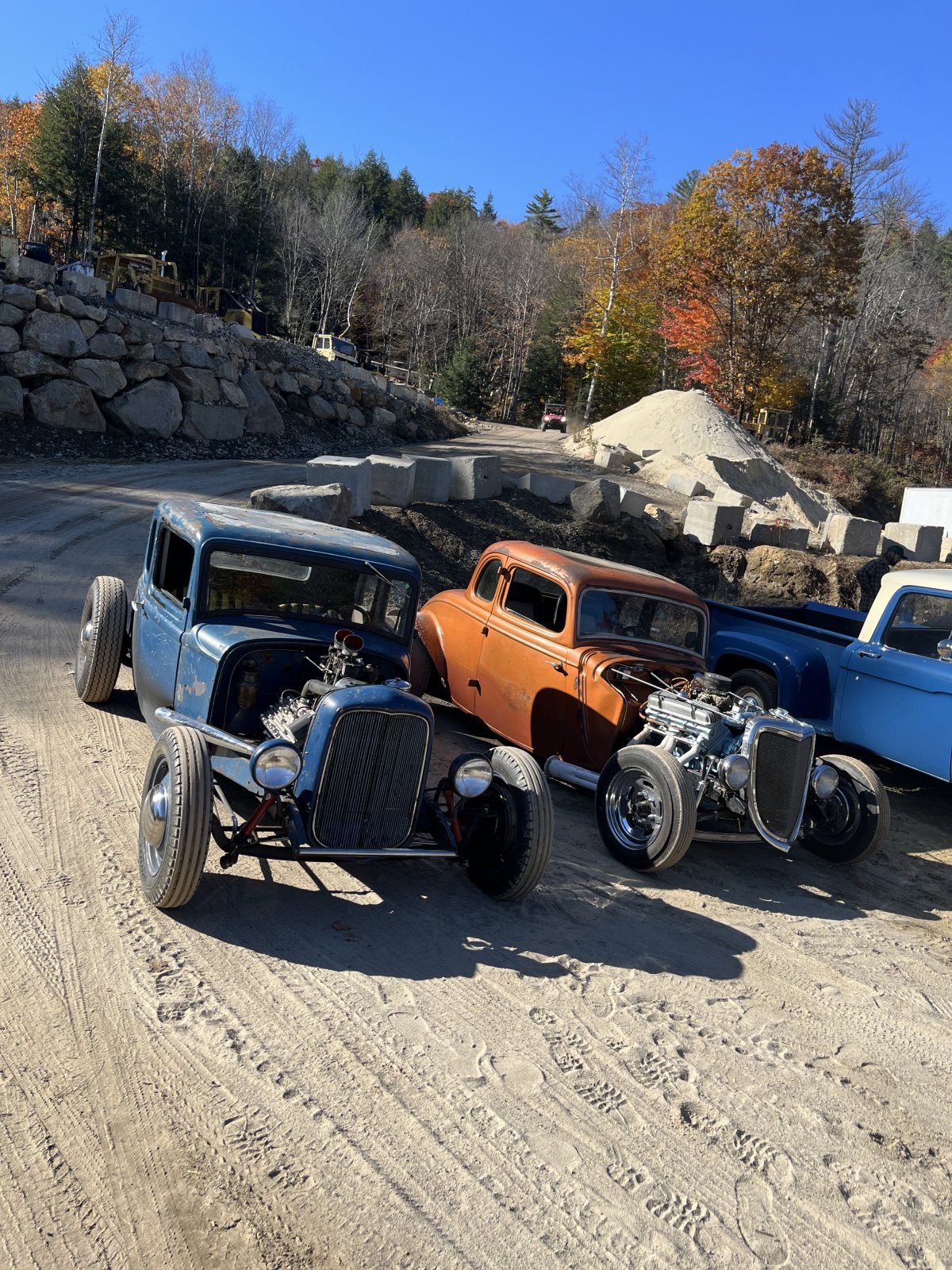

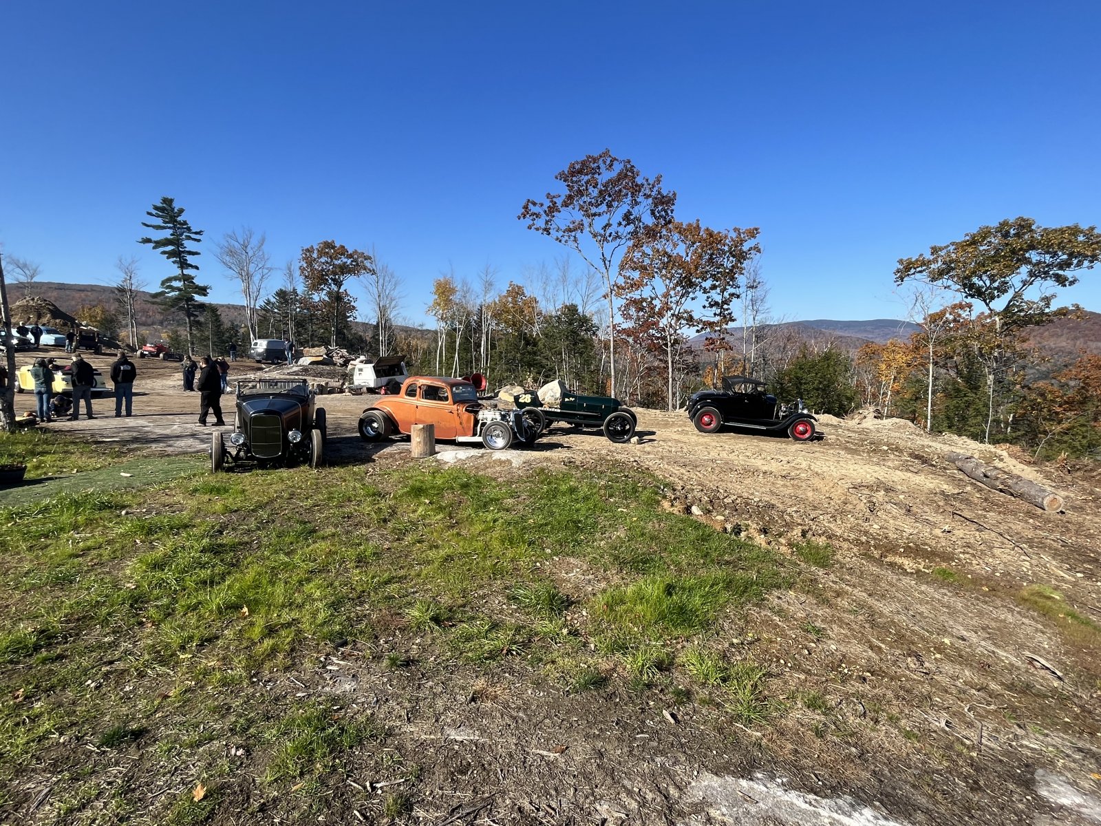

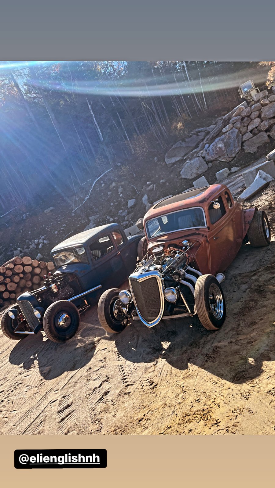

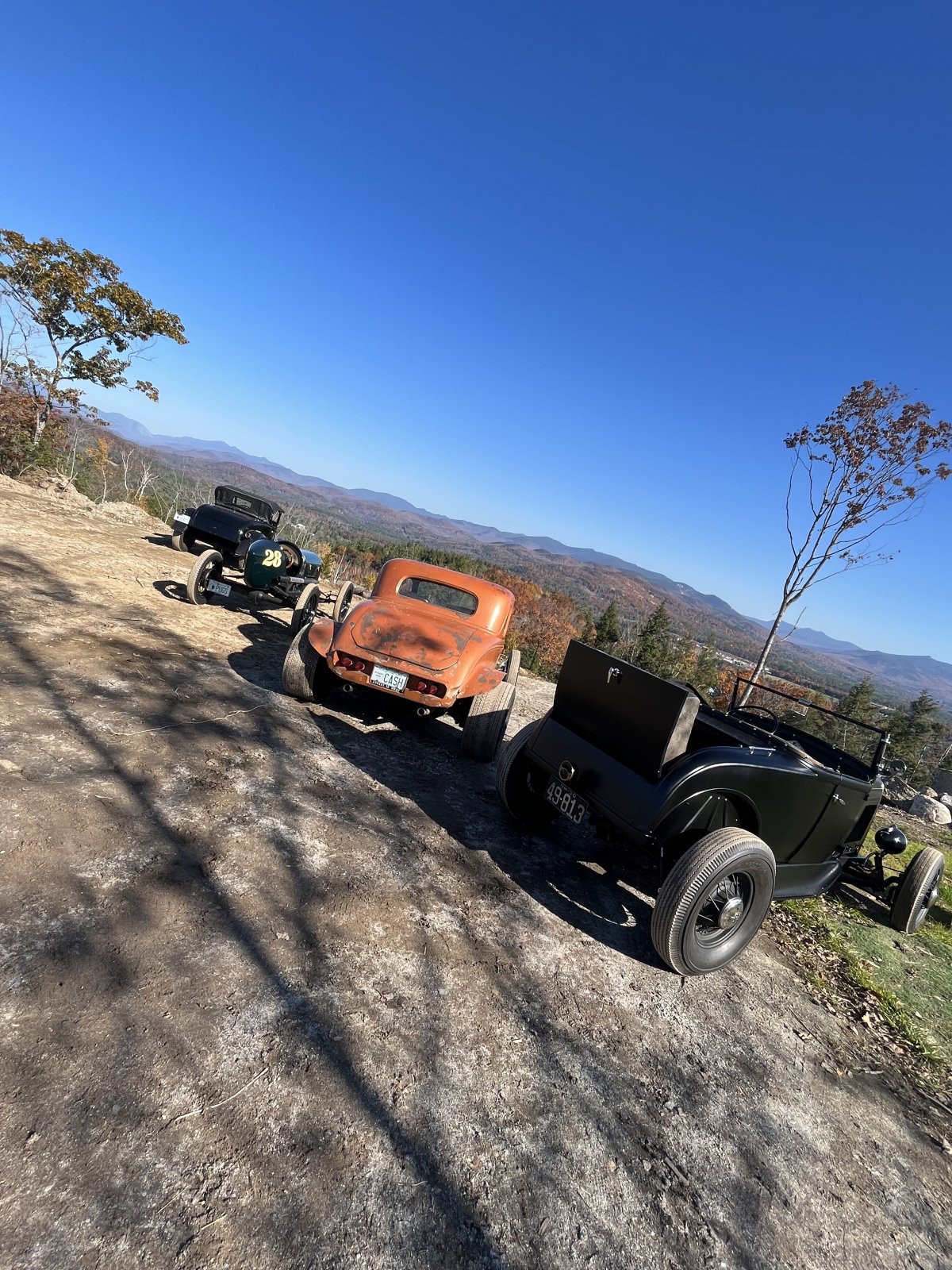

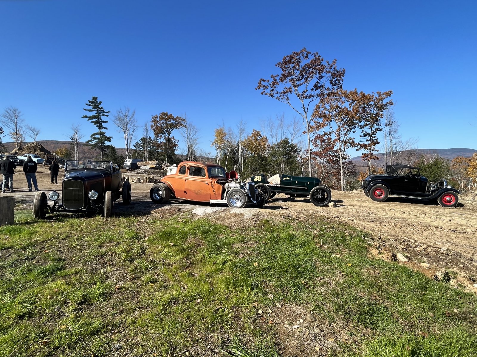

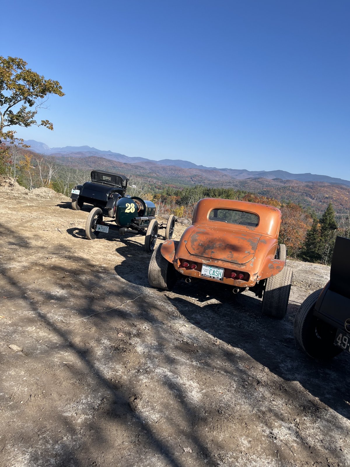

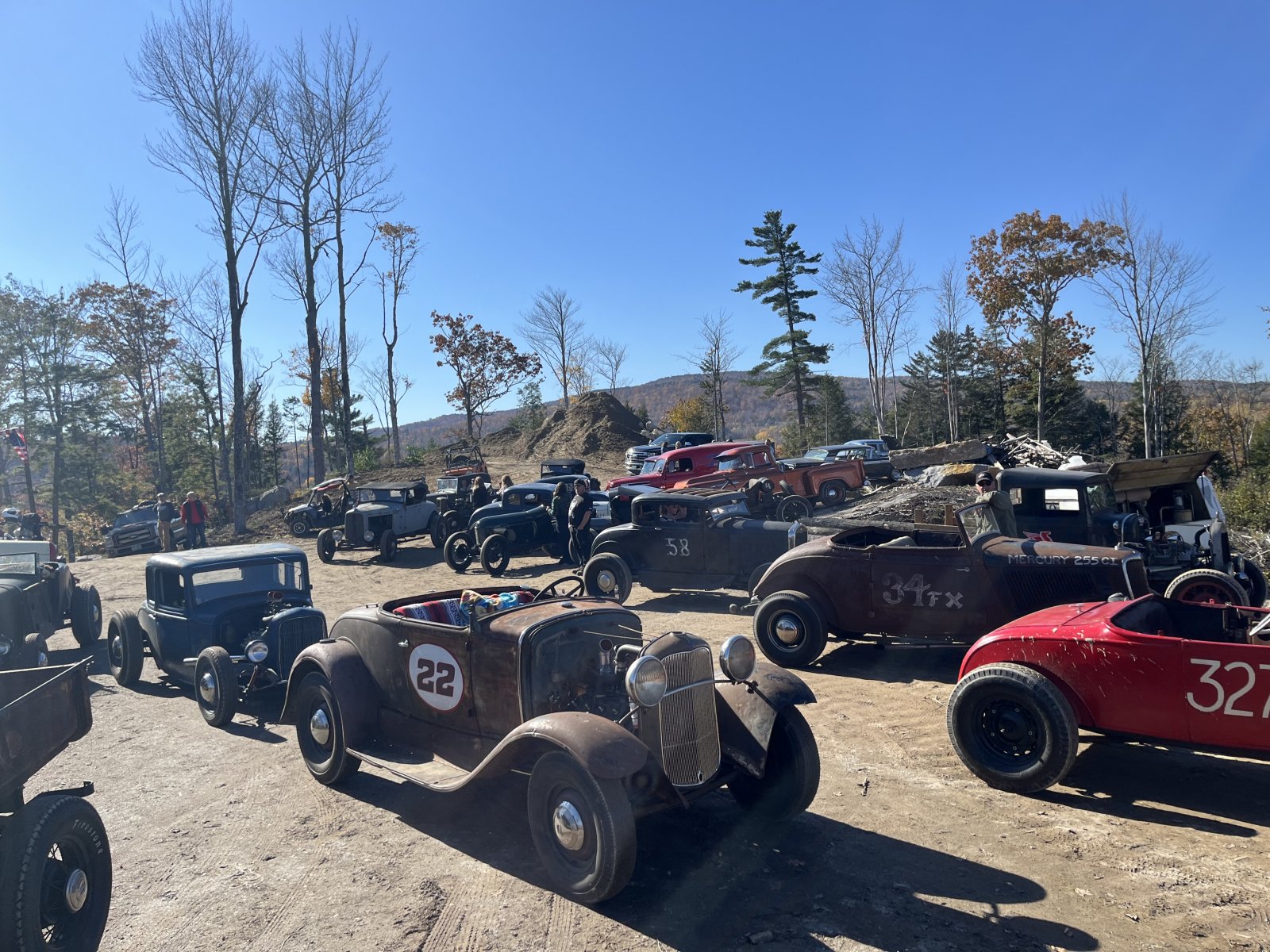

    I missed out cruising this thing around at Pinetree Jamboree, but my back-up goal was the Jalopy Hillclimb held in Campton NH. After some late night fiddling until 3AM, I got things squared away to where I felt comfortable driving a reasonable distance. The hard work paid off, and the car performed quite well all day, no real hiccups! I missed a turn on the way back and ended up going the LONG way home, but I added over 150 miles to the odometer! The event was great, and I can’t thank Alan and Mark Johnston for putting on this event!
    A95D9C0A-E109-4EE0-AE81-18EB0FC92659.jpeg 93579DB5-28A2-40BE-89D4-AB26E7268058.jpeg FA262BFE-C960-410B-9764-307274BE5738.jpeg 4D89A15F-D468-4ADD-BDB9-EBDA9ECDE230.jpeg B855D0F1-9A15-4FB4-98C8-F99202128077.jpeg AF1EAE12-8450-4B90-8E85-AAA6C255D945.jpeg 06DF9012-BE06-4741-A1ED-B084269415D7.jpeg F243370C-BFE4-4BBA-8628-2F63F5904065.jpeg

  23. Shaun1162
    Posts: 973
    Shaun1162
    Yes it was quite the event! I wish I had a good video to show the road going up to the top… it was no joke! I only made two runs up, the second one a rock had come loose in the road and almost took out my grille! Probably 50 cars in total, and all of them were pretty cool.

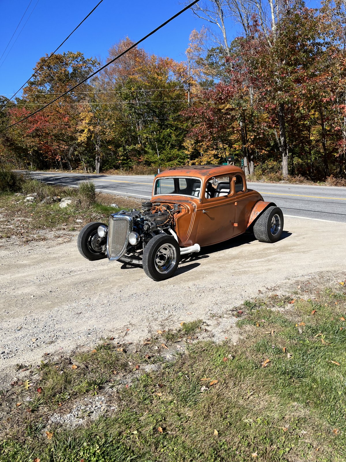

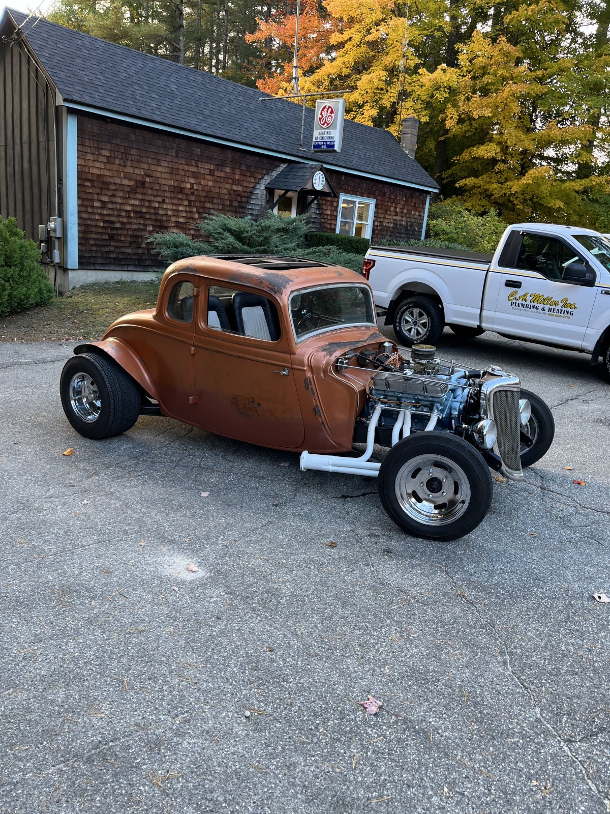

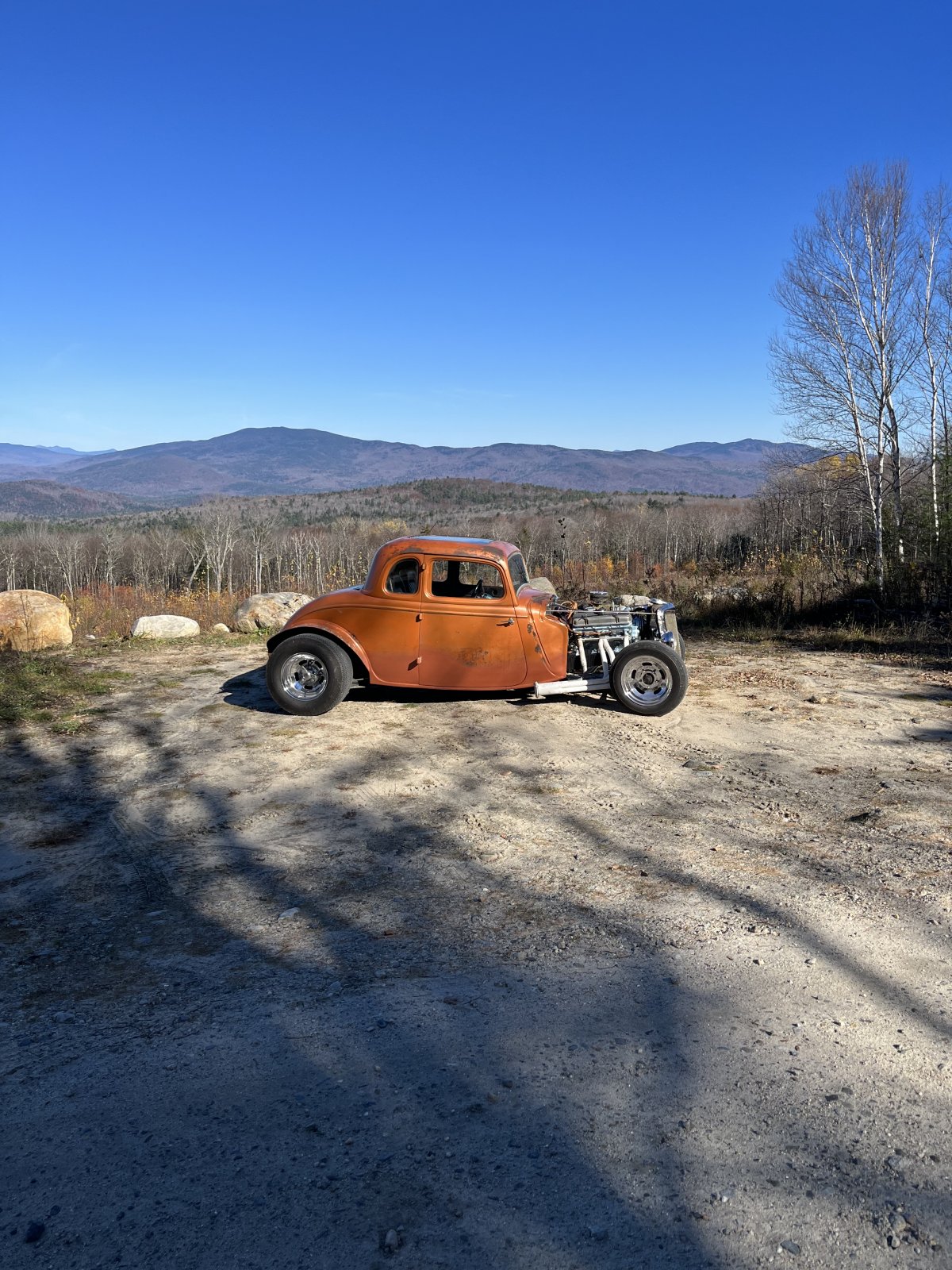

    Posts: 973
    Shaun1162

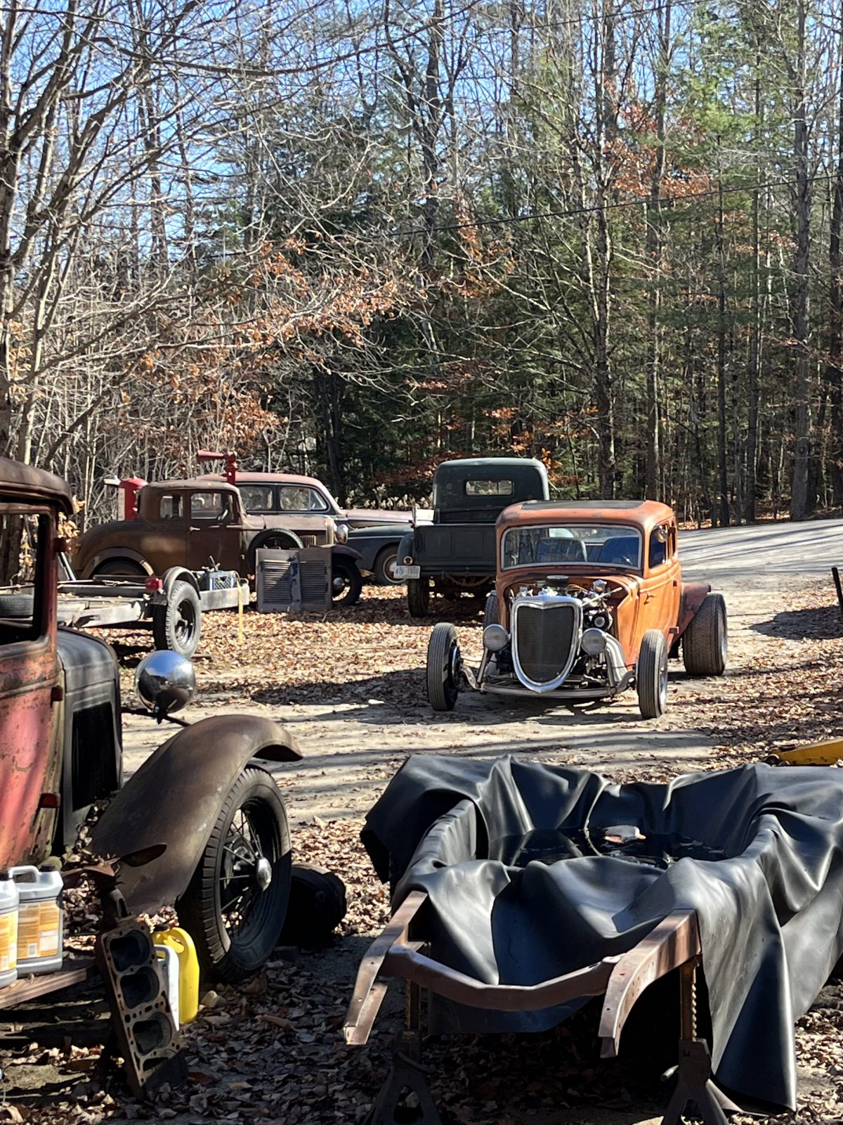

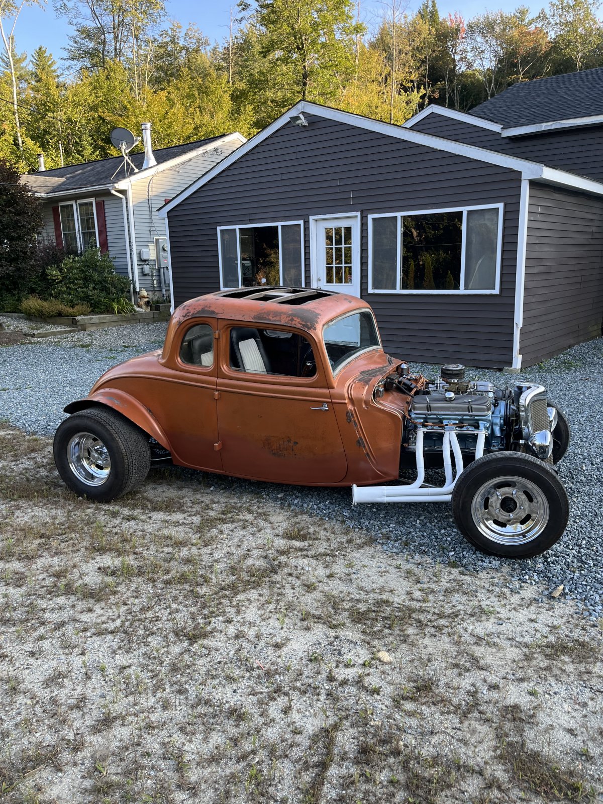

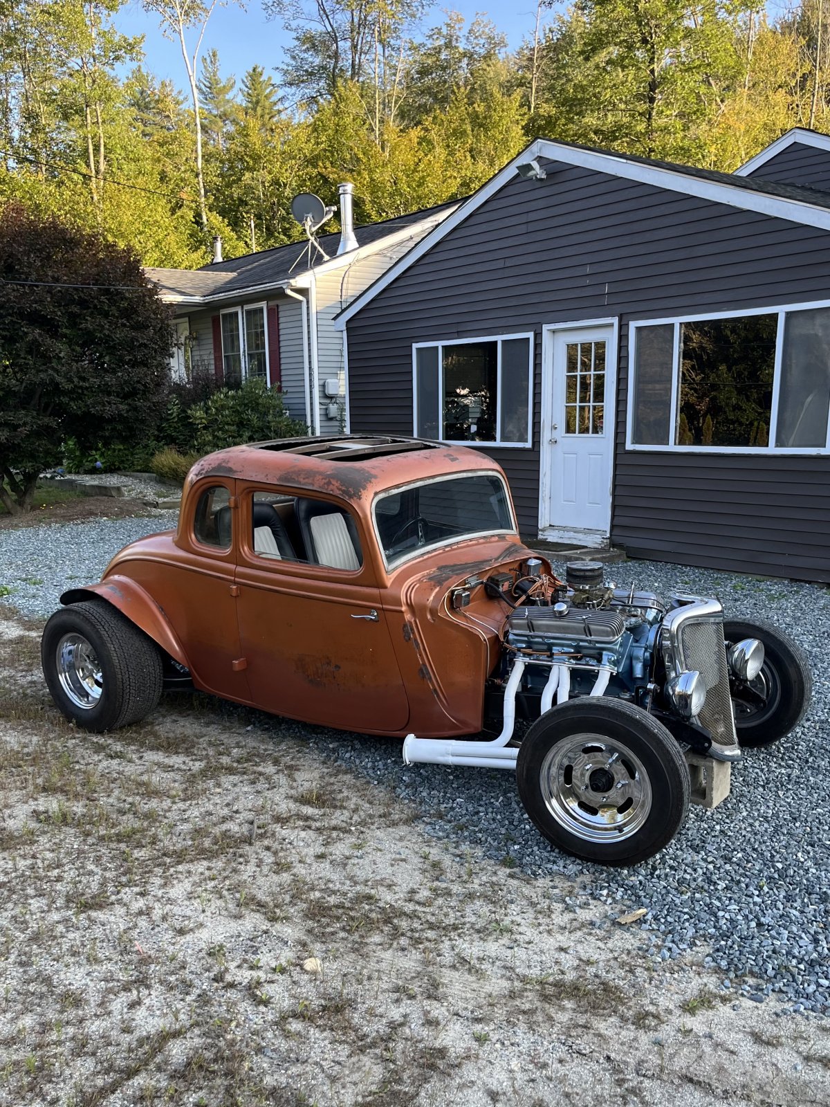

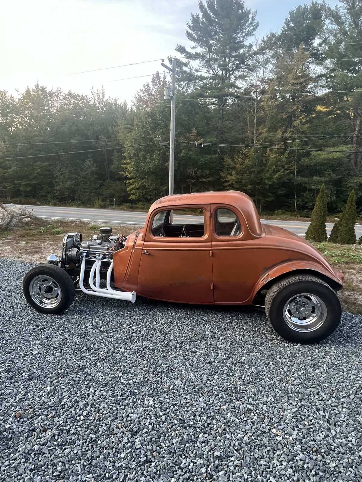

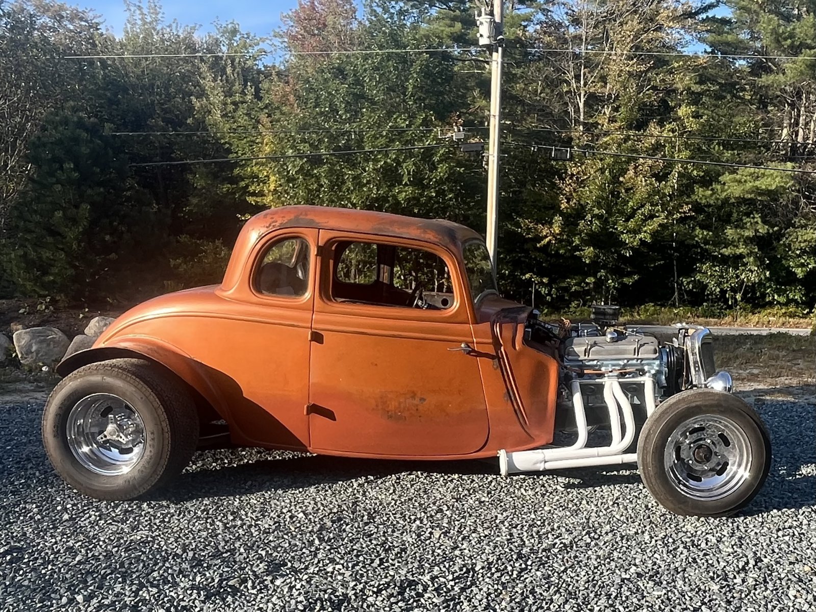

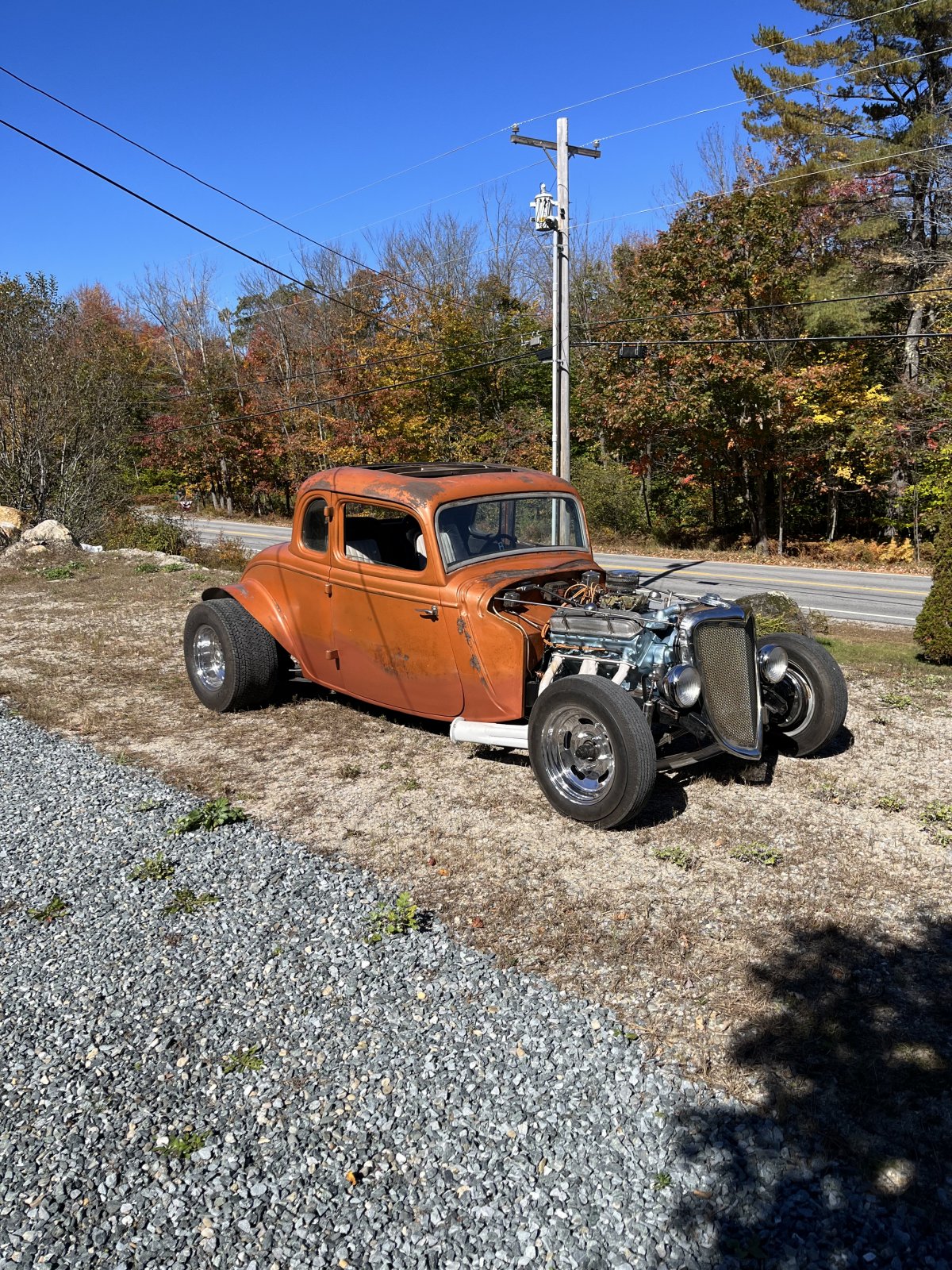

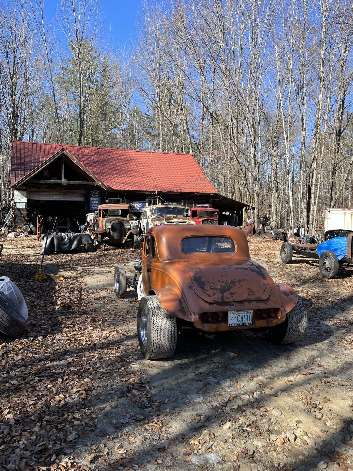

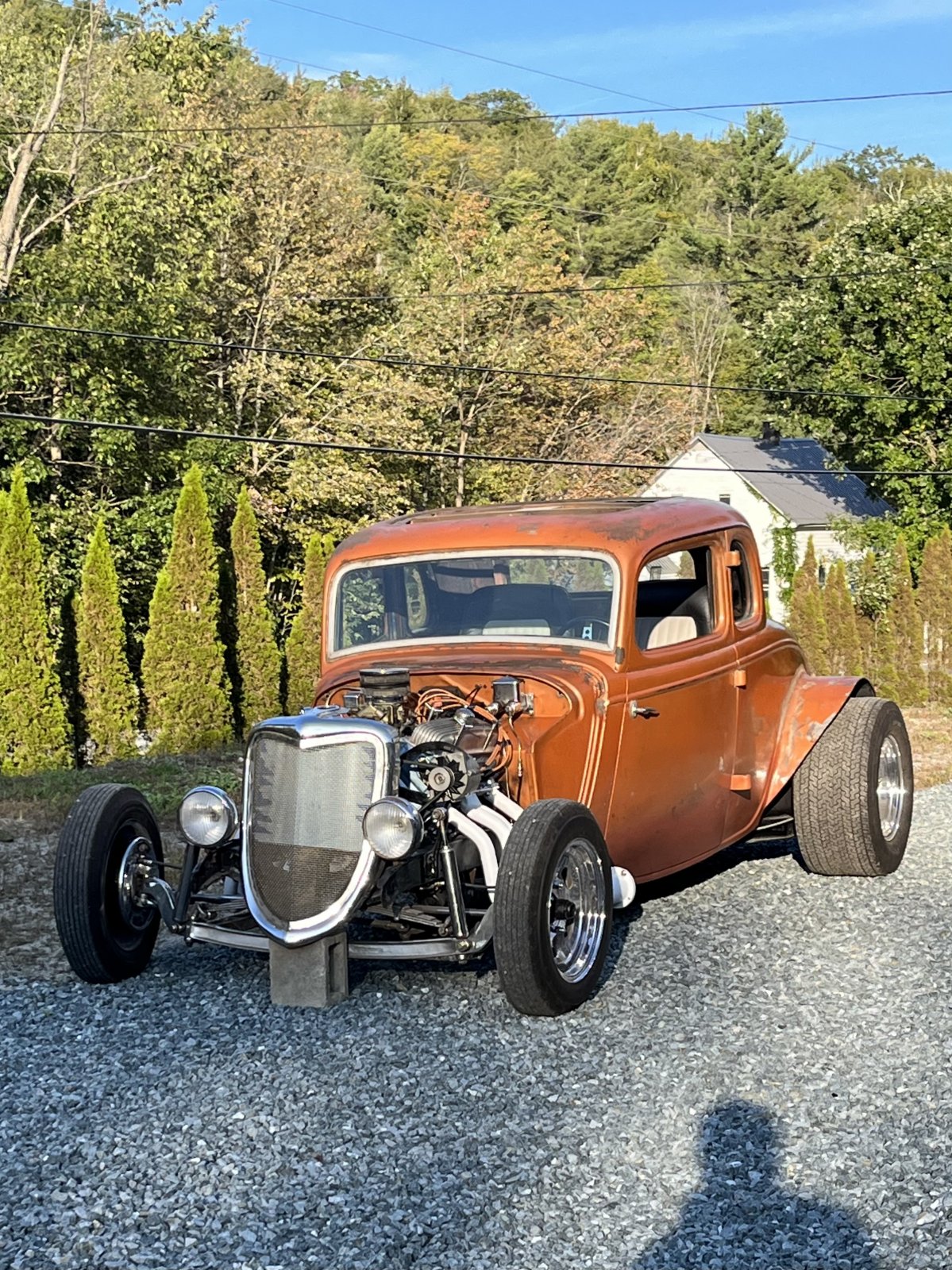

    Another 100 miles cruise today, up to Dorchester NH to take a little (132 pound) load of s**** copper to the junkie and then on to visit the legend himself Howard Towne. Headed up the road from his place and snapped a couple pics…. And then opened it up a little on the way home!
    45A42EFC-806C-4FDB-9354-C5DCA24F5B5F.jpeg 3DC6FA3F-1CA7-458B-9B99-5F755111907C.jpeg D79EC596-E420-4519-AC0C-F9FC48F9FC58.jpeg ADE6037E-8700-44B6-B2EC-D3808EF4ABA3.jpeg 3C6D8C3F-6069-4A24-A020-FAE1FD0F41FA.jpeg 2DAF0309-9320-46A2-8355-AFC2C7A21EF5.jpeg
  28. Howard's yard is always full. Your coupe looks great.
