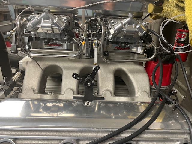

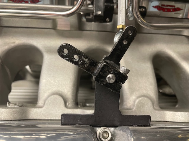

    I have 2 Holley's on my 331 Hemi sitting on a Hot Heads intake. My engine guy used what I think is an Eddlebrock Linkage System. It has 1 lever point upwards and I'm looking for a double sided lever to activate my TV Cable for a 700R4. I was wonder if anyone is running this and would have some pictures of the lever and mounting bracket. Thought I posted this last night but can't find it. Thanks for reading

    Might try running the TV cable off the front carb using the 20-95 cable corrector plate and a 20-95 throttle cable bracket, they both locate lower than you're existing linkage and might clear it, to do this you might have to find a longer than stock TV cable.
    I'm running these Holley brackets on the 700r4 with a single carb with success, made an extra brace attached to the 20-95 cable bracket so it would remain stable and wouldn't swing and on the carburetor stud.
