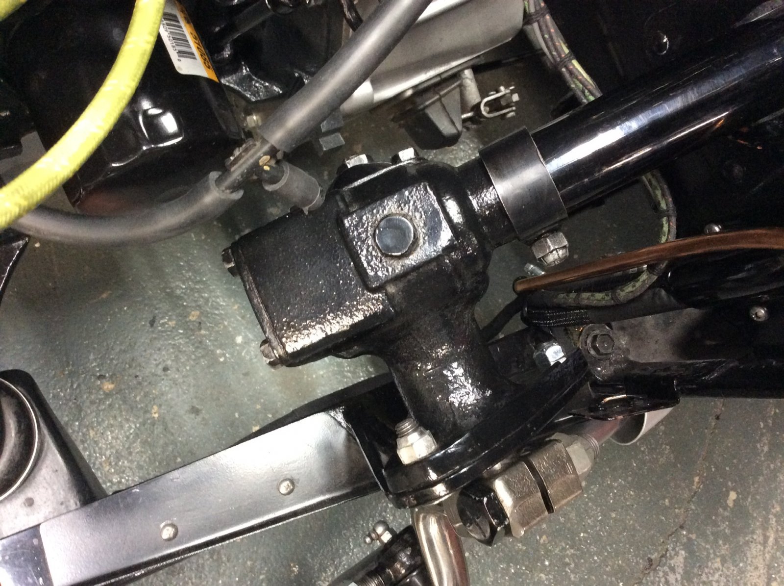

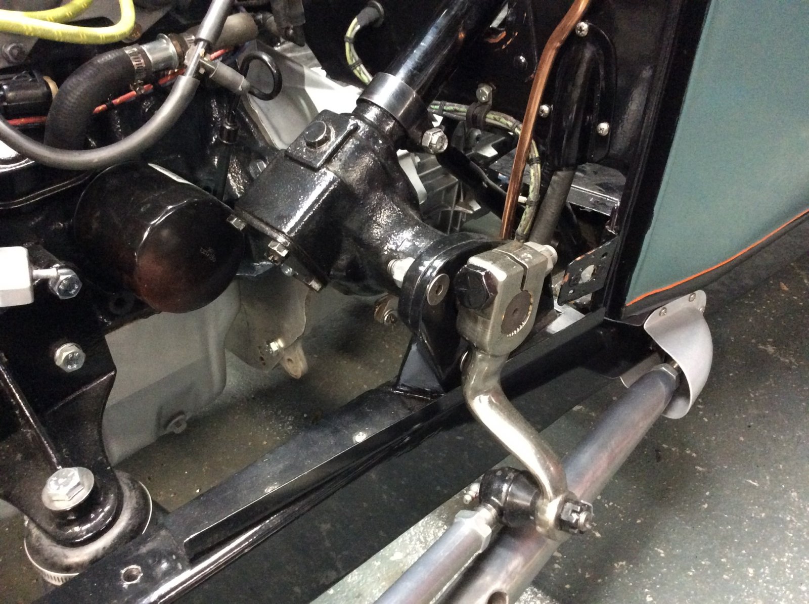

    051F21DC-14C3-492B-B559-94169EFDA7ED.jpeg D0F54792-9A6C-4E88-9615-5BEBAB530198.jpeg Don’t know if this helps you any , but this box is from a 60’s F100 , on my speedster .....

    Thanks Ernie, I went junk hunting this weekend and I think there was a sixties truck out there.
