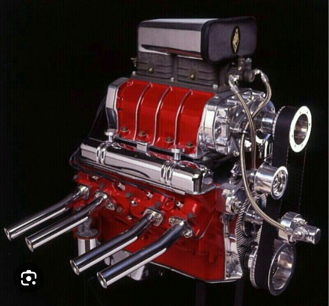

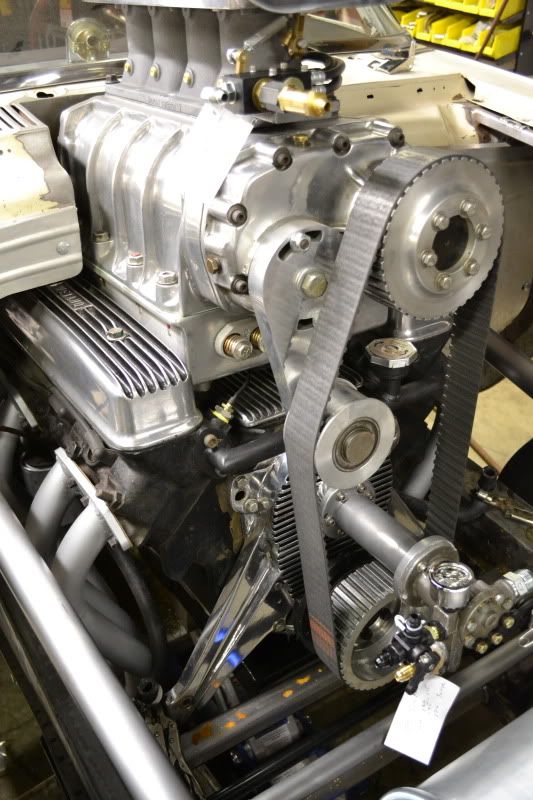

    it has been done.
    I see new manifolds can be made special order by BDS not cheap but they could be a source for parts and info.
    couple inspirational shots:

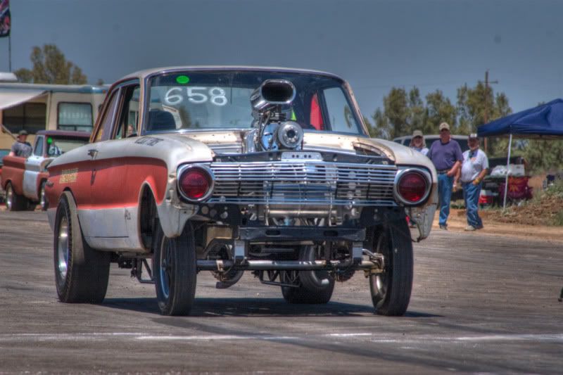

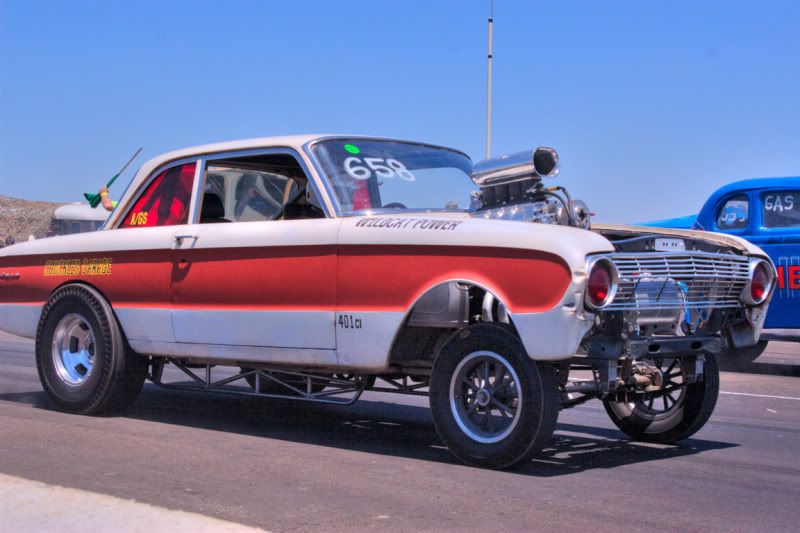

    There's a fella on V8buick that built one and drove it for quite a while, had it in a '62 Wildcat.. There's an intake on eBay right now for one, too (I've been debating a multi carb set-up on my 322 in my Merc and it popped up in a search.)....
    The Wildcat:
