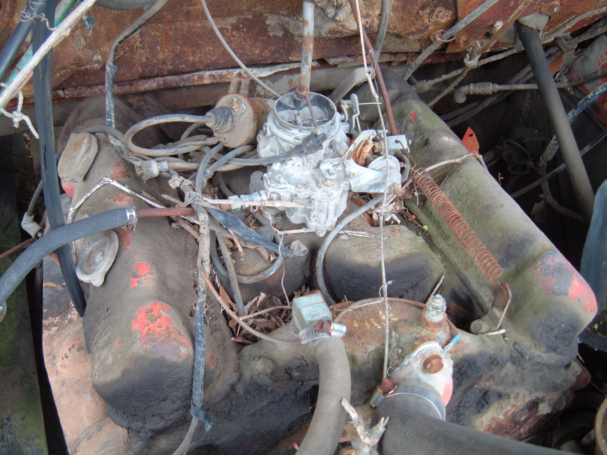

    Yours is a little cleaner then this one.
    Wasn't there two sizes? 401 or there abouts, and one smaller?

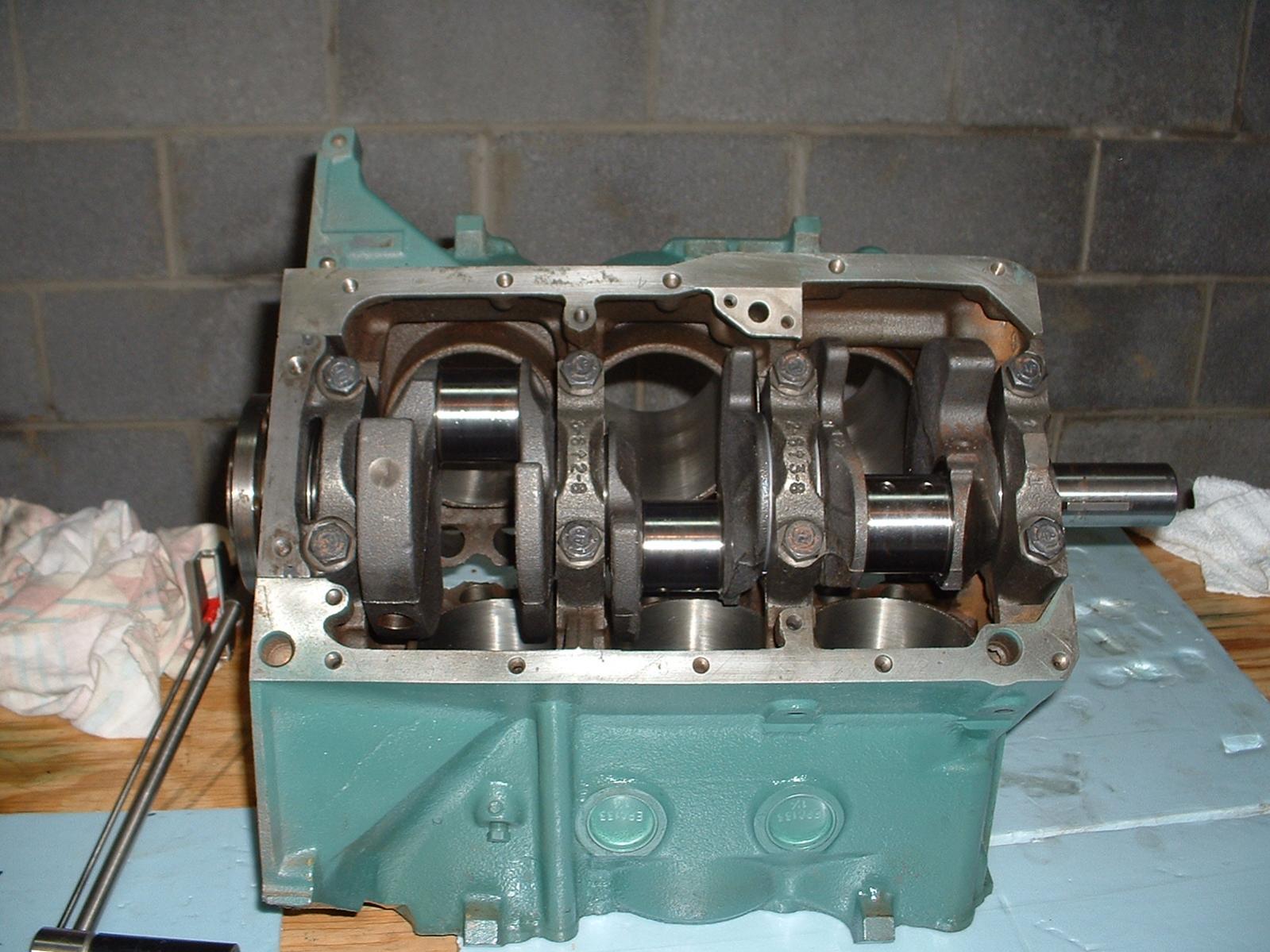

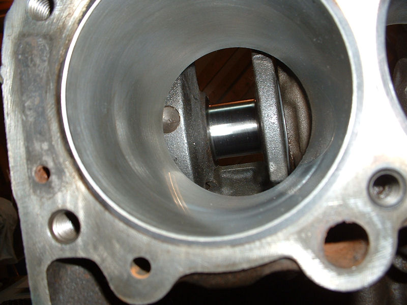

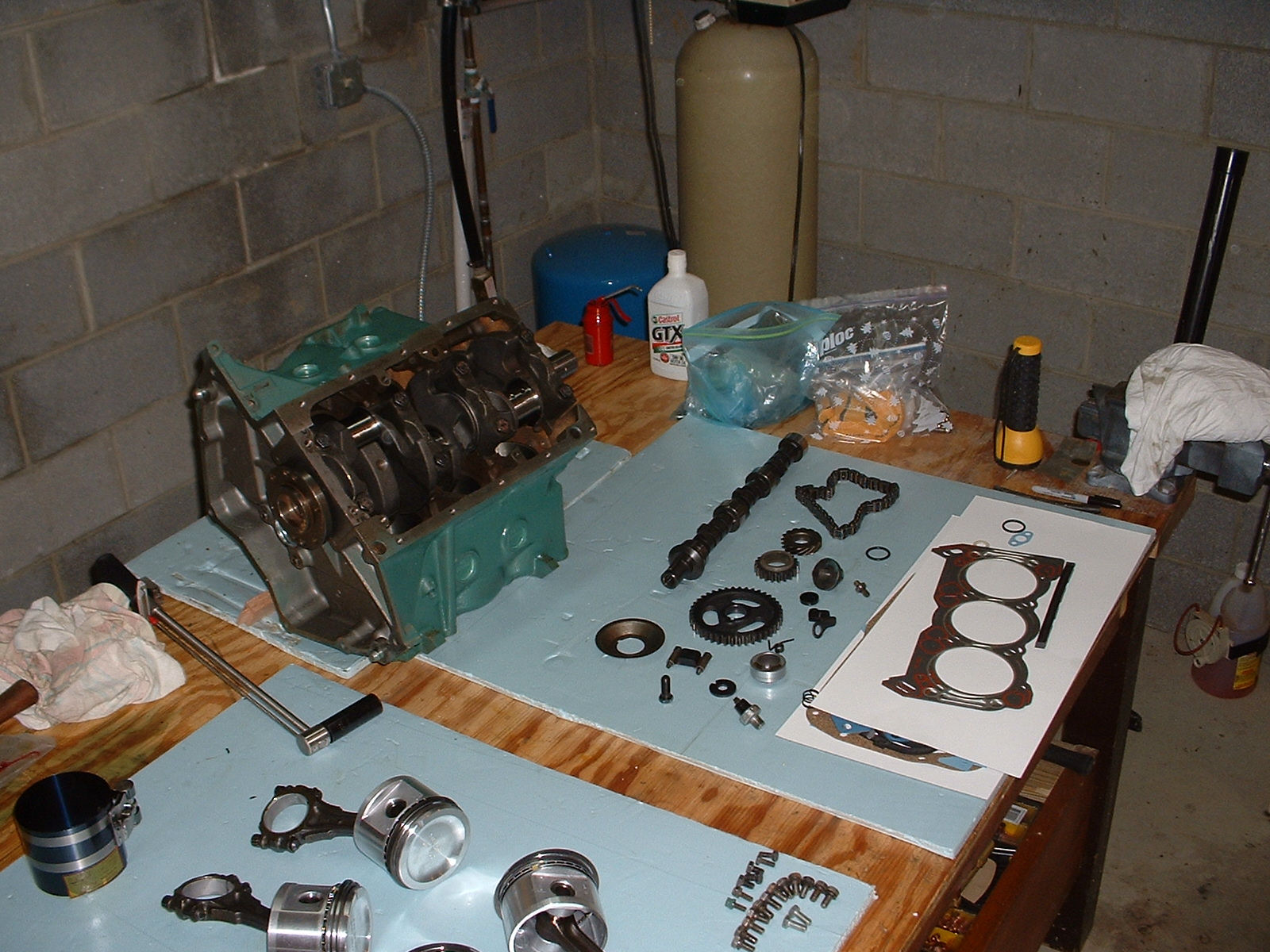

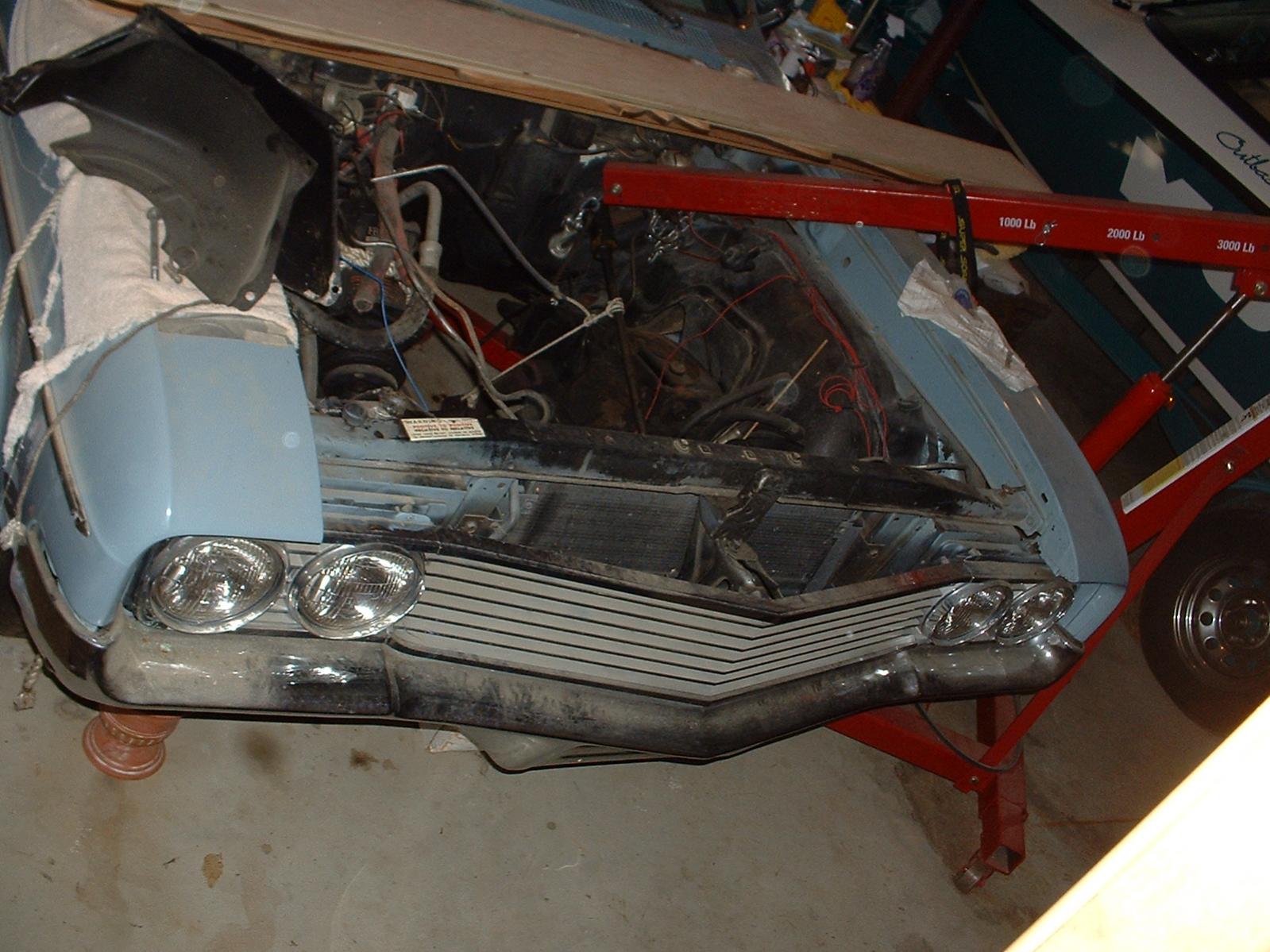

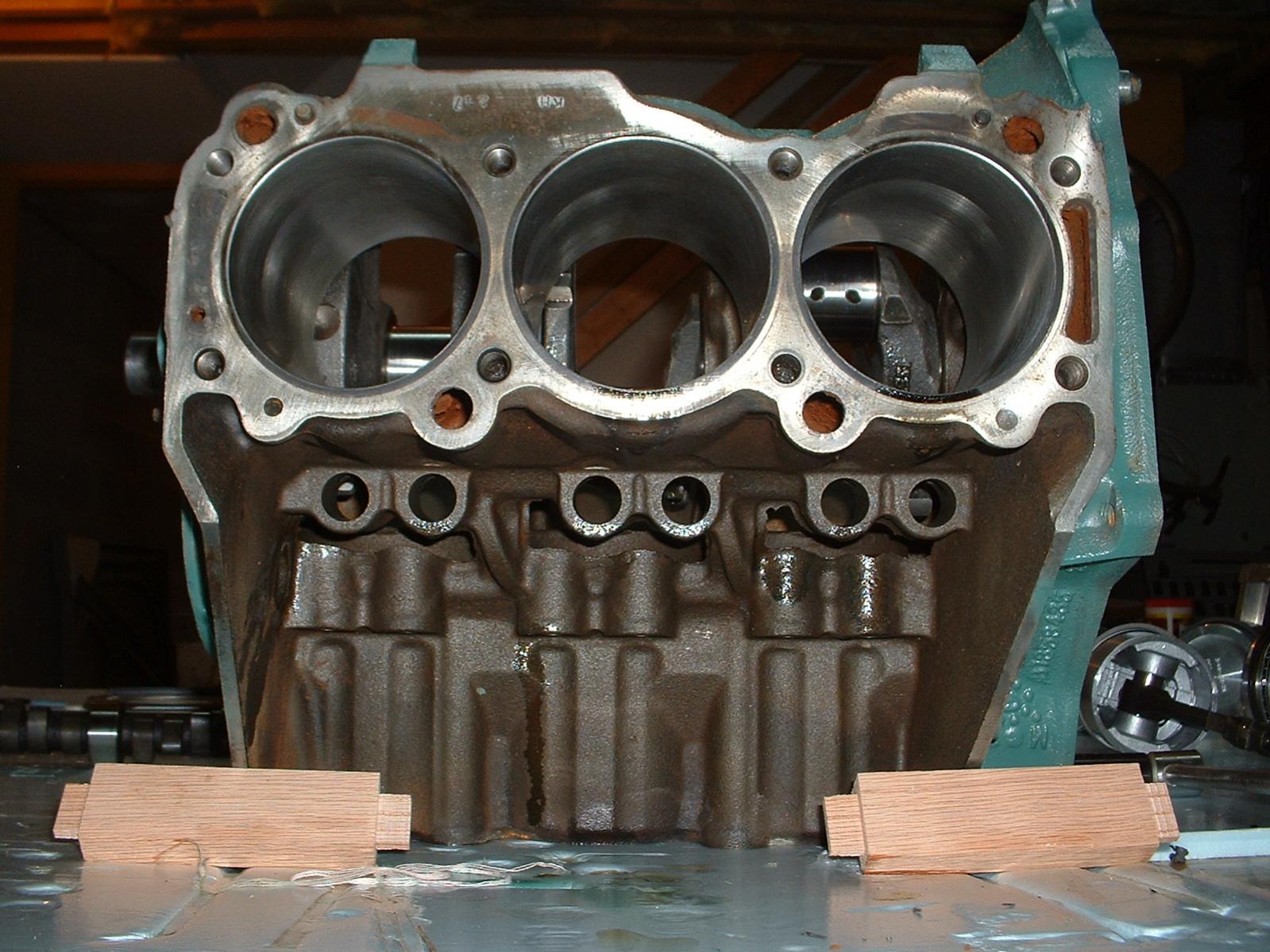

    So here's the 64 Buick 225 CI V6 that I rebuilt. Some folks used them for racing in dirt cars I was told.
    Strong and reliable. Achilles is the nylon coated aluminum timing gear, which gets brittle with age. Also, timing cover is aluminum and forms part of the cavity for the oil pump, to it might need a shim kit to account for wear.
    Same engine was offered in late 60's jeeps, where it was outfitted with a heavy flywheel and called the Dauntless V6. Made it into Rovers, also Chris Craft. Shared lots of parts with the sister engine, the Buick 300 V8.
