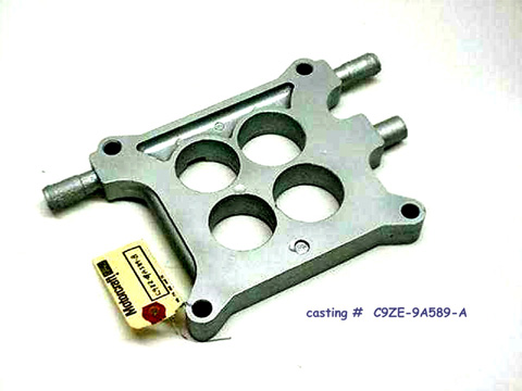

    It you have access to something that can whittle out a hunk of aluminum, you could make a heated spacer.
    This sort of thing was not uncommon, think the Falcon-6.
    Imagine a 4-hole spacer, maybe 1-inch thick, with extra metal on the sides, so as square on the outside as it can be without the bellcranks hitting it.
    Horizontally drill three sides of it, all the way through, making a u-shaped p***age. Tap and plug the extra holes. Put hose barbs on the remaining two.

    I am all about making parts, but I would certainly thing twice before I turned on the mill to save $65-$75, especially considering current materials prices.
