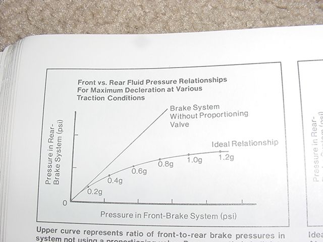

    The very nature of the proportioning valve is that it IS dynamic - this is nothing NEW. What would be NEW is to show me a proportioning valve that ISN'T dynamic. There is this SPRING - springs have RATES.... ahh hell I give up. Find out what "Changeover Pressure" is - in a nut shell it allows the bias to change at a predetermined pressure. That is what separates it from a "balance bar" type brake set up.
    Guys it is all an evolution of IMPROVEMENTS. All this " I have this REALLY OLD car with mechanical brakes - I can lock up the brakes so it must be good." Is a statement that seems to imply (maybe I am just interpreting all this wrong) that they compare to "better designs. Makes me wonder how Bendix ever stayed in business all these years when these "killer" early systems were so damned good all of the sudden. Seems to me you guys you are only FOOLING YOURSELVES.
    Fellas - you wanna run mechanical brakes then by all means go ahead knock yourself out - All I ask is please don't drive behind ME.
    Here's my point in a nut shell - run what you like - it's your car - but do yourself a favor and fairly evaluate it so that you TRUELY KNOW what your limitations truely are. The guys suggesting that since their car p***ed some "safety check" with flying colors and that translates into having better brakes than their "new" car that squeaked by - well then I'd say that's pretty good evidence your new car needs a brake job. Take that baby for some REAL world testing and then we'll talk - until then you're gonna have to chalk me down as an unreasonable non-believer. BTW - do any of these "tests" check the system in WET CONDITIONS or are you guaranteed perfect driving conditions where you live??
    Let's review some of my favorite past HAMB statements: Near the very top was the guy who once posted that "you can achieve brake bias by INDUCING AIR into your rear brake lines". And to think I've beeen spending all my life trying to get the air OUT! WHo knew??
    Then there was the fella that stated his car "stopped on a dime" with rear brakes only. Put me down as unreasonable non believer again. And no I never rode in his car - sorry you just won't convince me - no way no how, because if it was remotely true we all know it'd stop WAY BETTER with all 4 brakes working- ain't rocket science. And ISN'T that what we are really talking about??? Making stuff better -isn't THAT the root of Hot Rodding??? This w****** yourself in blind traditionalism is all fine and dandy - but a bit boring (that whole restoration arguement thing) bottom line IF you are gonna decide to draw the line in the sand at any particular place - then fine - just honestly know where you are and adjust your driving habits accordingly - trying to suggest that some ancient system can compete with improved versions is silly. and NO I'm not talkign about anything newer than the 60's here. Derailing the point with comparisons to anti lock brakes and traction control is just hiding behind unrelevant facts.
    There is NOTHING magical in hydraulic brakes in of themselves. If it was able to simply be boiled down to PSI at the shoe then by all means Mechanical brakes would fare very well in this discussion. And if THAT is the point being made then - I fully agree. My point is that once you go "juice" brakes then a whole world of improvements is at your feet. The best part is that most of it is so easily hidden preserving the traditional look. If you are so hard core that you can't use a part newer than 1950 (insert year of your choice here) then I would suggest that you also forego setting up your ride with the proper steering geometry too - because let's face it most "old hot rods" had that screwed up too. Of course you may want to avoid driving any canyons or mountains especially in the rain.
    My old Hot Rod - what ever you want to call it - I added disc brakes (and a balance bar) to the spindle mount wheels back in the late 80's. Do I now think I have the best brakes out there?? Sure don't - but it stops 100 times better than when I first got it. You wanna call it non traditional?? Go ahead - won't hurt my feelings a bit. I wish I could put those wheels on all my cars.

    The only way a proportional valve can be dynamic is for it to be able to sense loading and/or road conditions. The only way I know of this happening is to have a mechanical connection that senses load or an electronic connection through a computer that has control over the valve. Some pickups have a lever attached to the valve that measures the load in the pickup bed by the position of the ch***is and allows lesser or greater rear wheel brake pressure accordingly. A garden variety proportioning valve does nothing more than set a predetermined pressure differential between the front and rear brakes. Typically, this will always be 70/30 or 60/40 regardless of load or anything else. Combination valves, that include proportioning, do a couple of other things such as sending pressure to the rears first and holding residual back pressure, but the relative front/rear pressure is preset. The "changeover pressure" has nothing to do with proportioning, it's the bias provided by a combination valve that sends pressure first to the rear drums for smoother braking. There's a spring loaded valve within the combination valve set at 150 psi or so that must be overcome before pressure goes to the front disks.

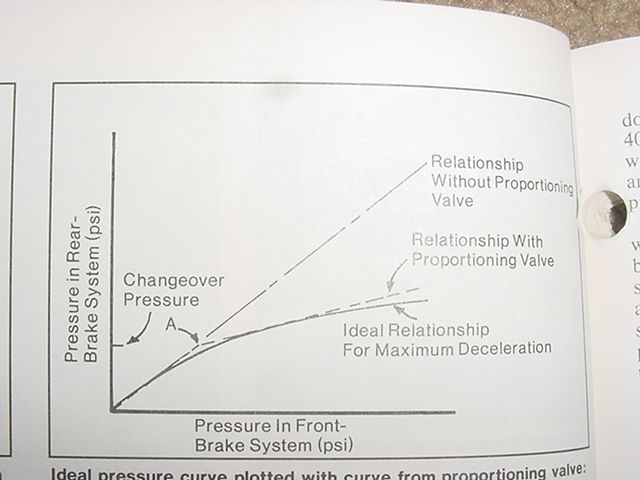

    Max, I think you are confusing the "changeover Pressure" with the "hold off pressure". And while I will agree my use of the word "dynamic" conjures up a slightly different meaning than I intended it isn't entirely wrong either, But I admit I could have used a better word (other than I couldn't think of one better). BY "dynamic" I don't mean one that sense road conditions - but I mean one that IS NOT a simple pressure curve as you have suggested. 70/30 60/40 Example you state is exactly what proportioning valves are NOT. A Balance bar system would work as you describe but NOT a proportioning valve. A proportioning valve has basically TWO distinct pressure curves. The point at whihc you change from one to the other isd called the "Changeover Pressure" - this is done in an effort to try to emulate the optimal braking relationship front to rear - see attached pics for clarification.

    I've got a long history of being confused, so this is a distinct possibility in this case. You're correct that I was referring to holdoff pressure. My reference material indicates that holdoff is a function designed into a combination valve and that the holdoff period is the only time the front to rear preset pressure ratio will deviate from the design. A standard proportion valve does not have this function but a separate holdoff valve can be installed. Since holdoff occurs only during initial brake application and during very light braking, I think we can agree that it contributes little to safety. As far as a pressure crossover point being engineered into a proportional valve, I'll have to take your word for it as nothing in my materials mention such a thing. But, I am curious as to how such a feature would work and what the benefits would be.

    HemiRambler got my curiosity up about "Changeover Pressure" so I called an old friend who used to design mechanical stuff for cars. I'm sure he simplified a lot for my feeble mind, but essentially he said the "Changeover Pressure Point" was nothing more than the point during brake application that the master cylinder builds up enough pressure to make the proportioning valve actually do something. Before the pressure reaches that point the proportioning valve does nothing (although the holdoff valve in a combination valve will be in play) and both front and back brakes get the same pressure. He wasn't familar with the term "dynamic curve", but he did say the rear brake pressure percentage would be a little less during heavy braking because of the non-linear force needed to compress the proportioning valve spring.
