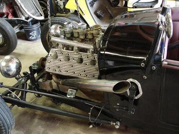

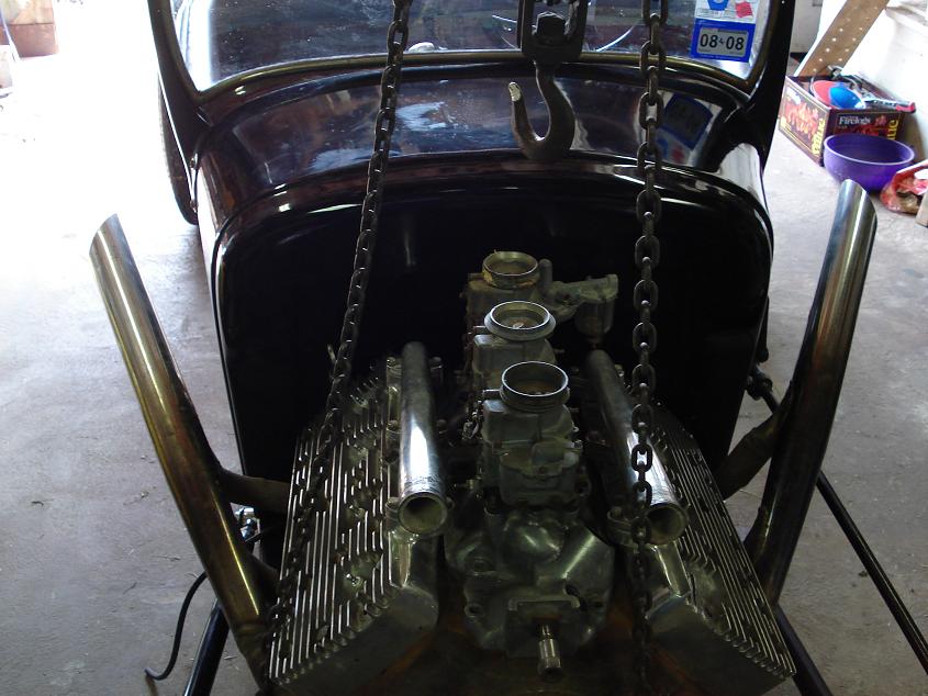

  4. 36tbird
    Joined: Feb 1, 2005
    Posts: 1,177
    36tbird
    I did this on my fenderless '36 pickup that I am just now getting to run. Don't know when Ford quit using these driveshafts, but they are cool. One pic is from assembling, other is current.

  7. it is actually the DRIVESHAFT out of a 36 ford torque tube...not the tube itself..desirable because of its light weight and perfect amount of TAPER...very common practice on the real hot rods of the late 50s...We got Lakeheaders to build us a set from our driveshaft because i hate the look of every megaphone style lake pipes on todays builds...looks like a parking cone to me...you chop the spline ends off of each end and cut the driveshaft in half and there you go!...torque tube shaft style looks so much better

    Yep, 36 Ford driveshaft.
