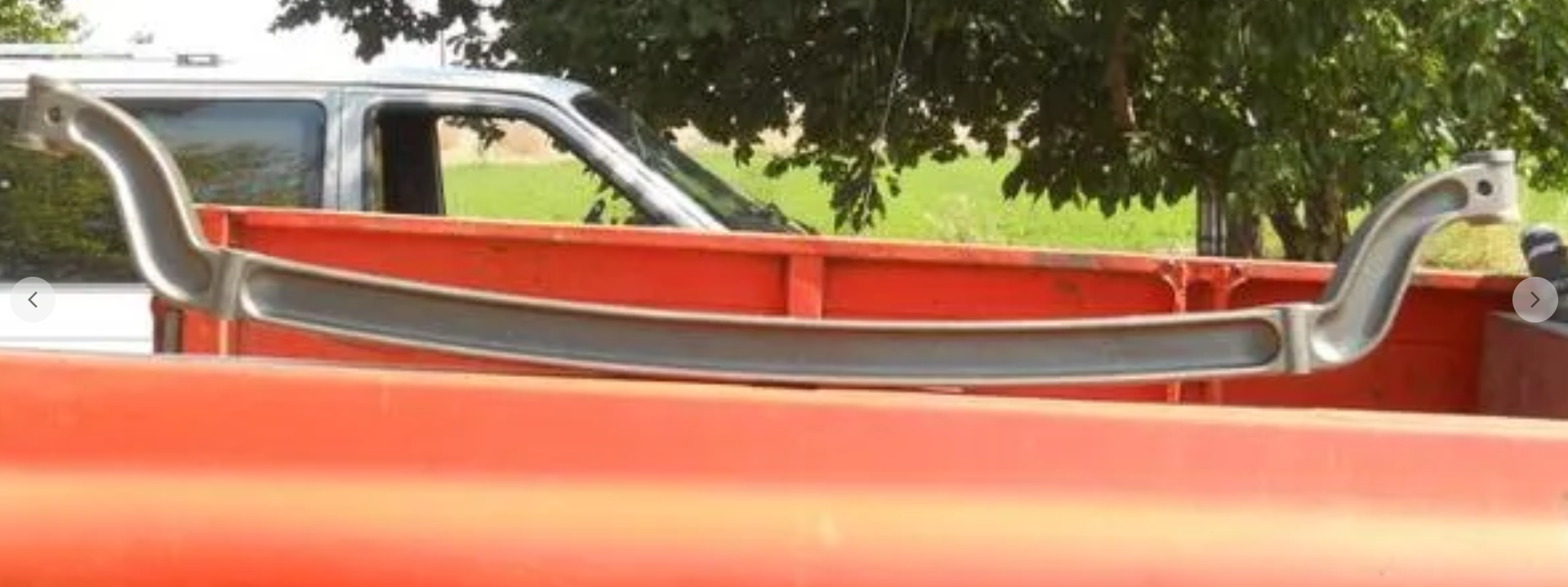

Technical Anyone seen or used these dropped axles ?
Discussion in 'The Hokey Ass Message Board' started by lostone, Nov 24, 2024.
  1. lostone
    Joined: Oct 13, 2013
    Posts: 3,628
    lostone
    from kansas
    https://www.ebay.com/itm/115925676862
    Found these tonight, it says they are forged and it shows a wide parting line.
    I know anything can be faked that's why I'm asking. Other than ordering one and smacking it with a hammer to see if it rings I don't know of another way to prove if it's cast or forged other than hands on experience...

    I would look into finding a 29” wide spring also. That’s pretty dang narrow no stock ford spring is going to fit that axle.

    That axle just doesn't look like a forged axle due to the parting line.
    Plus, it doesn't tell country of manufacture.
    I wouldn't buy it.

    sort of looks like a socal axle
  15. alchemy
    Joined: Sep 27, 2002
    Posts: 22,772
    alchemy
    That’s what I thought. Doesn’t Roadster Supply sell the same axle as SoCal did/does? Maybe the same manufacturer is selling to many vendors now?

    Yeah I've checked roadster supply and they look like the same axle.
    I don't think it's Hoffman group, as all I've seen they offer is cast. This axle is definitely forged if you follow the link by silent Rick.

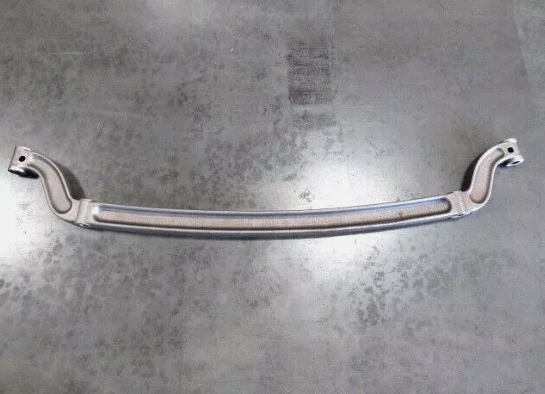

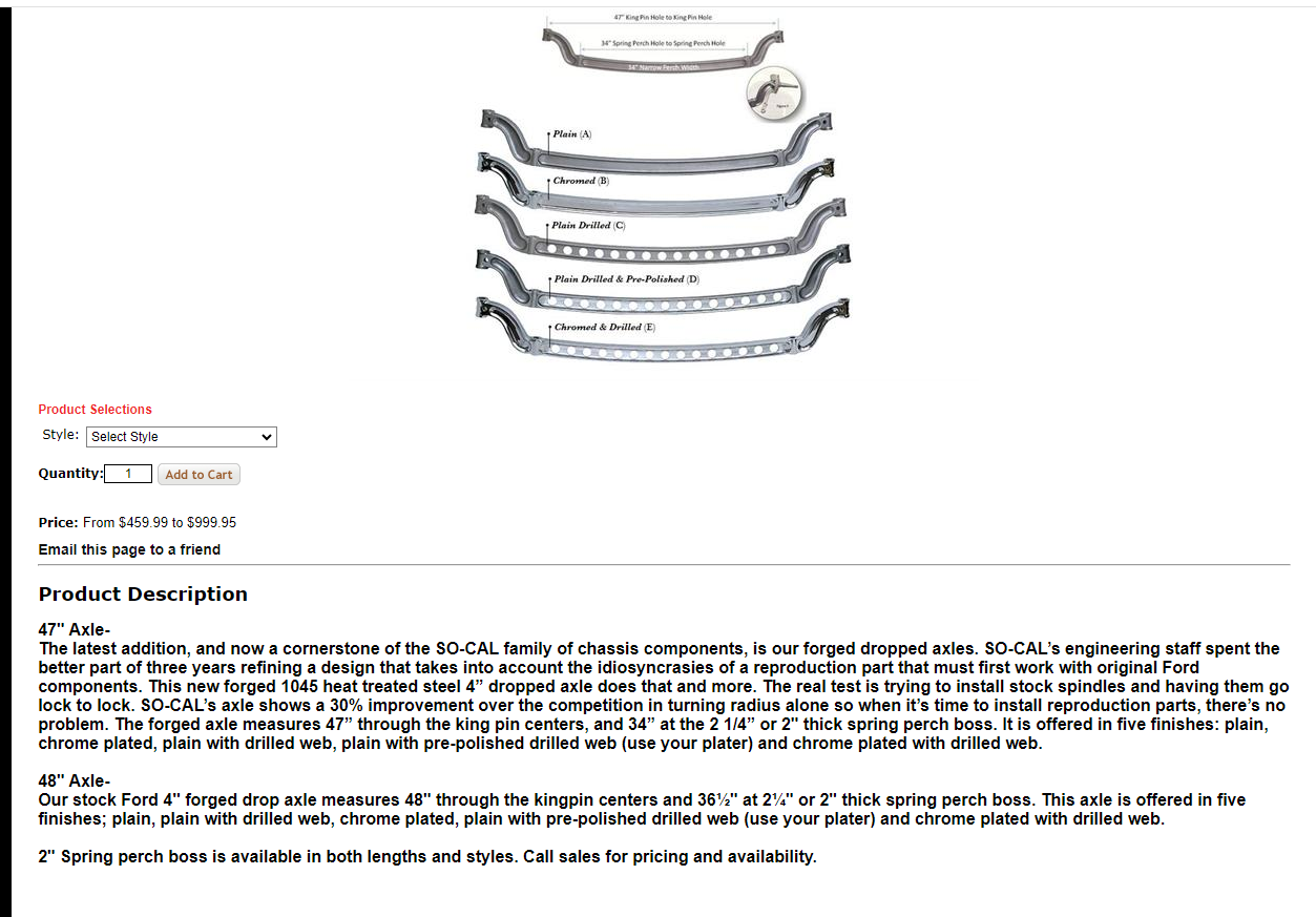

    Damned close, the one sitting on the orange truck bed is mine. I can't remember if the king pin center to center is 47 or 48 but the center to center on the one I have and So Cal axles take a 29 inch spring.
    I wonder if the outfit that forges the axles for SoCal has a sideline going. Screenshot (1632).png Screenshot (1634).png Screenshot (1636).png

    Those are not made from identical dies. The shapes of the ends of the recessed portions are different between the two. Now, that's not to say the dies weren't changed in the time between the two axles were manufactured.

    The photo of my SoCal Axle sitting on my truck bed was taken Sept 2012 when I first got it and I picked it up off Ebay as a shelf worn display axle. It was the axle they had in the trailer to haul around to shows for several years and the box shows it.
    I was noticing the minor differences too.
