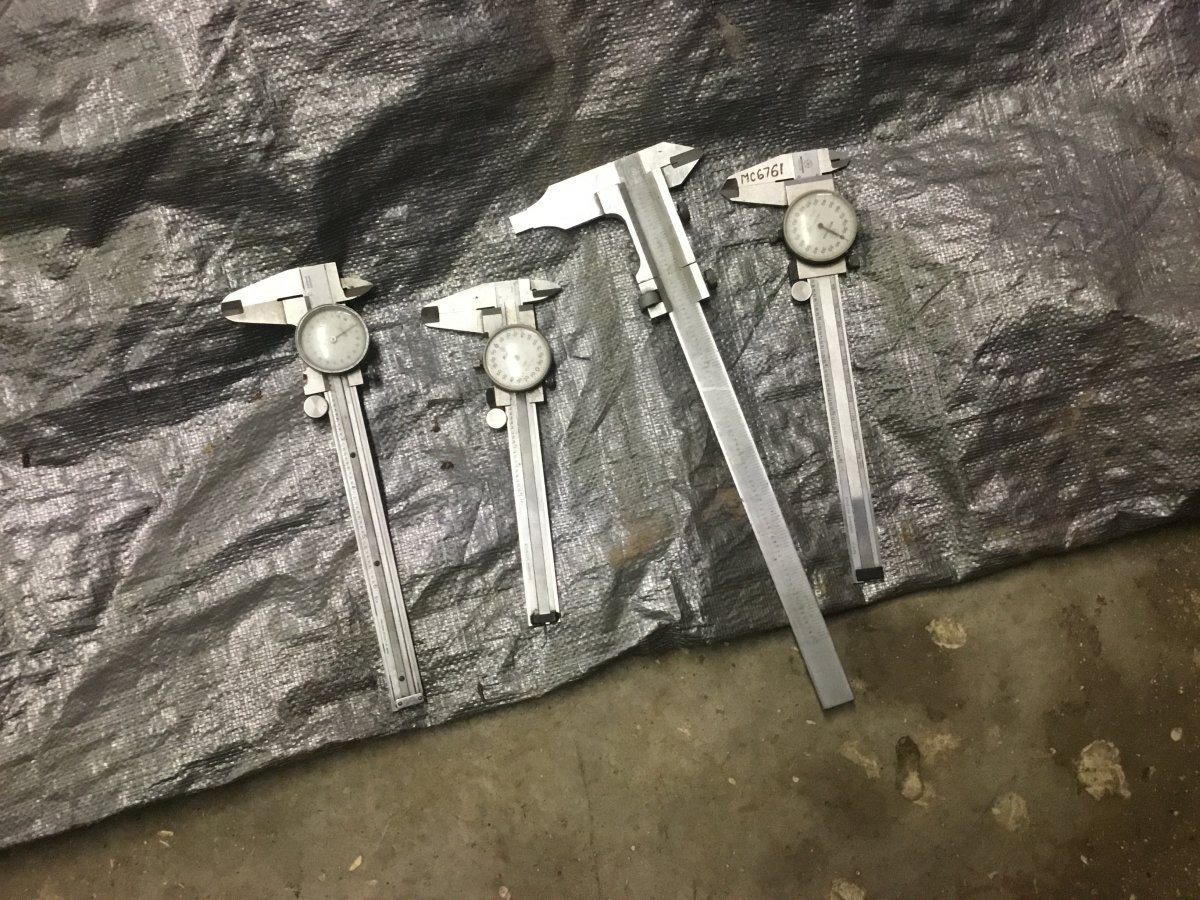

    Almost every time I use my calipers.... but then, I don’t use them much anymore! Lol
    One of the ways I double check things is to use more than one caliper to measure something that needs to be accurate. Not to the point of a crank main or throw, but something that needs to be closer than a yardstick. Hence the multiple calipers!

    That's one big caliper! Is that from the B.C. era?
