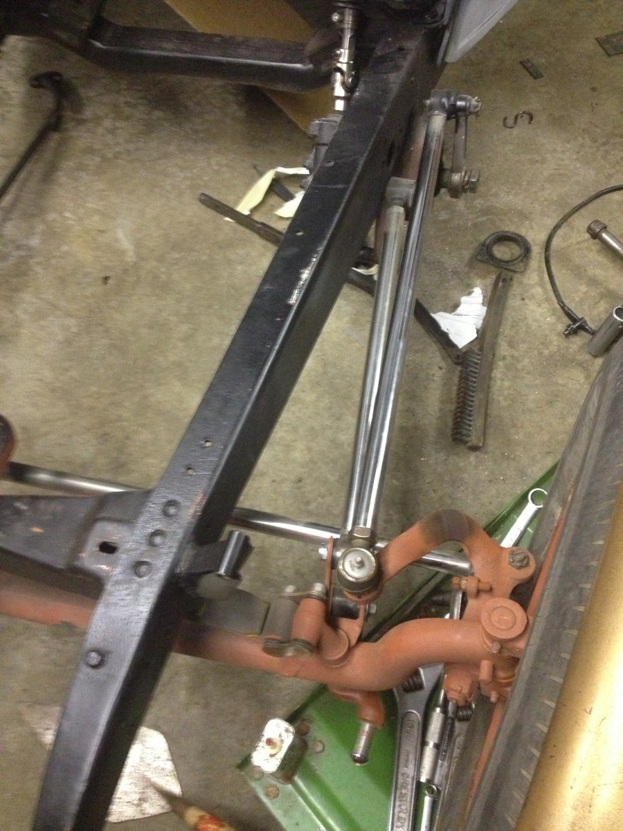

    A**** the "surplus parts" I have acquired for my build is a nice set of "hairpins". I know about the tube axles' resistance to twisting, so I got a set of these "adjustable" spring perches from Speedway to compensate for that fact.
    https://www.speedwaymotors.com/Forg...e&utm_source=CSE&utm_campaign=CSEGOOGLE&gclid
    Perhaps this will give me enough points of limited movement to allow me to get away with it. I have seen quite a few posts on here where folks have run a tube axle with hairpins or split wishbones for years with no problems.
    I'll watch it closely, and if I see any signs of fatigue, I'll probably have to go with a set of four-bars, as much as I don't like their looks. I expect to get away with it for two reasons; first, the smooth surfaces that these cars experience for the overwhelming portion of there lives, and second, the more limited suspension movement experienced in light cars like this because of the unfavorable sprung/unsprung weight ratio. When I do have one of those rare instances where I encounter the odd bump or two, I expect to pay for it with a jolt to my tuchus rather than stress on the suspension.

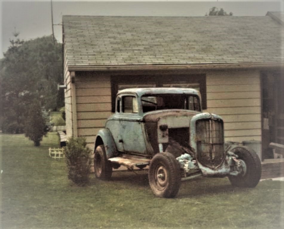

    There was also a tube under the red 5 window. HRP
