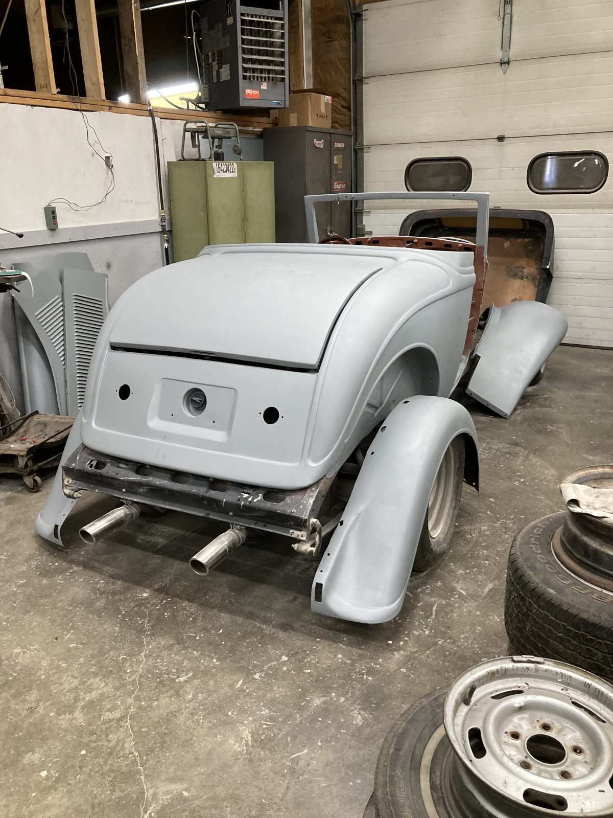

    I used the Eastwood roll on primer and was very satisfied. It was a little thinner than I thought but two coats did the job. Bought a gallon and only used a little more than half for whole car. No overspray every where and just some drips on floor. I’m blocking car now and it sands fairly easily IMG_2993.jpeg
