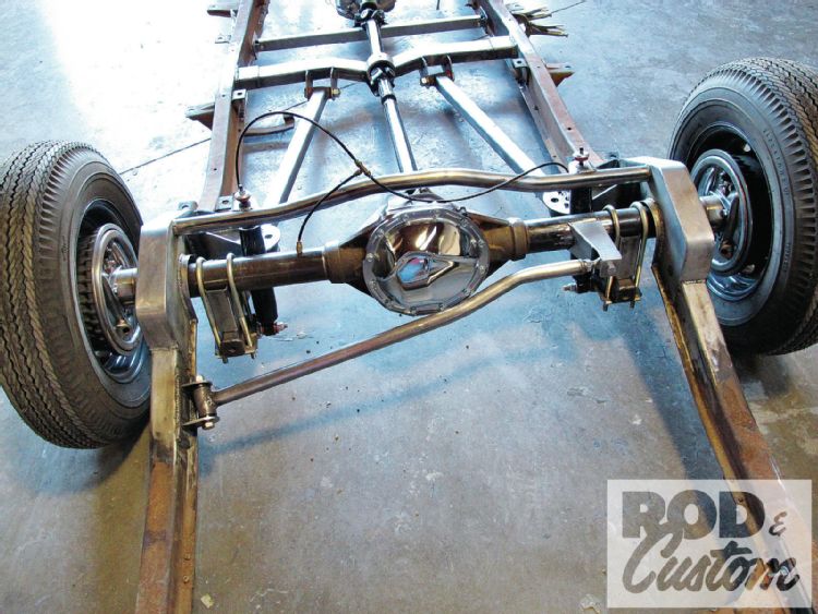

    I've got a 54 chevy that i'm gonna start gathering air ride parts for. Anyone used a Jimenez Bros two link kit? They look like they are well made and everything but just wanted some personal experiences.

    The design doesn't look horrible, but I would like a better look before I said it looks good.

    PS, maybe I'm just being pickey, but I would prefer a watts link for that setup.

    Two links like this one are the cheaper route to do a air ride, they locate the axle , that's the only thing they do that's good. That panhard bar looks silly in that pic. Good luck

    Sure looks like it's patterned after an old Chevy pickup or NASCAR rear set up.
    They both use Panhard bars too.

    I believe if all you want to do is cruise it with a little up and down action from time to time it'll be fine for your needs. I remember reading the article and I was pretty impressed with the simplicity of it all. The 2 links allow it to travel up and down the panhard prevents side to side shifting. You can ask them all the questions you like. They are HAMB memebrs as well.

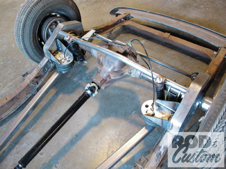

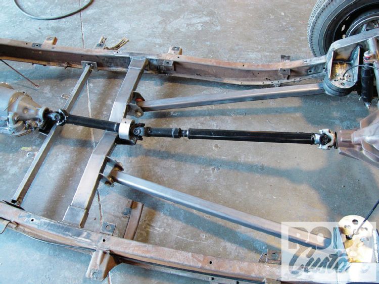

    heres a couple more pics

    I like the simplicity of the 2 link but not used to seeing the 5"-6" lowering blocks and the pan hard bar does look awkward at best...... JMO

    theres no lowering blocks

    Top right pic, first post.............................................
  15. The problem I have with this is that they use square tubing. For a Truck Arm suspension to articulate properly, the arms need to have the ability to twist axially and square tubing cannot do this. It is the reason that NASCAR Truck Arms are required to be I Beam design. Over time I think this will be a problem not to mention it has to bind when the axle articulates even on something as simple as entering a driveway at an angle. JMHO

    it seems to be the blocks are only there
    to hold the bracket for the shocks??? A bracket could be welded on the housing and eliminate the block i guess?? Right??

    It's a cheap way to kill 2 birds, lower car and a place to attach the shocks.
    Take the block out and the car rises an equal amount.
    Yes, shocks could be mounted to a bracket off the rear end tube................

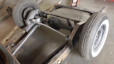

    This is the closest I've found. This car runs a JBC 2 link, but has had extensive fab work to the floors, trunk, etc. If the 2 link alone got me this low, I'd be sold.

    I think it will need a double U joint at the driveshaft end near the pivots. The rear end does not chamge joint angle but the front sure does. I would run a low panhard bar from a 59-64 chevy. It also needs front bushings that are soft in torsion.

    This 49 is running JBC 2 link
