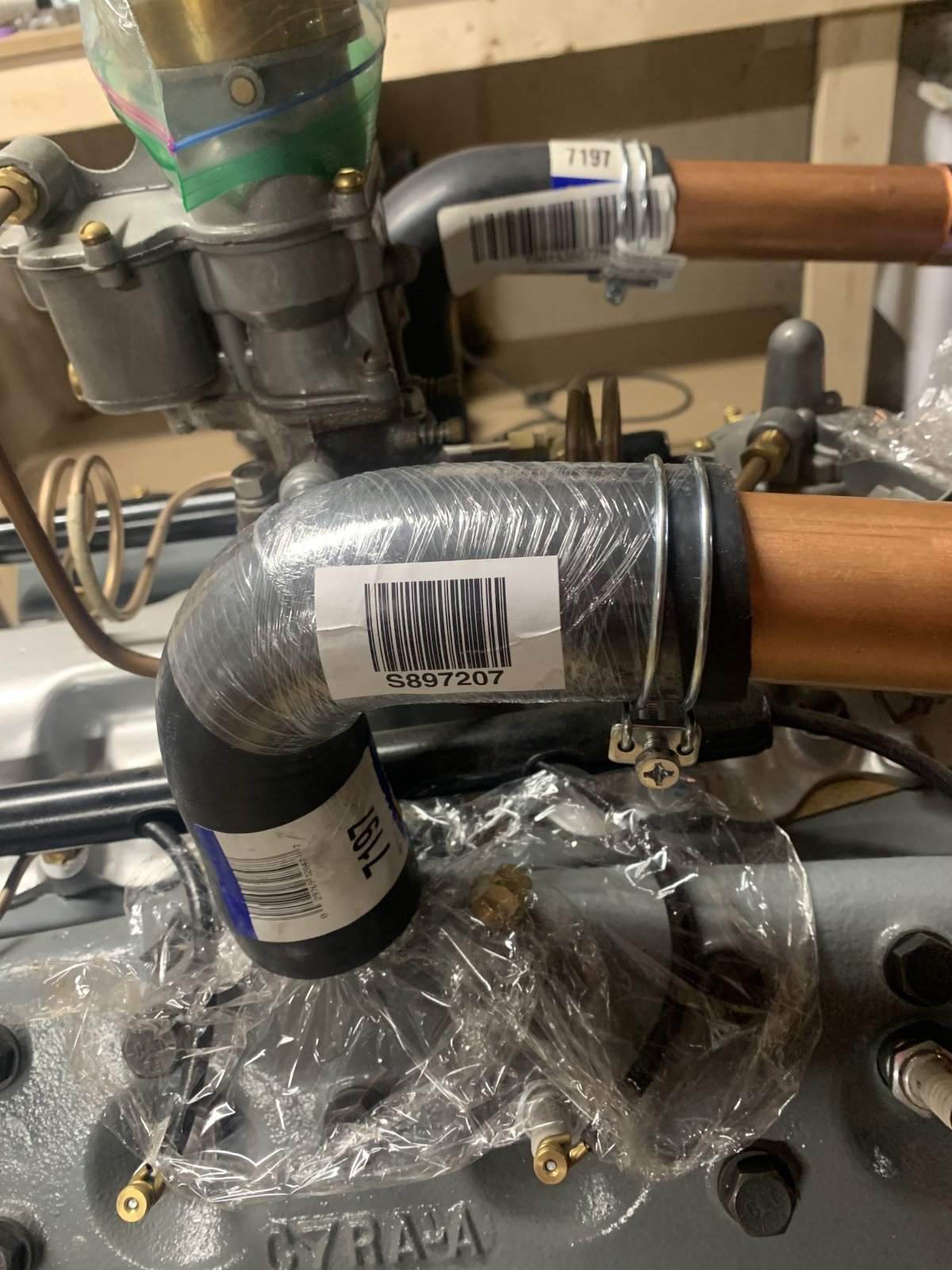

    This is the type I prefer. Cheap, simple and "period correct"-as far as I am concerned.
    down-the-road likes this.

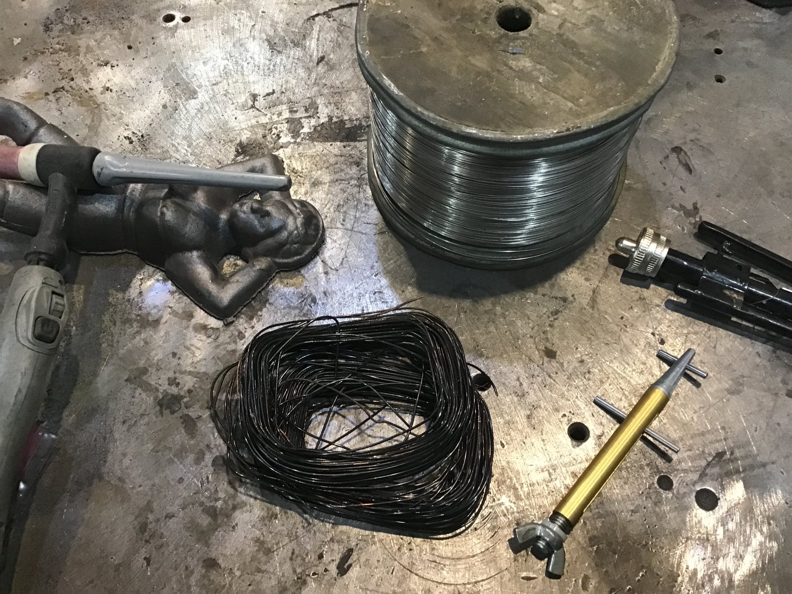

    I think the Wirlly jig or what it was called when it first came out has it’s place. I purchased one at a woodworking show 20 years ago . Having it so long I only have used it a few times a year now. It no doubt seals the hose and almost too much pressure on the hose and rubber. I use it more on our machines then automotive uses. It comes in handy but use regular hose clamps for the most part.
    I use a combination of wire depending on how I use it . I use safety wire , copper winding wire off a generator and NiChrome 70/30. The NiChrome has a high nickel content and used as resistance wire so it’s soft and strong. image.jpg
