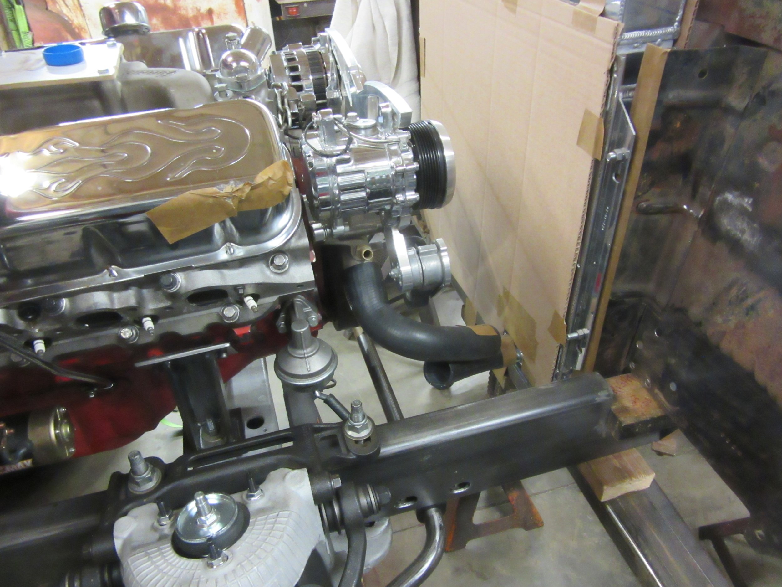

    Well good, I was curious as to how well they sealed. Thanks for the input. IMG_1810.JPG I think I will use them to splice this lower hose. BBC into a 60 F100 .

    I will use them on the splice and put regular clamps on the ends.

    That is what I did. I made a tool to put beads in a short piece of aluminum tubing for the splice since I didn't have a long straight length where the two elbows connected. And like you mentioned hose clamps on the ends.
