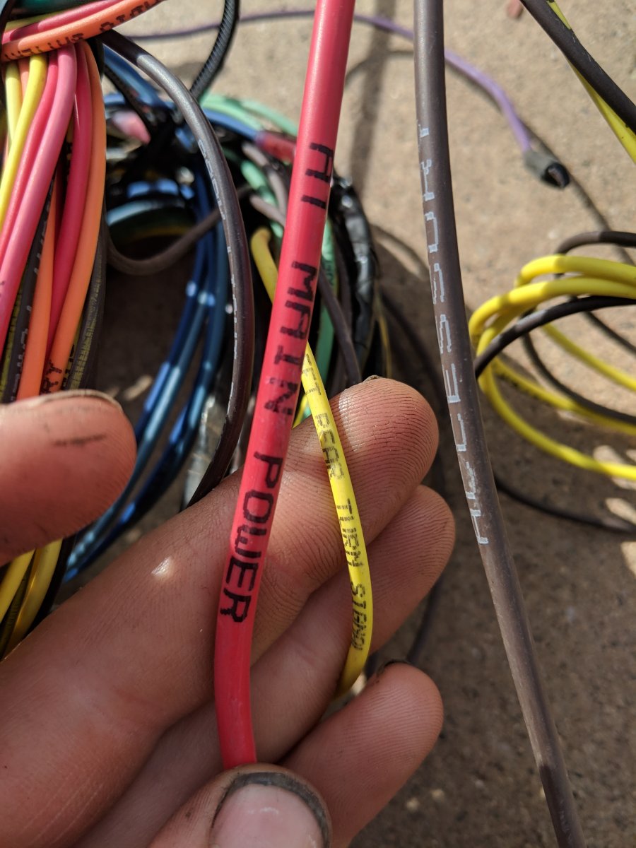

    Ok!! So I have this import cheapo harness in front of me, and also a Haywire Pro T, which is an actual good quality US made harness that is similar in concept.
    I'll start with labelling:
    Here we have the cheap harness
    And here is the name brand:
    The labelling on the cheap one is pretty legible. The printing on the name brand does seem a little better quality, as the cheap one has rubbed off in spots. Another plus of the name brand is the use of white printing on dark colored wire, as apposed to black all around on the other.
    Note that the cheap harness is absolutely NOT color coded as described in the listing, but for your average hot rod I don't think that is crucial. It is worth considering, however.

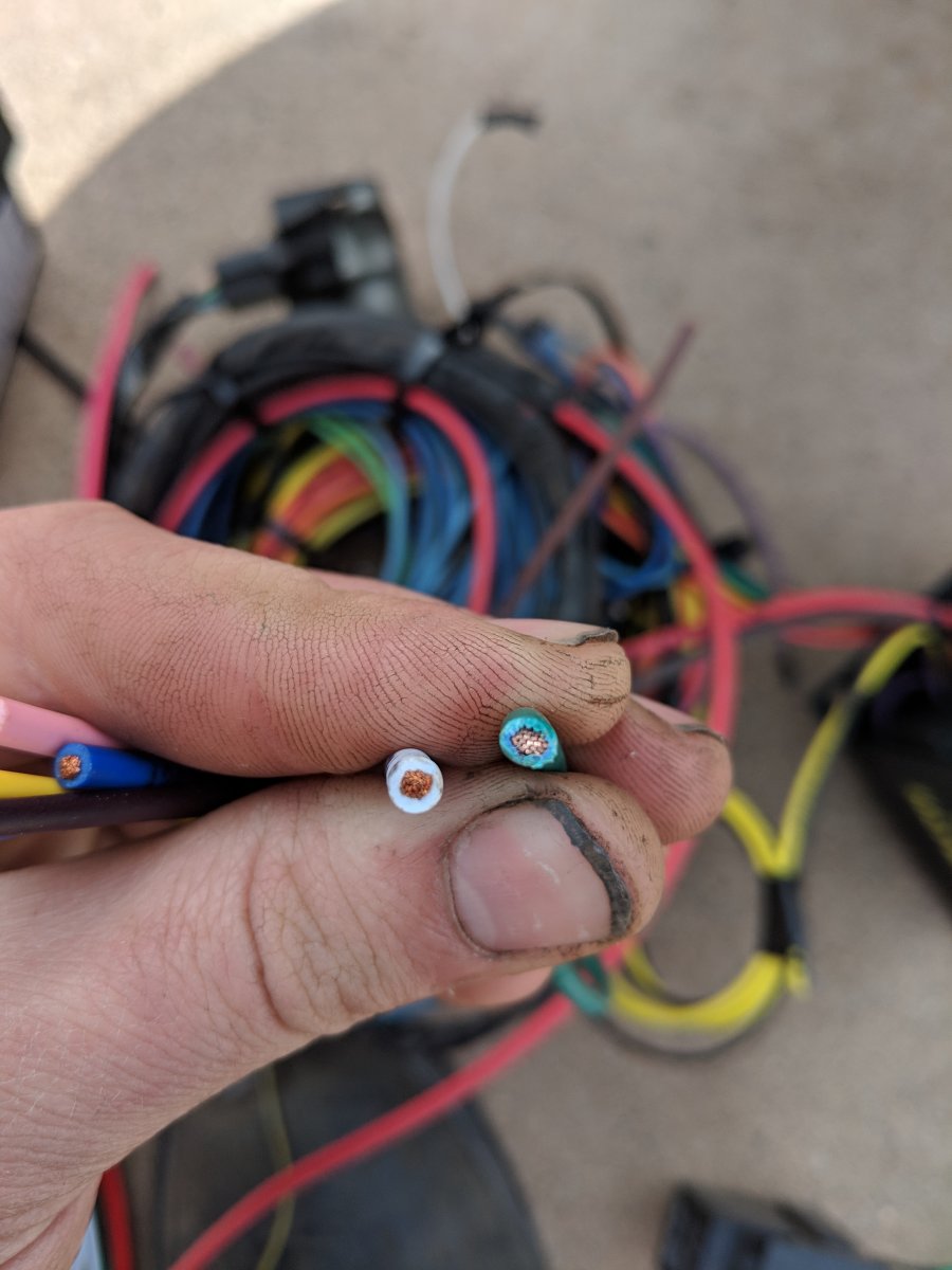

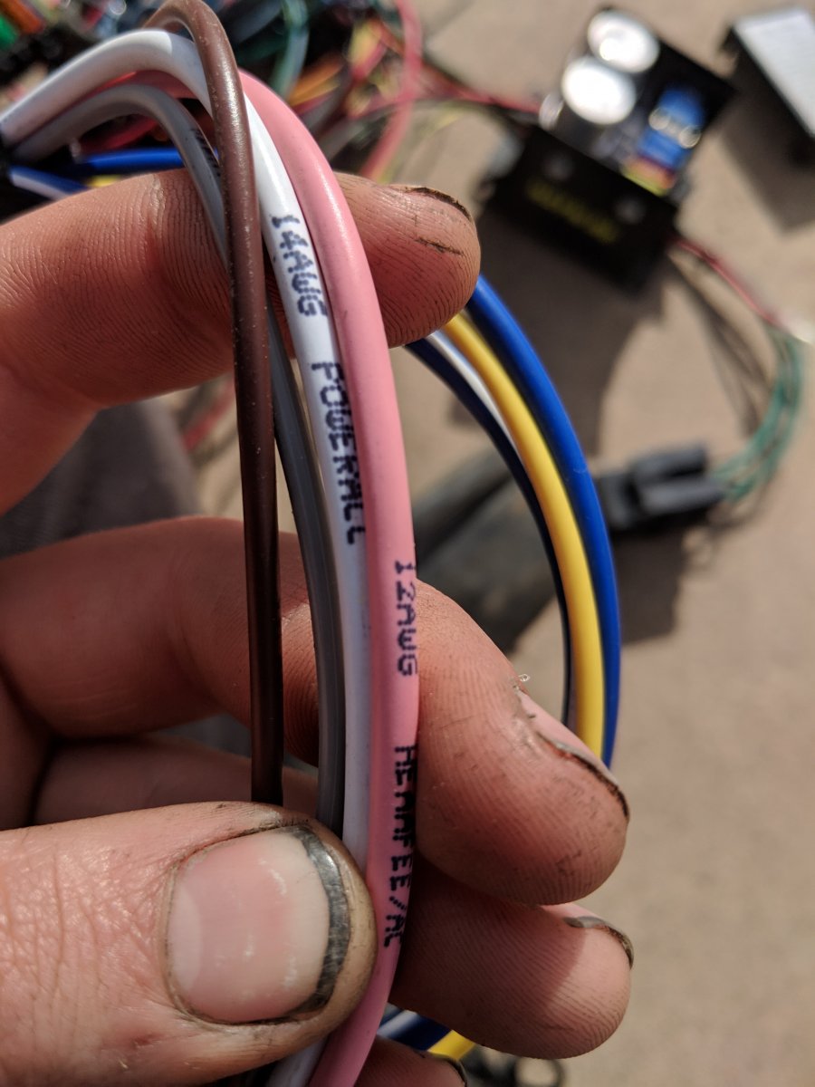

    Wire quality:
    Here is a comparison shot of the main power feed wires. The one with the white inner later is the name brand harness. I believe this to be GXL, while the cheap one is PVC. The actual wire size looks to be a true 10awg, both are solid copper strand, with the cheap one actually being a higher strand count.
    Here is some 12AWG from each kit. White is the cheap stuff, blue is name brand. Same story here, looks true to size, but with a different strand count.

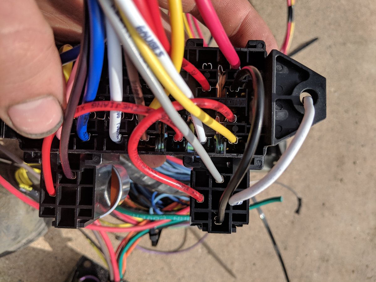

    It took me a little bit to figure out the relay situation, but I finally came to conclusion that it is just there for whatever you want to use it for. It does not supply power to the ignition side if the fuse panel, but rather comes on with the key, being triggered by the keyed power buss in the fuse block and has a power-out that is just labeled as such- "relay out". The fuse panel is wired for constant and ignition power only, with no separate ignition/accessory busses. This would be fine for an old Chevy switch or something like that that doesn't have an accessory position anyways, or run a separate buss for the the ignition side if the switch (I usually only run the coil and gauges on the ignition side anyways).
    All in all, I wouldn't hesitate to use this harness on a project. Yes, more connectors and terminals are needed to complete the install, but for a lot of vintage components that you might reuse, like switches and lights, you can't use what comes in most kits anyways.
