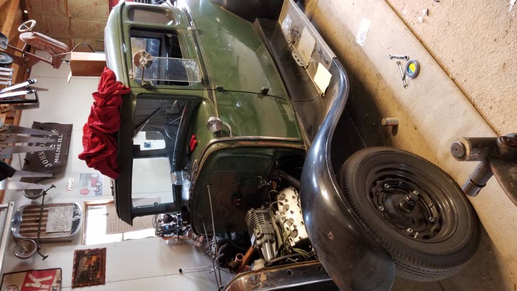

    Cool, that's what I want to do.
    I was worried the blower would not fit in between the head water outlets. I want to run my twin 97s but keep it low and as little poss pokes out the hood 20180313_212537.jpg

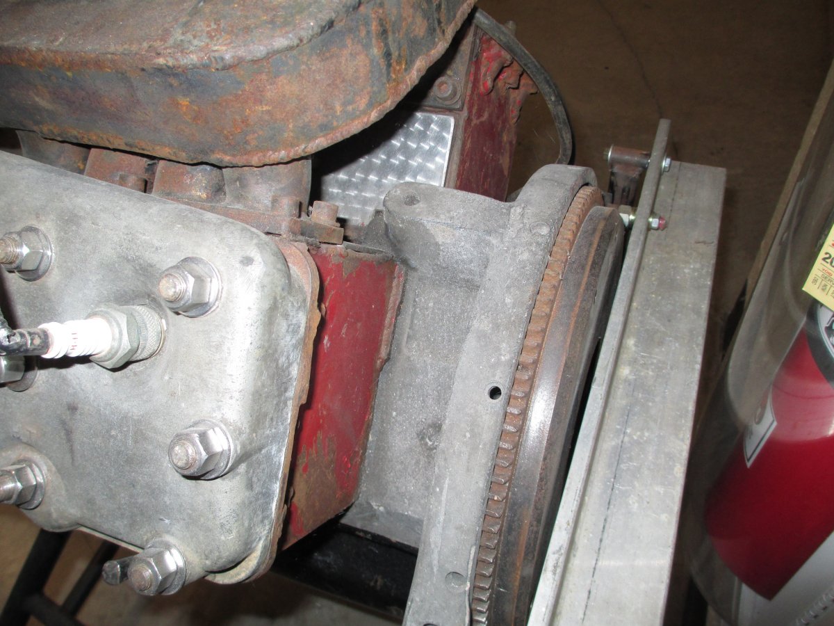

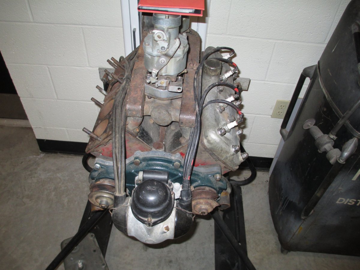

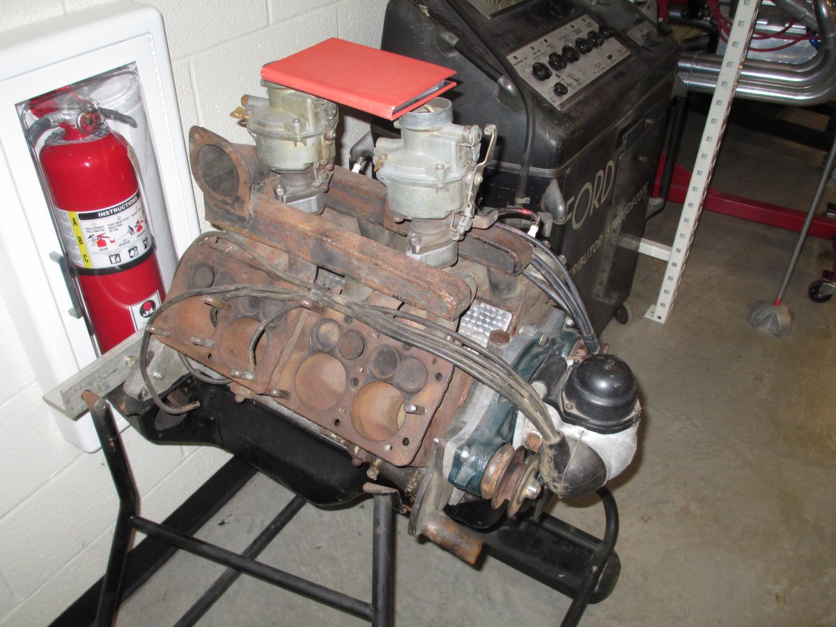

    Took pics of this special v8-60. Casting [four 2cyl blocks] with all ports up top bolted thru to alum crankcase with long head studs, used v8-60 internals. Unusual exhaust header. This engine was at an Automotive museum in PA. It was found in a shed, not known who built it or for what use but it was run hard as crankcase was ventilated ..
