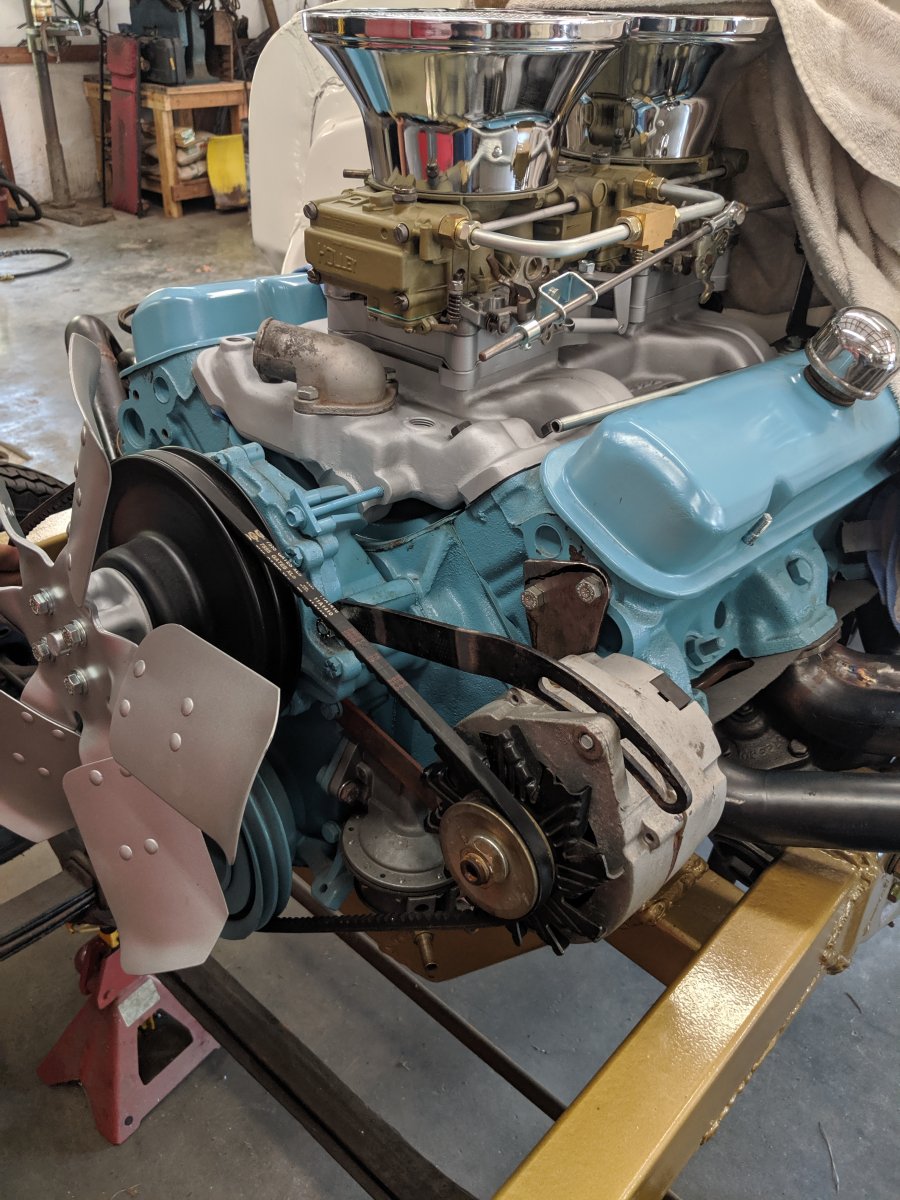

    I've used a small Harbor Freight unit for years. Now, I'm just cleaning as a hobbyist not a mechanic as there are times a small unit won't allow for full immersion and I need to flip the part over. I only note this to note that yes, they work well.
    I did these in a small one.

    Ta hell with dem carbs, what's up with that Pontiac motor? Looks like a savage:eek:
