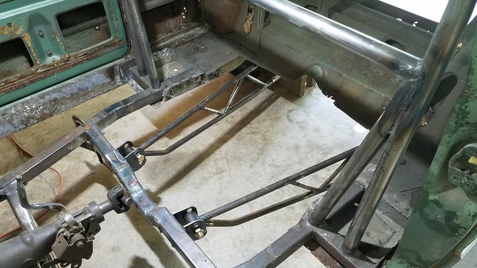

  14. brianf31
    Joined: Aug 11, 2003
    Posts: 1,050
    brianf31
    I'll run angled ladder bars with bushings to help with articulation on my street/strip build. Oh, and housing floaters with leaf springs.

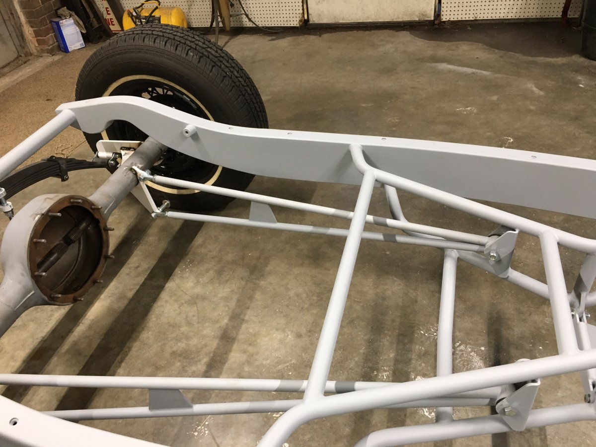

  15. Marty Strode
    Joined: Apr 28, 2011
    Posts: 9,762
    Marty Strode
    Built these out of 4130 Chromoly, .058 wall, light and strong. IMG_4616.JPG IMG_4683.JPG

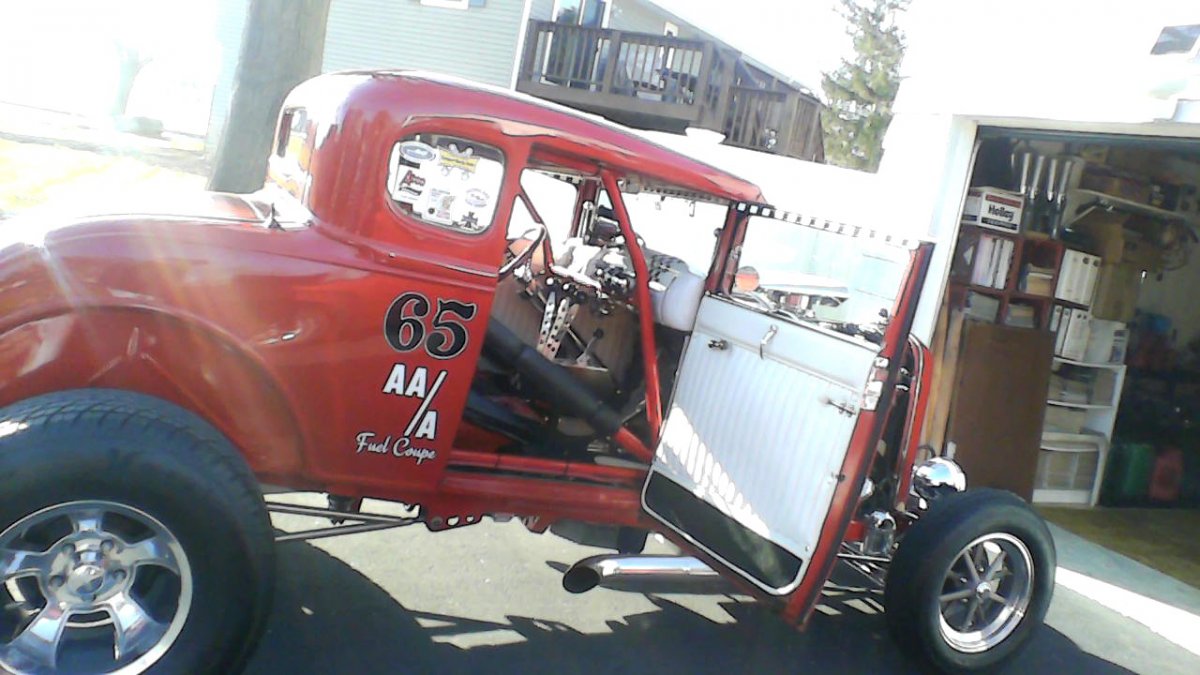

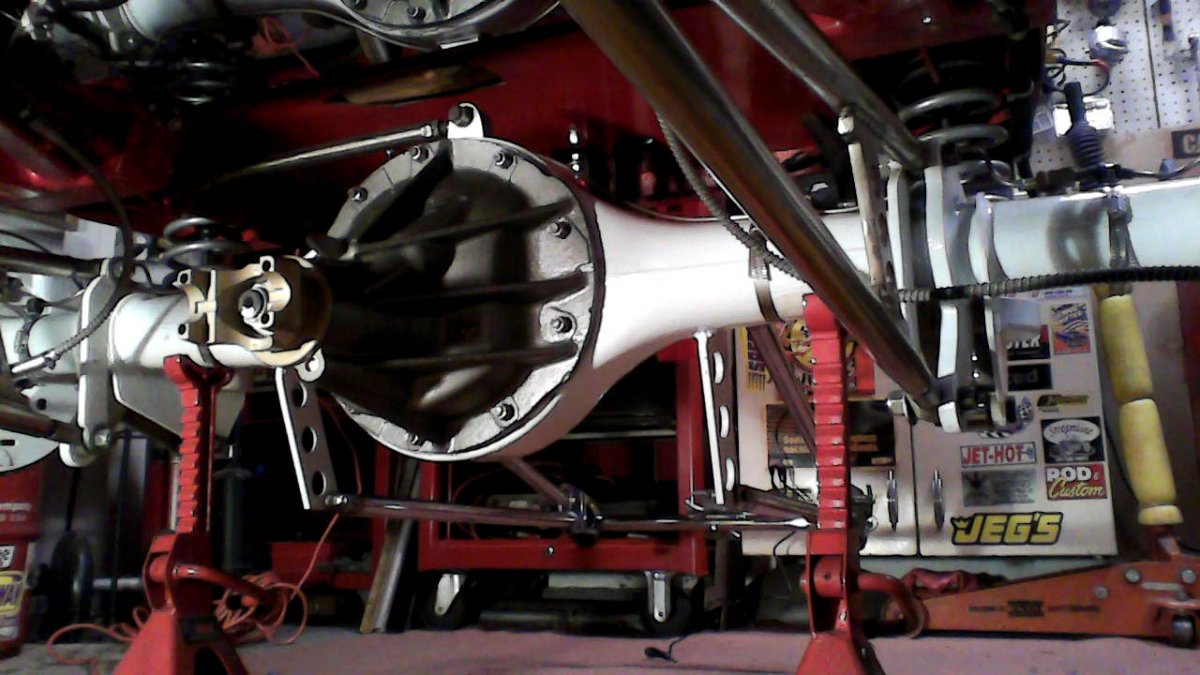

  29. mad mikey
    Joined: Dec 22, 2013
    Posts: 9,532
    mad mikey
    I have ladder bars. Been on the coupe since the 60's. Works great on the track and good on the street. Car launches like a tiger with it's *** on fire. WIN_20180318_12_53_50_Pro.jpg WIN_20190406_17_39_35_Pro.jpg
