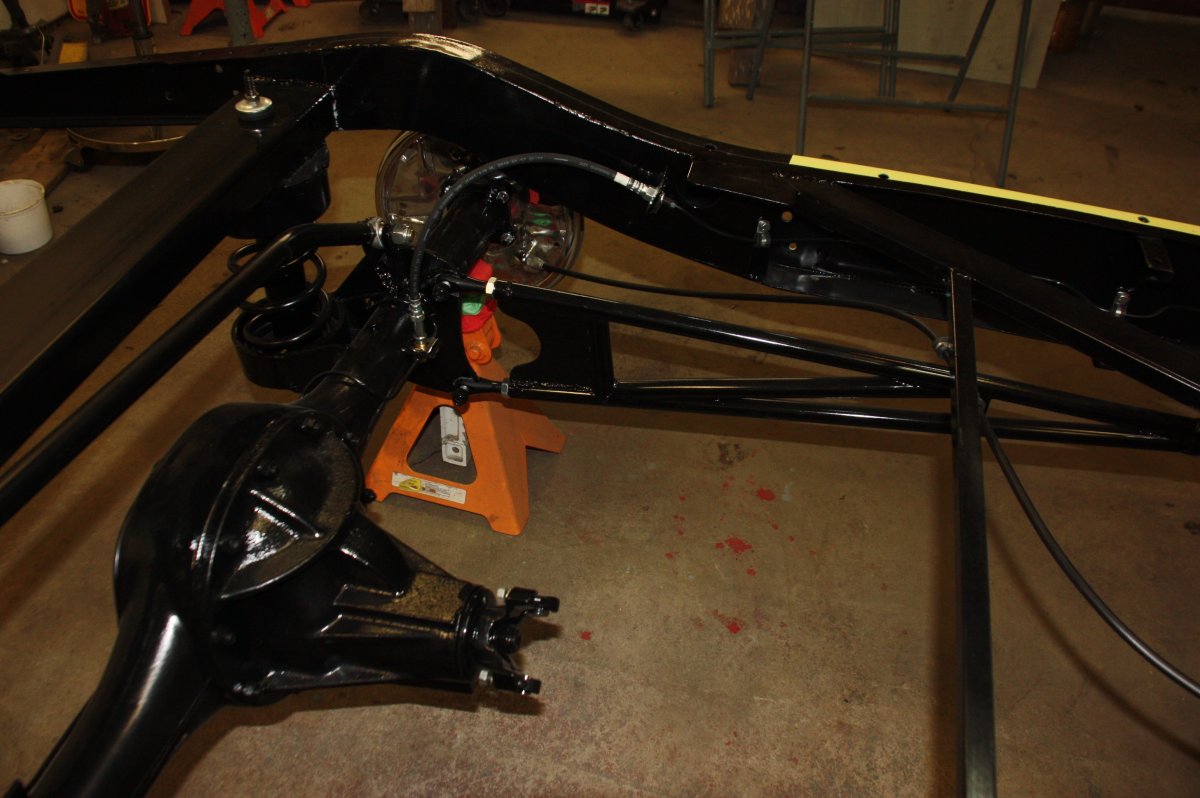

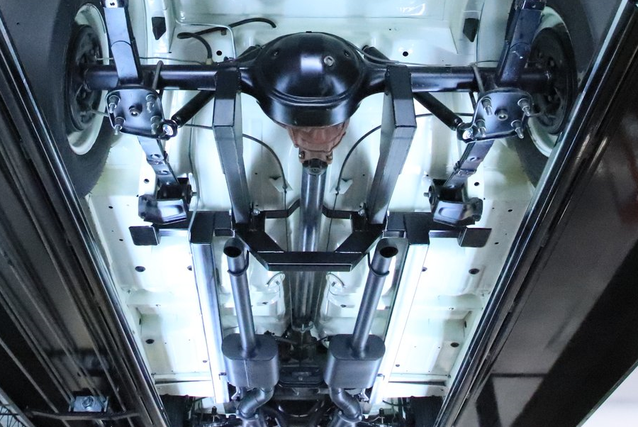

    I have used P and J type ladder bars on numerous vehicles. the longer the bar the less chance of bind on tight turn, uneven terrain...going up steep driveways. triangulated 4 bar seems to have taken on a real following.. no need for a panhard/tracking bar and pretty easy to install..Put these P and J bars on my latest build 33 chassis

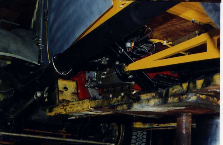

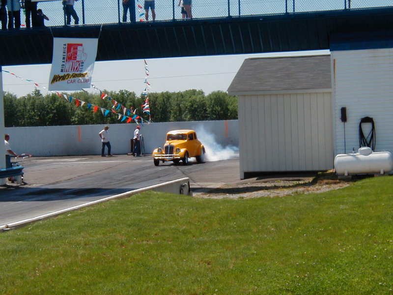

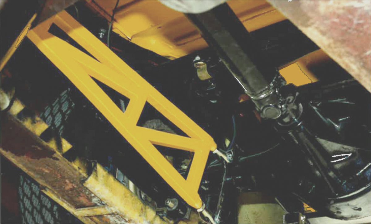

    My '33 Willys
    - ladder bars with Heim ends in double shear
    - coil overs
    - Watts linkage
    - 4-pinion posi 9"
    Launches like JackTheBear. The best setup on the street for stoplite-to-stoplite.

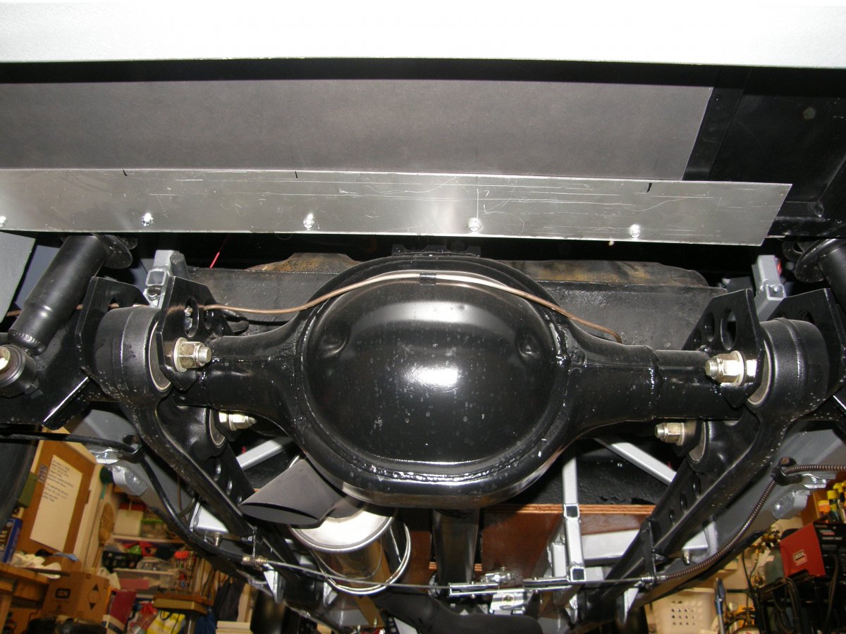

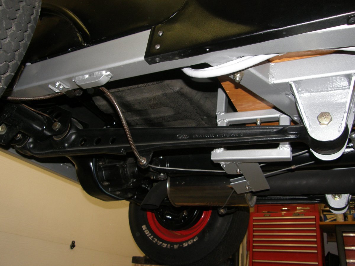

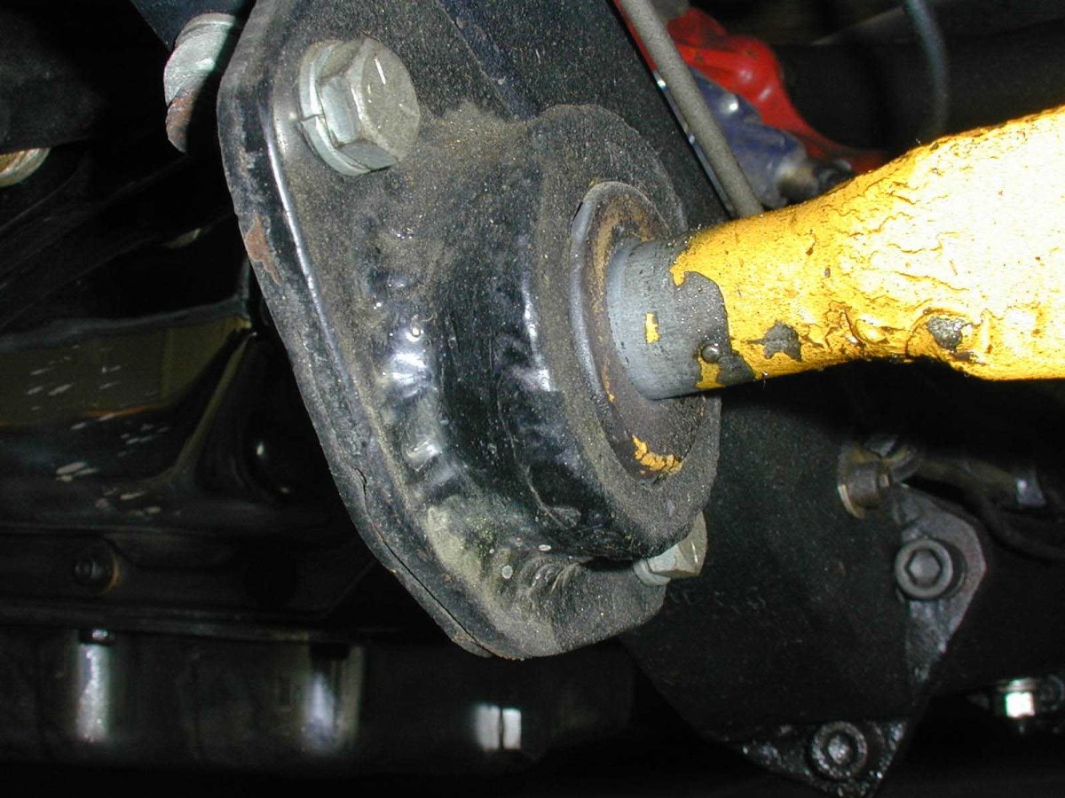

    I run them on my Willys. I made a front mount using Mustang II strut rod donuts to allow for leaf spring movement.
